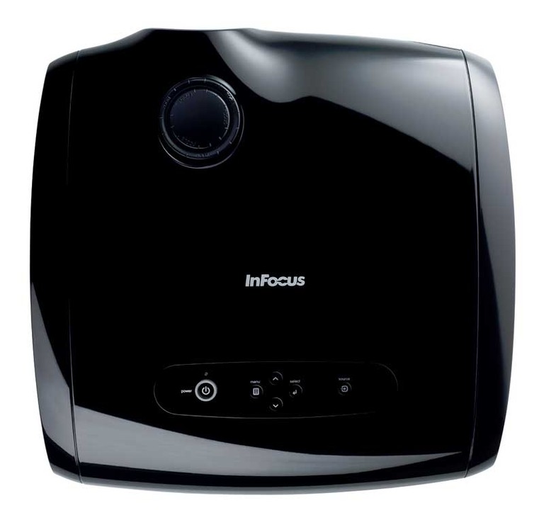

InFocus IN76 Play Big DLP Projector

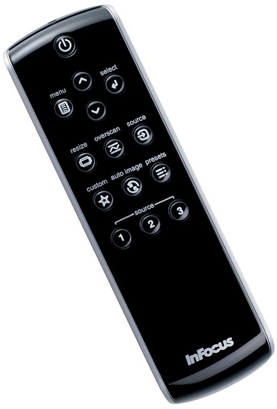

IN76 remote control First, a few words about the new 1280 x 768 DLP chip that Texas Instruments is supplying for the IN76 and other lower priced HD DLP projectors like the Optoma HD72 and Mitsubishi HC3000. This new chip was designed by TI as an inexpensive hybrid chip that is compatible with both high definition video display and computer desktop display. By turning off either 48 pixels in the vertical dimension or 256 pixels in the horizontal dimension, the projector manufacturer is able to hit their desired resolution of either 1280 x 720 (HD) or 1024 x 768 (computer/business applications), respectively. This is a clever cost saving measure in that only one run of DLP chips can supply both markets: home theater or business projectors. Not only that, additional cost savings are obtained in making the chips physically smaller, which allows for greater production yields. Now, this is important when it comes to home theater applications 舑 while this new chip is capable of high performance, it is NOT designed to compete with the higher end standard size Dark Chip 2 or Dark Chip 3 DLP chips used in projectors like the Sharp ZXV2000 and InFocus SP7205 (Dark Chip 2) or Optoma H-79, BenQ PE8720, and InFocus SP 7210 (Dark Chip 3). First of all, the chip is physically smaller, which translates into lower brightness and more "screen door effect" (visible pixels) due to the lower fill factor.

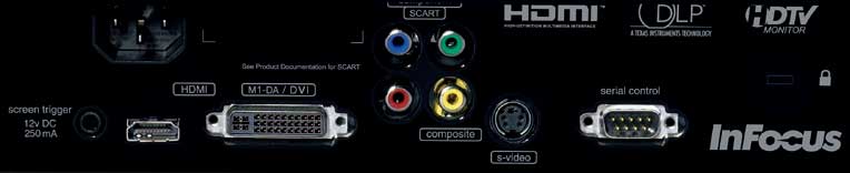

Connections
The big news here is that InFocus has finally added a true HDMI connector, so no adapters are needed for those who have an HDMI equipped DVD player, satellite receiver, or cable box. Those familiar with the old InFocus DVI hybrid, the M1DA connector, will be pleased to see that it has returned as well. This is a good thing in more ways than one, since it means that the IN76 effectively has two HDMI/DVI inputs (for those not familiar, M1DA is totally adaptable to and compatible with HDMI and DVI). As an added bonus, the M1DA port allows user firmware updates that registered owners can download from InFocus' web site.
IN76 inputs
In addition to the HDMI and M1DA inputs the IN76 has component, s-video, and composite video connectors, making it compatible with just about any video source you want to throw at it. InFocus has also thoughtfully added a serial control port and a 12 volt trigger.

On first powering up the IN76, two things were obvious. First, InFocus has replaced their old boring standard blue logo splash screen with a new one that reflects the new color scheme seen in all their advertising - a rich conglomeration of reds, yellows, and oranges. Pretty striking when you turn it on! Secondly - and obviously, far more importantly - is how quiet this new design is. One of the few legitimate complaints leveled against the previous line of InFocus Screenplay projectors was the acoustic noise level created by the cooling fans, especially if they cycled up and down. This new design is MUCH quieter, and what noise that remains is of the soft, almost soothing "rushing air" variety. The only projectors that we have evaluated that are quieter are some of the three chip DLP designs (due to their lack of color wheel) and the Optoma H-79 (which sacrifices some high altitude capability as a result, since less air is moving to cool the projector bulb).

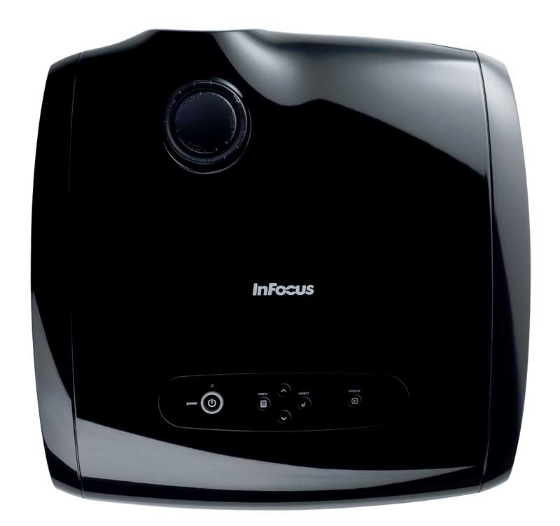

The InFocus IN76 is a medium throw projector. For example, for a 100 舡 diagonal screen, the projector needs to be mounted between 11 to 14 feet back from the screen wall. InFocus provides a screen calculator for anyone wanting to try various screen size and projector combinations.
Another important mounting consideration to keep in mind 舑 the IN76 has a fixed lens offset, meaning that the projector needs be placed at a specific height in relation to the screen. Using the above 100 舡 screen as a reference, the IN76 would need to be mounted with the lens approximately 7.5 inches ABOVE the top of the picture area of the screen. Some other projector manufacturers (such as Panasonic and Sanyo) utilize a lens shift feature, which allows the image to be adjusted up and down by using either a manual or electronic control on the projector. Although many people feel that having lens shift is preferable, we respectfully disagree. With almost all lens shift projectors, the lens can be NO HIGHER than the top of the screen. That usually means a long extension pole down from the ceiling to the top of the projector and the projector hanging down a foot or two into the room. Projectors with lens offset, on the other hand, are designed to be placed higher than the top of screen. In most installations that means the projector can be mounted flush with the ceiling, up and out of the way. The only time this becomes a problem is if there is a soffit or low hanging light fixture between the projector and screen, in which case lens shift offers more flexibility
