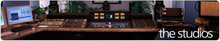

Mastering Board

“The console in my studio is made by Sound Performance Laboratories in Germany. It is ultra state-of-the-art analog electronics with 124 volt DC rails. I use the custom designed Eggleston Works “Ivy” speaker. (www.egglestonworks.com/ivy.htm)
I have serial #’s 1 & 2. The speaker’s designer William Eggleston III and I hand-tweaked the crossovers in my room. To my knowledge, there is no other pair of these speakers in the world exactly like mine as William Eggleston left his company (he has since started another speaker company (www.wegg3.com). The 790 lb. speaker is unique in that it is designed with the isobaric theory of creating equal pressure on the speaker whether going in or outwards. There are 23 drivers in the speaker. 3 woofers face the listener with 2 interior woofers behind each of them. They are simply extraordinary. They are powered by a bridged pair of Cello Performance Mark II high current amplifiers capable of putting out >4,000 Watt RMS signals into 2 ohms. The interconnects and of course the speaker cables are the incomparable Transparent Cable Opus MM. In my opinion, Transparent achieved such a technological breakthrough with this design that we re-wired my entire studio a few summers ago with brand new Transparent cable after starting out with their cables 14 years ago when we built the studio. The system is an utter joy to hear, and I look forward to it every day!
