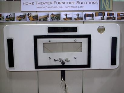

Here is a simple solution for mounting a large
front panel display on your apartment wall.
The picture below is a mounting system for a large flat panel display like a plasma. There is a place to mount your left and right speakers and your center channel. It also incorporates cable management. The installation is easy and straightforward. A cleat is attached to the wall studs in your room. The mounting system is then lifted into place and hangs on the cleat. When its time to remove the mounting system all you have to do is fill in the small screw holes in the sheetrock where the cleat was installed. This is no bigger than the average hole left by a screw holding a picture. All the cabling required for the plasma and speakers get installed in the provided raceway. The mount is available in several finishes or can be ordered unfinished and ready to paint.
