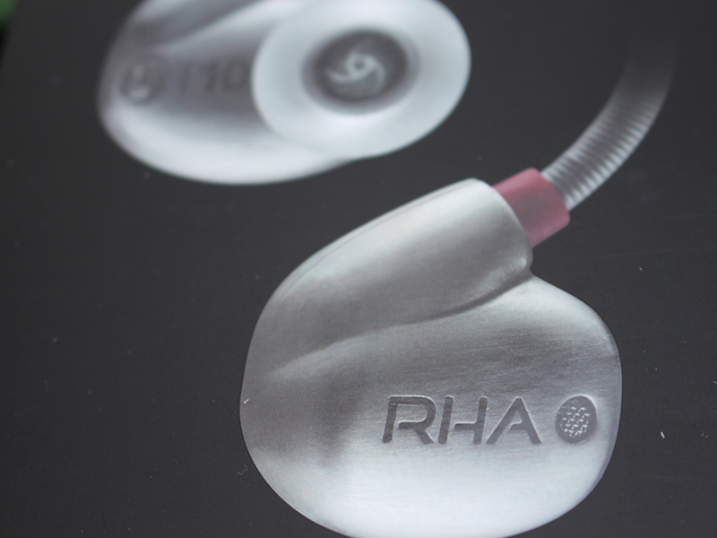

Reid Heath Acoustics, better known as RHA, have impressed many with their fantastic product line-up. From their well-built MA600 to the more established MA750 (i), they have captured early audiophile interest through attention to detail and exceptional build quality.
Following on from this theme, RHA have gone on to launch the well-anticipated T10/T10i model featuring a completely new single dynamic driver. The driver is said to produce high levels of accuracy and detail across all genres of music while still retaining great levels of noise isolation and a customizable sound signature. This comes in the form of three small interchangeable filters which alter the sound tuning of the T10s to suit the user’s tastes.
In terms of the manufacturing process, RHA have opted for metal injection molding which is a process where fine powder is mixed with rha6resin and binder material before being heated to very high temperatures. This is a clever processing tool which has also been used in other IEMs such as the Final Audio Heaven VIII to enable better levels of precision and optimal durability in the construction of housing material for the sound components of the IEM. Like the Heaven VIIIs, the T10s boast the use of stainless steel for robustness that consumers cannot fault. Lewis Heath, product director at RHA, says that this has only been possible with RHA’s pioneering technologies and large investment in R&D which has progressed the company to a completely new playing field.
Though the T10 has a lot going for it with regards to the wealth of features seamlessly built in, RHA have kept the price at $189.95 which I feel is fair and great value considering the manufacturing process, build and levels of customizability. The T10i counterpart, however, can be bought for an extra $10 which includes a microphone and an in-line 3 button remote.

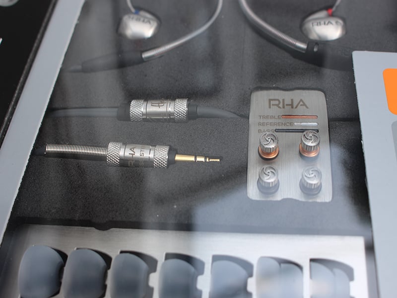

The Filter System
One of the major selling points of the RHA T10/T10i are the new filters which enable the user to customize sound to their own preferences. Now this concept is not exactly new and has been done before with a few high-end IEMs such as the AKG K3003s, Shure SE846s, Earsonics Velvets and now RHA who have implemented the system incredibly well on top of the T10s’ already strong skill sets. Luckily for RHA, they have made this part of the user experience very intuitive and screwing the filters onto the earphone nozzle only takes a matter of seconds which is handy for quick A/B comparisons. As per standard, the filters offer a bass, reference and treble sound tuning which allows users to adjust the IEMs to their own requirements. Through implementation, there is a considerable change in sound character which is a step in the positive direction for an IEM hoping to deliver versatility.

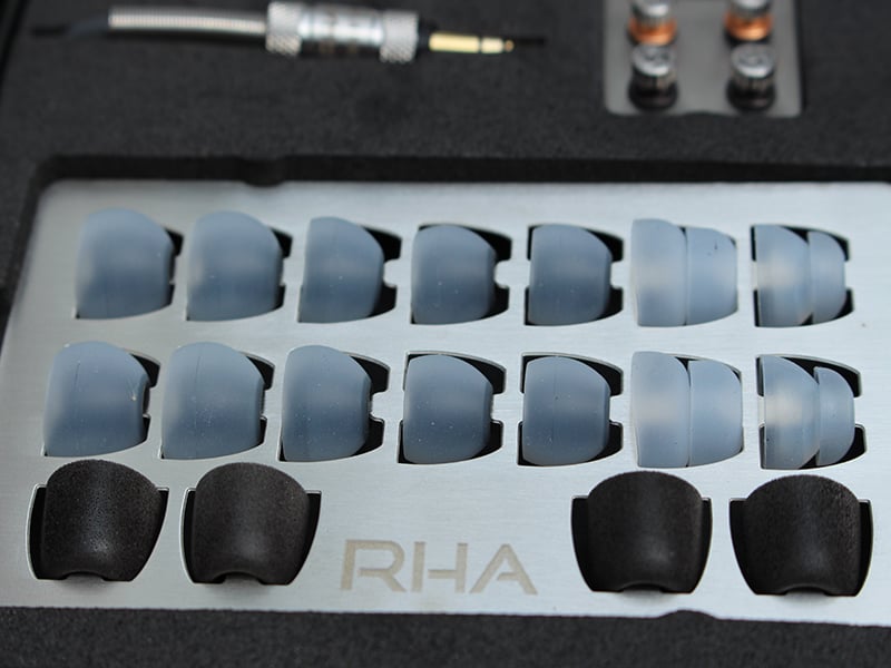

I feel like RHA have taken cues from Apple with their packaging which isn’t all too surprising seeing as RHA products sell in Apple stores. Their box includes interchangeable filters with one pair fitted into the earphones by default. Accessories include 6 pairs of dual density ear tips (in small, medium and large), 2 pairs of double flange tips (in small and medium) and 2 pairs of memory foam tips. I have never seen a more elegantly designed eartips holder with RHA storing all accessories in a sleek brushed stainless steel plate. Even the filters are rested on a stainless steel plate which enhances the overall packaging and high quality that RHA are known for.\

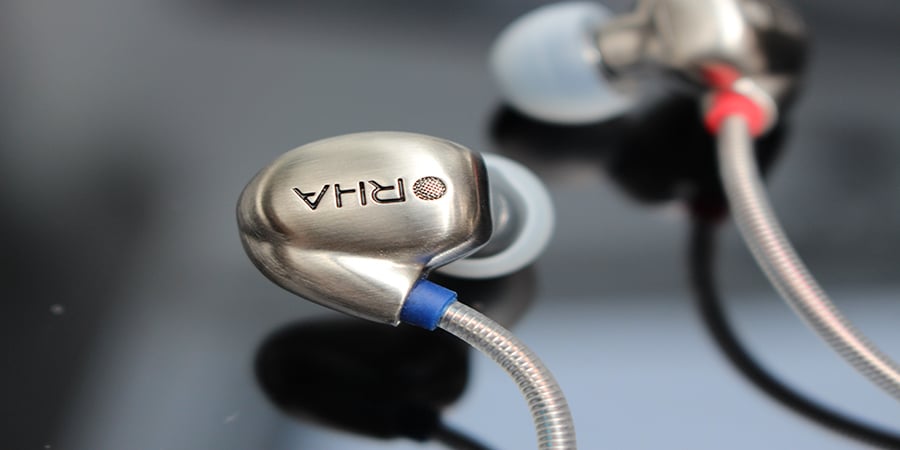

Build Quality & Fit
As mentioned before, RHA have invested a lot of resources to make a well built and durable piece which has undoubtedly won over the masses. Thrha3ey are so confident in their own build, in fact, that RHA have issued a 3 year warranty for any consumer in the unlikely position of developing a fault within the T10/T10i units. The earphones themselves come in a stainless steel finish with a metal cord forming the moldable ear-hook. Coming off each hook is a thick rubbery cord which meets at a sturdy metal cylindrical Y-split. Oddly now, RHA have opted for a straight jack which in concept is not as durable as an L-shaped jack or even an angled jack but RHA being RHA have thought of a way of overcoming this; they have implemented a spring to prevent torsional strain and further increase durability.
With regards to fit, the earphones do feel a bit weighty in the ear which is obviously to be expected from a metal design. However, they provide comfort and can be listened to for prolonged periods of time which is all that is necessary for a decently fitted IEM. An area of improvement, though, could be the ear-hooks which should be more malleable to prevent the cable from becoming too loose after exiting the back of the ear. Overall, RHA have provided a solid listening experience which by no means detracts from the music they provide.
