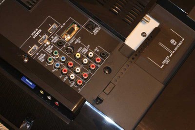

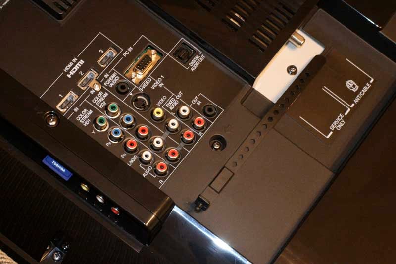

There are several locations where the display's inputs are to be found:
On the rear we have three rear-facing HDMI inputs, an optical TOSlink output, RF antenna input, an HD15 PC input and ample analogue audio connections.
On the side, Toshiba's 46SV670U has an additional HDMI input, a USB input, SD card, and composite inputs, This is also where the hard controls are for channel, menu and input controls.

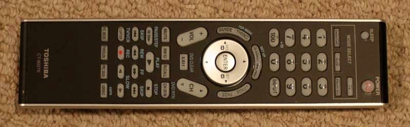

Toshiba's remote is large, well laid out and not backlit in the least. In fact, the only thing that lights up is the source selection whenever you push a button (or select the source). Why they included a backlight there and not for the rest of the remote will remain one of life's great (OK, not that great) mysteries. The remote is separated onto three main sections: Source and keypad, menu navigation, and transport controls. Other than the lack of a backlight and no direct input buttons, the remote is actually quite ergonomic and easy to use. I liked the Menu controls and, though the CH Return button as a "back out of the menu" button was an odd choice, it kinda grew on me. The only way to select an input on the Toshiba remote is to either toggle the solitary Input button or press it once and use the menu selector to choose an input. The remote is able to control up to 3 additional devices (Cable/Sat, DVD, and VCR/PVR) which is a big plus for those looking to simplify control over their A/V systems.

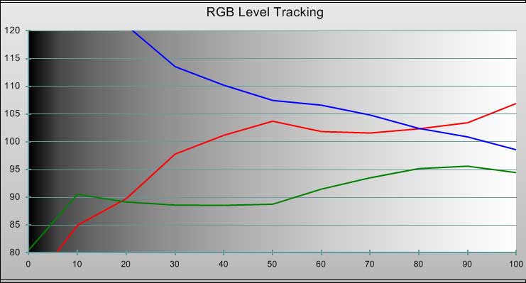

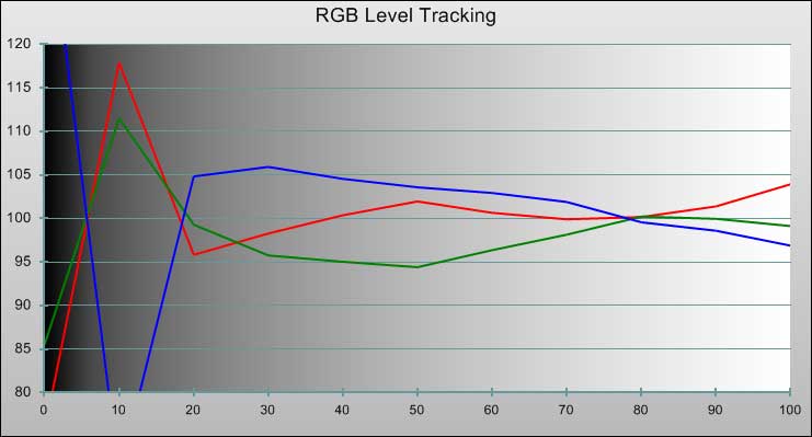

We utilized SpecraCal's CalMan software (v3.5) and an X-Rite Chroma 5 meter. This is a great combination for reviewing LCD flat panel TVs and the Chroma 5 is now available in a form that is ready for LED backlit televisions. The Toshiba REGZA 46SV670U is remarkably flexible in its user calibration menu. Aside from its full RGB Gain and Cut controls, the TV also provides "ColorMaster" controls which allow adjustment of Hue Saturation and Brightness of each primary and secondary color. Our initial measurements showed runaway Blue levels and a very disjointed RGB grayscale response, which matched our initial impressions of the picture, even in Movie mode:
Afterwards, we were able to make significant improvements with some grayscale calibration:
The above results were calibrated starting at the Movie Mode with a Color Temperature 2 setting.

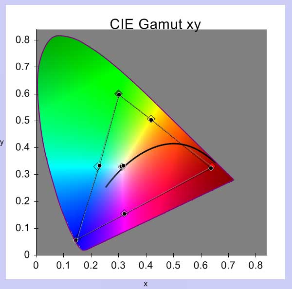

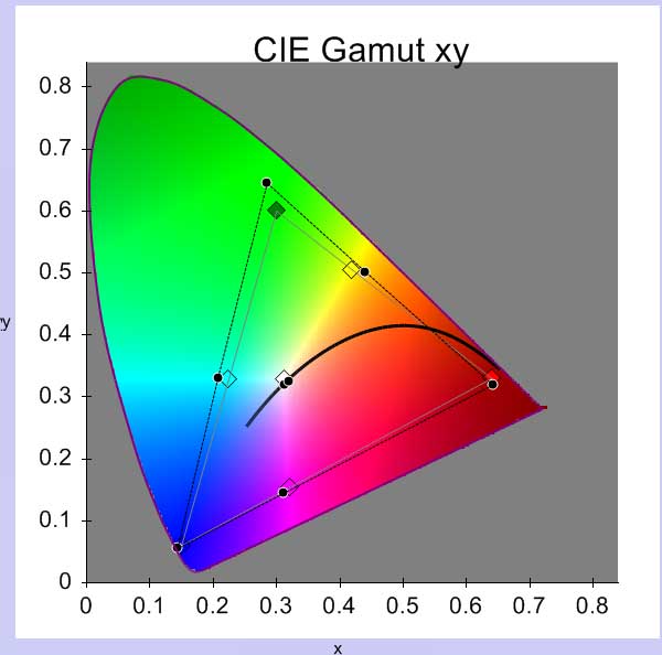

Color accuracy as measured by the CIE chart placed the color ranges outside of the desired Rec 709 boundaries (particularly Green). We adjusted the ColorMaster controls to alter the Hue Saturation and Brightness of the primary and secondary colors to dial in the display almost spot on.
CIE chart before (left) and after (right)

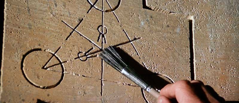

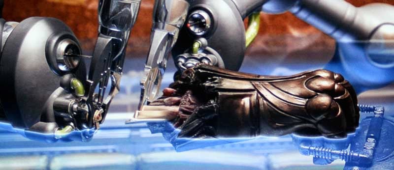

BD: The Fifth Element (Revised Version)
I use this on just about every display review for good reason – it's an excellent source and I am intimately familiar with the material. On the Toshiba REGZA 46SV670U LED backlit display the colors really seemed to pop. Detail was good, though we've seen sharper images on other sets from our reference sources. Overall, this disc showed that the REGZA is capable of playing back rich, detailed material in a very pleasing way.
All the detail of this brush and the texture of the wall came though, and the colors of the reconstitution scene were absolutely stunning post-calibration.

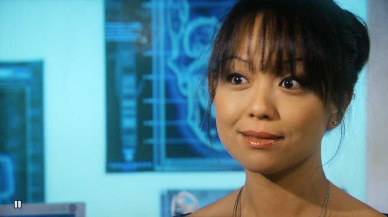

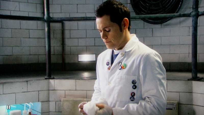

BD: Torchwood – Season 2
Black levels are good, but what about Black levels when there are ample amounts of white in the frame? For this we turned to Torchwood: Season 2, which always delivers on deep shadows and contrasting foreground elements. In one of the scenes we captured, the background detail has very dark elements that are contrasted by Owen Harper (played by Burn Gorman) who is wearing a standard white lab coat. Here, the FocaLight LED backlighting system was able to darken the background elements, while allowing the peak white in his lab coat to punch through as much as is proper. It resulted in a nicely contrasted image that I hadn't seen on any CCFL-backlit LCD displays.

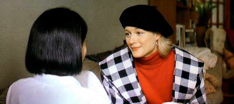

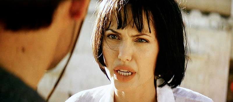

DVD: Beyond Borders
This movie presented a lot of material for us to look at. In one scene a character comes into frame with a checkerboard pattern in her coat. The fine lines which made up the pattern were a nice real-world challenge for this set. Skin tones were all over the board due to the nature of this film and its remote location and setting, however we found the facial detail to be superb (especially for DVD) and enjoyed the contrast given by, for example, dark hair on light backgrounds and scenery that combined many different elements.
