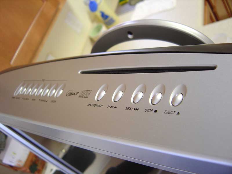

Axion AXN-7200 LCD slot loadingRemember those cheesy 50's television shows & commercials that depicted the household of the future? You know, the ones with bubble TVs, bubble sofas, and bubble cars (if you're having trouble picturing this, just visit an Ikea store.) Even the Jetsons didn't present such a hokey picture of the 21st century. While you have these picturesque visions of the future in mind, let's think about a more realistic - and truly contemporary - version of what a television could be. The AXN-7200, with its top-side slot-loading DVD player and curved display stand, presents what I feel is a forward-thinking "next stage" design for televisions - without reaching too far ahead or appearing completely out of place. This next-generation design is only compromised by a rather disappointing level of performance (both functionally as well as visually) that we hope Axion will eventually remedy.
