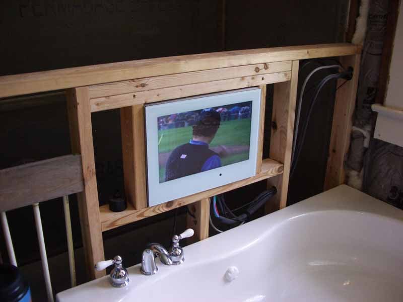

OK, before you start thinking about cabling you'll need to frame in the included backbox. Getting this right will make sure your installation goes smoothly and with no hiccups. We ended up installing this product in to Tim, my brother-in-law's bathroom remodel. The location was the knee-wall that separated the new Jacuzzi tub from the walk-in shower stall. It was imperative that we do a thorough installation since the television would be susceptible, not only to steam and indirect moisture, but also from direct splashing at the tub level.
We started with the rough framing. The backbox to the Aquaview TV is roughly 0.25" wider and taller than the television itself. You can take an accurate measurement yourself before framing out the structure into which the backbox will be mounted. Don't forget to allow yourself room to cut holes for running the audio and video supply cables to the television. We drilled two 1-inch holes so that we could separate power and the wired remote control from the video feeds (always a good idea). If you notice, we also made sure to have a "double wall" between any water supply lines and the backbox. Just because the front of the Aquaview is waterproof once installed, doesn't mean the rear of the unit can handle incidental water seepage - and we didn’t want to take any chances. The end result was a well-structured wall that framed out a perfect spot for our 17-inch widescreen waterproof television.
The next step would be to rough-in the backbox - remembering to keep the screws loose for later fine-tuning (there are horizontal slots on the sides of the backbox which allow you to move the unit in and out as need to match your finished tile depth. At this point, go ahead and run your wires and be sure to leave enough extra in the backbox so that you can remove and service the television, but obviously not so much that you can't fit everything into the backbox.
Once everything was in place, we decided to do a short "test run" of the system. The last thing we wanted was to cover everything up only to discover some cabling or other problem that could no longer be effectively remedied. I would recommend this with any install, and it was fun to watch my brother-in-law Tim catching the game on a Saturday afternoon as we took a brief break from working on the room. If you are putting the Aquaview TV into a knee wall as we were doing be sure to have enough stability on the wall (typically in the form of cross-bracing) so that you don't end up with crack in the grout lines from the wall shifting and stressing.
After rough-in you continue on with your work until you have laid in the drywall/hardyboard/durock, applied mastic and tiled over the finished wall. Be sure to tile all the way up to the backbox edge, but allow yourself the ability to remove the backbox should that ever become necessary (without having to rip out the surrounding tile). A nice tight fit will make for a smaller bead of silicone once you are done. After your tiling is completed, and you've grouted your lines, go back and install the television. The television assembly magnetically seals to the backbox, ensuring that the gasket around the set is tight and moisture won't get in. Aquaview recommends (strongly) that you use a glass installation system (suction-cup device) for the final installation to ensure that you don't crack the surrounding glass frame. Once everything is in place, run a bead of silicone around the set and you're all done. If you ever need to access it, simply cut around the unit with a razor knife, remove the set and replace with new silicone. Now THAT'S good product design!

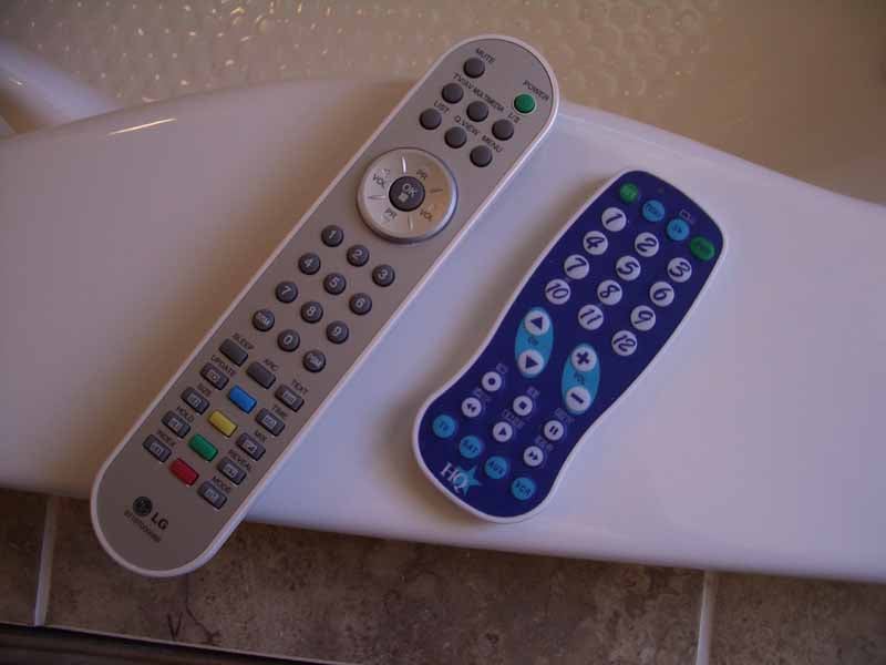

AquaView-remotes.jpgOur Aquaview TV came with a three straightforward remote controls. None of them were particularly impressive. There was an LG-branded remote which had th4e most features, a "waterproof" remote (which we found out was actually just water resistant), and a hard-wired remote that can be installed into the wall.
We decided to test the waterproof remote by dropping it into the tub (OK, actually my nephew dropped it in, but at that point we decided to test it). It was only underwater for a couple of seconds, but it ceased to function and would no longer control the television. We dried it off, removed the battery and reprogrammed it and it continued to function correctly. As a result we've dubbed it more of a water resistant remote, just keep that in mind. The LG-branded remote worked perfectly with no problems.

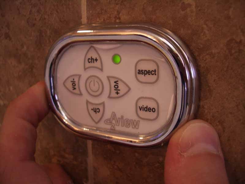

AquaView-hardwire-remote.jpgThe hard-wired remote is a great-looking device, simplistic and elegant. It has a chrome trim around the edge and features a power button (very important), volume and channel buttons. There are also very important aspect and input (video) buttons as well. This is just about everything you need in order to successfully use the TV and keeps you from having to have a remote control around that you could lose or misplace (or drop in the tub!) Aquaview also has a float remote that is completely waterproof (we didn't review this one) so if you dream of reaching in the water for the remote you have an option for that too.
Volume control and channel selection are navigated via the ergonomically-located center 4-way switch. The enter button is positioned in the center and nothing could be simpler. A direct-access number pad is provided as are buttons to cycle through the available audio and video modes.

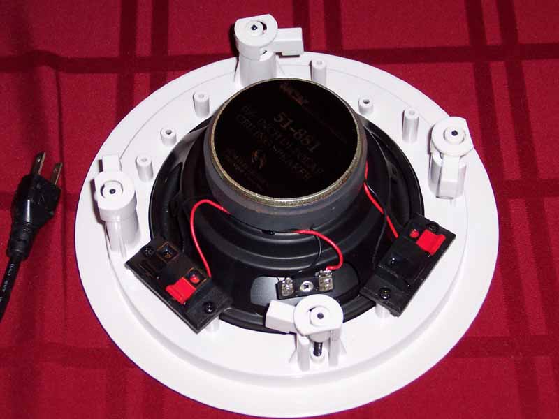

AquaView-stereo-speaker.jpgIf you take a close look at the speaker you'll note that it has two sets of inputs. This is because it is a single woofer, dual tweeter design that allows for a "stereo" image to be sent from one enclosure. The idea is not new and does a decent job of allowing left and right information to be sent into close quarters (as is common with bathrooms). We found the speaker to be sufficiently loud for the bathroom and it didn't distort until you maxed out the volume (at which point it was a bit too loud for our room). If you have a cavernous bathroom you may want to opt for getting separate speakers to separate the audio sources.

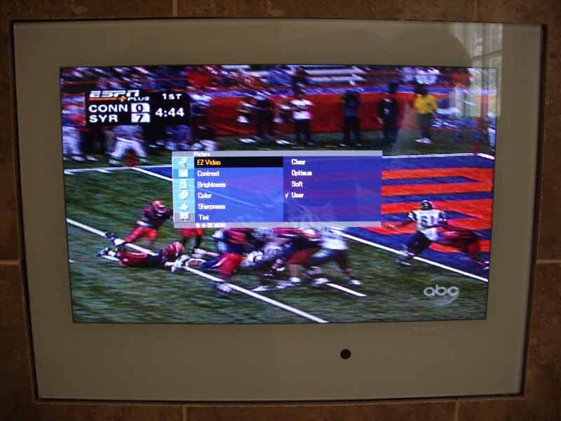

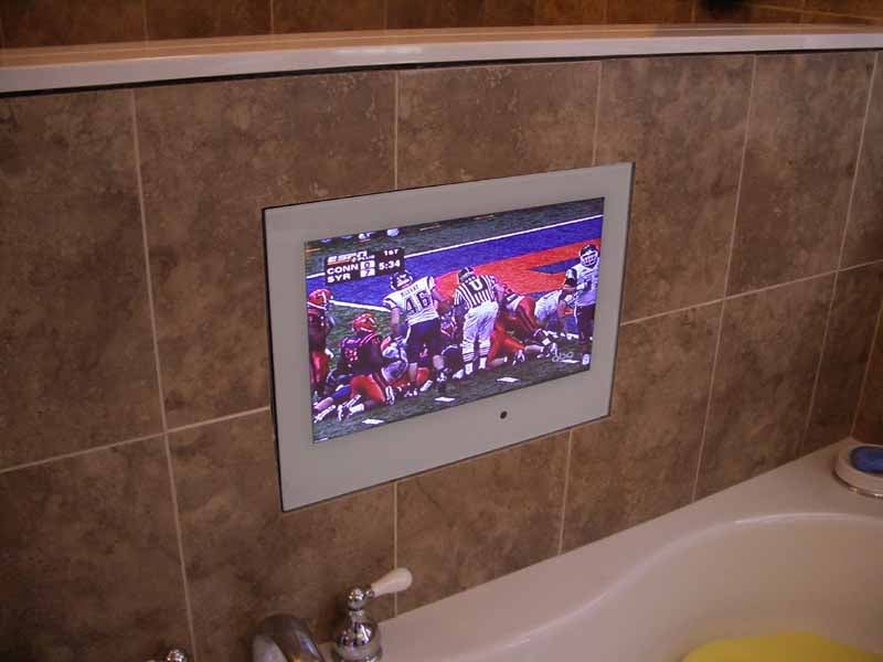

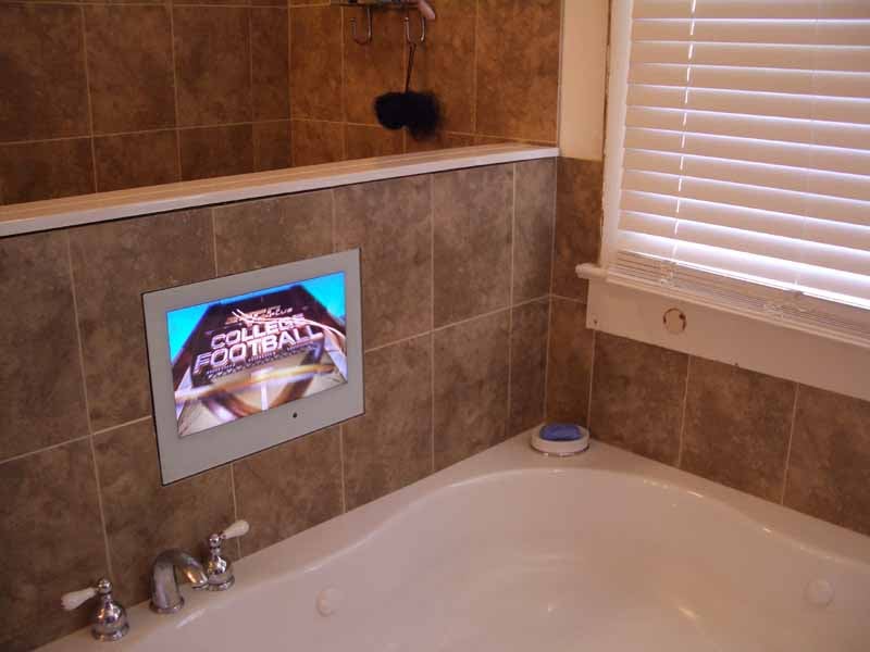

TV: College FootballAquaView-final-football.jpg
We checked out a lot of program material on this set, but decided to start with some College Football (hey, we were working on a Saturday!) The image was clear and clean - but to be honest, this is what we expected for a 17-inch widescreen LCD display. I noticed no problem with blurring, though this certainly wasn't a high-performance display as noted by its lack of advanced calibration options or features. What was impressive was its brightness. You can really get the unit to show a nice, vivid picture even with all the lights on (as shown here in the photo). One thing we did notice was the potential for glare as the screen is polished and somewhat reflective - welcome to just about all flat panel displays. To say that this picture would be enjoyable while taking a nice bath is an understatement - this is simply a very cool product and our actual use of it allowed the mental picture we had to be fully realized.
We viewed other TV material as well and were very pleased at the results. This is a nice display and the picture was always clear and bright:

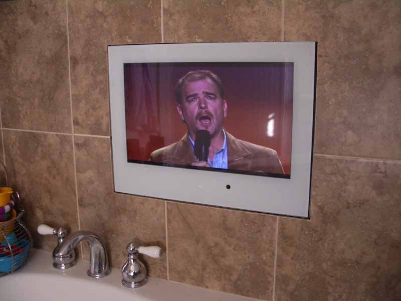

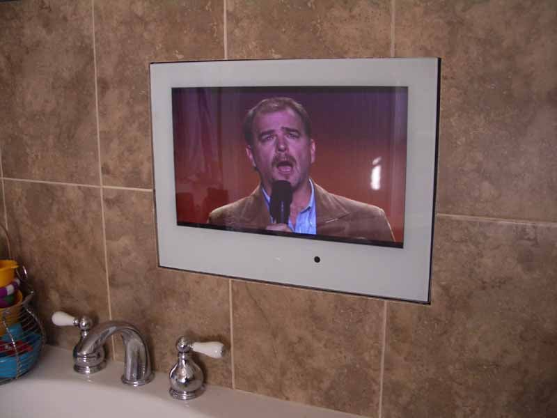

DVD: Blue Collar Comedy TourAquaView-reflections.jpg
Yes, it's not a high quality, action-packed DVD, but we simply wanted to see how the system performed with a standard definition DVD. The results were pleasing and I knew that this display not only handled NTSC cable and off-air channels well, but also DVD material fed through the component inputs. Skin detail was present and the contrast of the set allowed black levels to come across distinctly. IN the picture we took you can notice a glare off the screen - this is simply something you'll want to note and ensure that you have the ability to close the blinds or curtains on any windows you may have behind the set.
