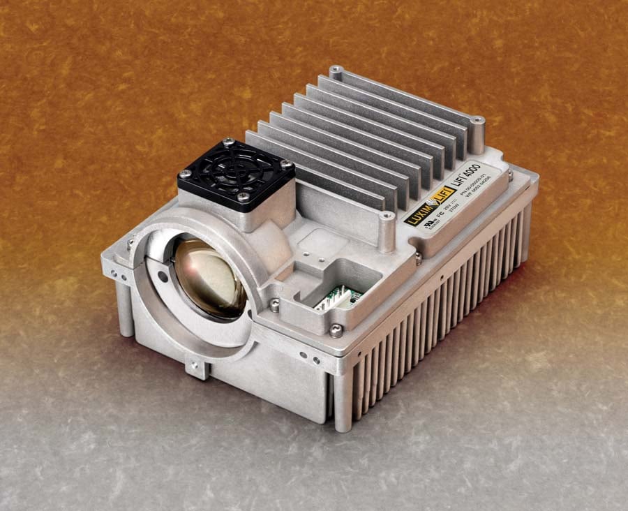

Luxim Corporation has announced that it is partnering with Panasonic to integrate its new LIFI, or Light Fidelity, lighting unit (lamp system) into their rear projection LCD TVs. The LIFI system creates intense light output with digitally-controlled dimming for high contrast applications such as those required for rear projection lamps. The lifetime of the unit is up to 20,000+ hours, a HUGE increase from the typical ~4000 hour expectancy of current bulbs.
The LIFI system also includes a fuller spectrum of color with specific reference to an extended range for reds and also features a faster startup time than typical Halogen-based technologies.
The Technology
Conventional lamp technologies utilize metal electrodes to discharge energy into a gas (Such as Halogen, Tungsten, etc.) LIFI utilizes RF (radio frequency) energy which is injected (via an antenna of sorts) into a sealed gas capsule emitter. The basic idea is that system is driven by a guided microwave transmission into the sealed chamber which resonates and creates the light output.
Tech Note Submitted by a Reader: A Halogen lamp is an Edison type filament bulb with a Halogen gas inside usually Iodine to keep the life of the bulb longer by chemically retrieving filament metal (Tungsten) deposits from the glass and bring it back on filament. The only lamps that are really gas discharge are the Neon (and such) tubes where a high voltage (thousand of volts) is discharged into a controlled pressure gas environment. CCFL's are a different type of lights where the fluorescent coating of the tube is bombarded with UV from small amounts of Mercury (Hg) inside of the tube excited by a lower voltage (hundreds of volts) than that inside of Neon tubes . CCFL's are a better lamp that evolved from old type of fluorescent tube used for home illumination that were also a filament style lamp. The background illumination of LCD's is still the weak link of these displays and maybe LED's will solve the life duration and power problem if some other light source will not be invented in the future.
Since there are no degradable electrodes, the lifetime of the lighting system are significantly enhanced. The material in the emitter allows for a greater spectrum of color to be displayed as well.
LIFI features
  • Up to ~4000 lumen output (can be used in both collimated mode for LCD/LCoS, and focused mode for DLP)
  • 20,000+ lifetime (about 5x longer than conventional UHP lamps)
  • Up to 10x faster turn-on rate
  • Dynamic brightness control (can be electronically dimmed between 20-100%)
  • Nominal power use: 270W (includes microwave transmitter)
  • Dimensions: 5.3" x 3.6" x 6.8" (135 x 91 x 173mm)
