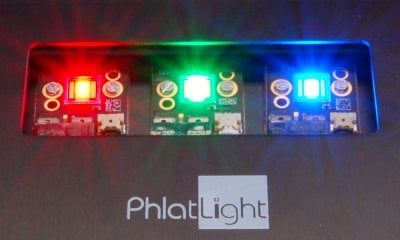

At the show, several manufacturers announced new LED-based technologies. The first manufacturer to bring LED lamp technology to the home theater market is Delta Electronics. Delta's new 1080p DLP projector features an LED-based optical system from Luminus Devices. The new LED tech is dubbed "PhlatLight" and promises to last around 20,000 hours - around 5-7 times longer than traditional metal halide bulbs.
