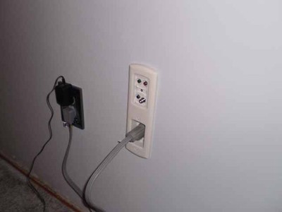

Each plate is tall, and above the power receptacle I noted a square, angled opening for low voltage wiring. When I flipped over the plate I also took note that this angled plastic piece could be removed and replaced with a Decora-style insert that could support keystone jacks. This meant that I could easy affix a plate that would have the component video and RF (cableTV) connections I needed for my room. Since the plate insert gets screwed to the exterior plate from within, there are no exposed screws and the cables will connect securely to the plate itself.

To begin, I located my existing studs with a stud finder and then marked the desired locations for the PowerBridge plates by laying out the template provided. The template should be set vertically for the bottom plate, but can be horizontal behind the television depending on your requirements, location of the studs, etc. I chose a horizontal layout for the top part of my installation as it allowed the finished plate to be completely concealed behind my flat panel TV mount and also provide easy access to the cable jacks. After cutting all the holes (4 in all; two at the top and two at the bottom), I fed my 12/2 Romex cable through the top single gang box (not fastened to the wall yet), thru the large hole at the top, down the inside of the wall, and out through the large hole at the bottom. I then sent it through the single gang box dedicated for the power feed behind the wall. Once the power was run I stripped the ends of the 12/2 cable and fastened the ends to the inlet and outlet Edison connectors.
Next, I fed some custom-assembled Planet Waves cables for my component video and also my coaxial RG6 cable line for video through the small hole at the top. With everything loosely connected and run I was then able to work on the low voltage wiring..
For these, I chose to use Leviton Quickport multimedia plates. These are simple 4-port, duplex inserts and are available at your local home improvement store. Using these plates allows for a more professional finished look when making the final connections. These plates screw down to the inside of the PowerBridge via two small Phillips screws, securing them to the plate and allowing you to use them without having to use a low voltage plate in the drywall if you choose not to. The included pass-thru ports will also work just fine for those who don't want to go the extra mile for finished connector plates. Once fastened I just snapped in the coax jack and component jacks from CablesToGo and secured the wires to the rear side of the ports.

Lastly I made all my low voltage connections
for the Planet Waves component and cableTV cables. These I connected to the
rear of the Leviton Quickport jacks. I then made the final connections for the
12/2 (Romex) electrical cable by tightening the three screws on the inlet &
outlet. Using the four screws supplied, I fastened each of the completely wired
systems to the Single gang box previously installed in the wall. If you have a
voltmeter you can use the continuity circuit to test the wiring from point to
point before applying power to the system. All that was left was to connect the
36" jumper (extension) power cable to the nearest power outlet on my wall. The system
was up and running in no time and I was thrilled with the results. Installation
from unpacking to watching my television took just 90 minutes.
