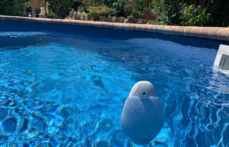

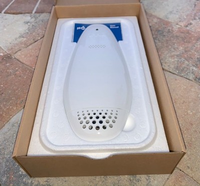

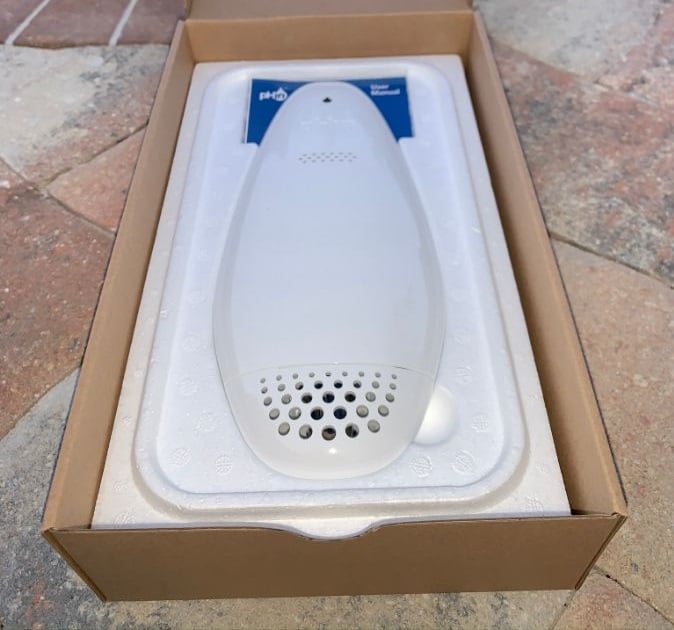

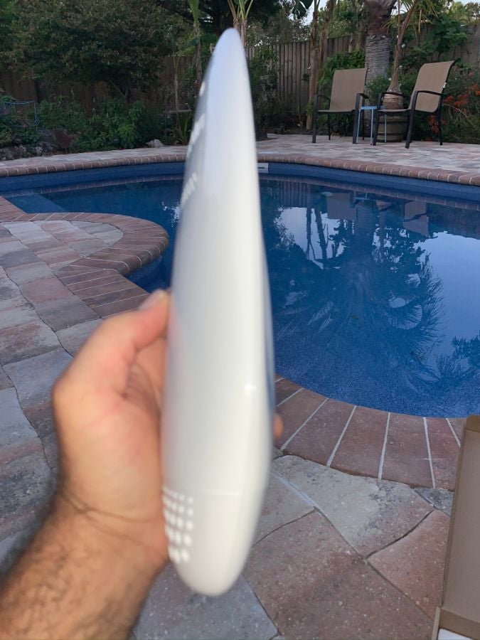

Inside the FedEx box was the smaller pHin package wrapped in clear cellophane. Opening the pHin box reveals the gently nestled cute little flattened egg-shaped pHin looking so much like one of EVA’s fins from WALL-E.
No instructions. Just the pHin, a box with a plug and a sign that reads “Bridge” and a small kit that reads “pHin calibration kit and tether”. What to do now…

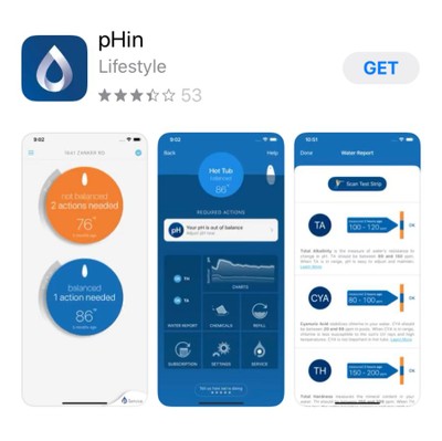

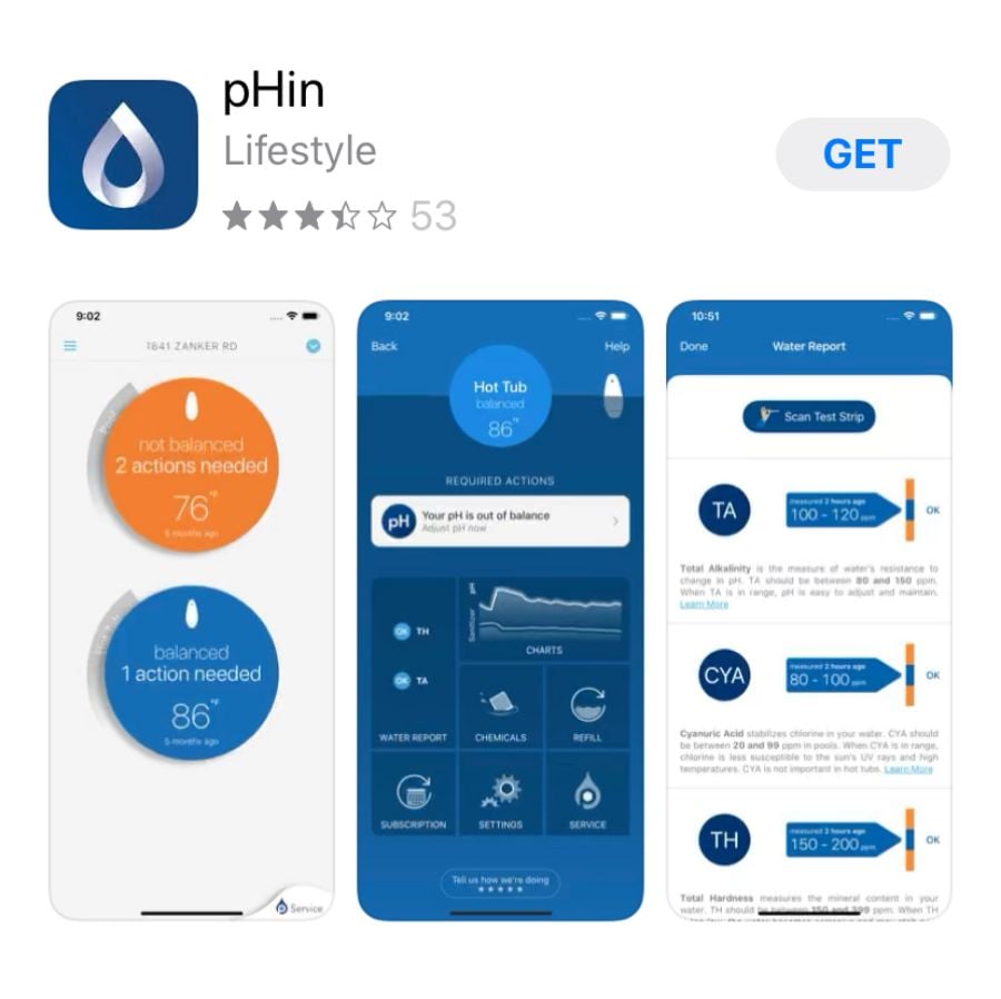

I downloaded the app and followed the instructions on my iPhone. I had to register my account through email and then scanned the wireless bridge to help set up the connection between the pHin, the bridge, and my iPhone. Once everything was connected and communicating properly with each other I could go ahead and set up the pHin to monitor the pool. The pHin connects to your phone and WIFI bridge through Bluetooth which then connects to pHin’s servers through WIFI allowing you to receive alerts and monitor your water chemistry even while not at home.
Note: I found it humorous that Hayward Industries, a company known for manufacturing pool equipment and makes the pHin monitor, had the easiest WIFI setup I’ve ever experienced connecting the pHin bridge to my wireless router.
The app asked que

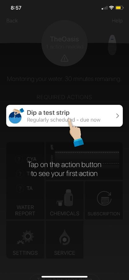

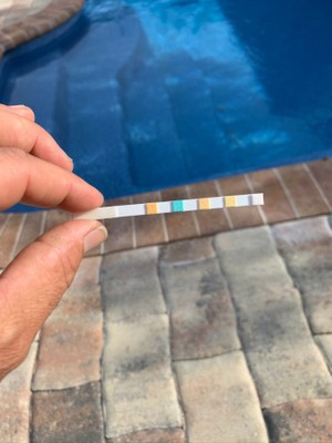

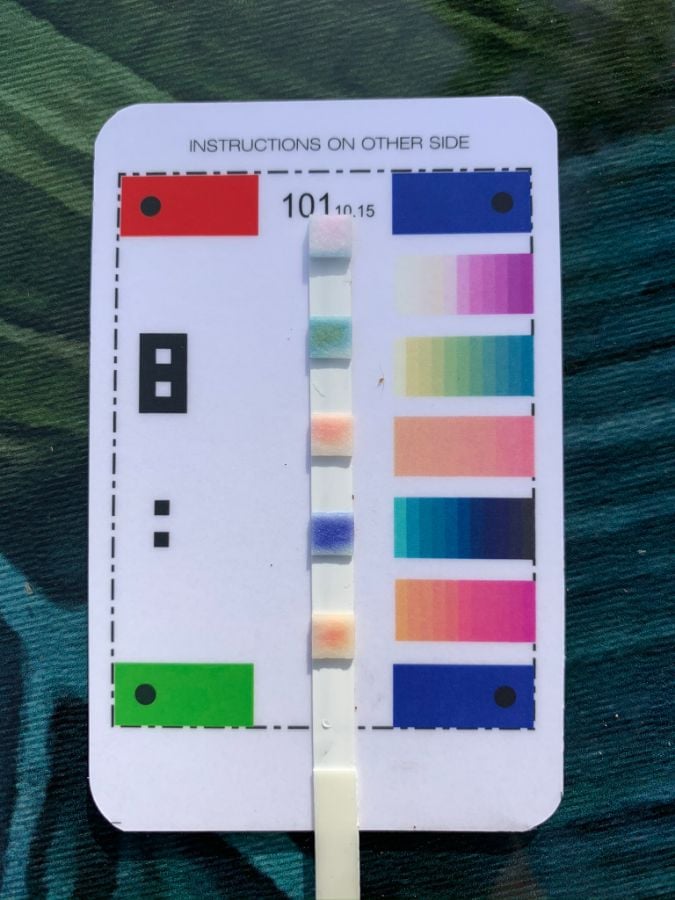

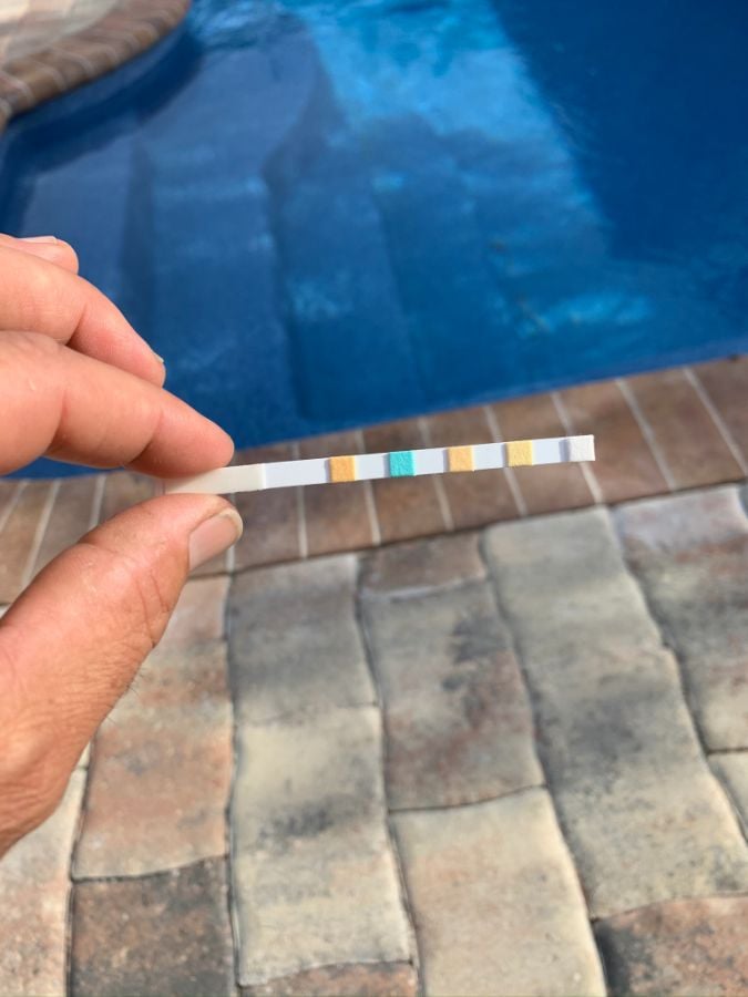

stions like the size and type of sanitizer my pool used: Bromine, chlorine, salt chlorinated, etc. I was then instructed to dip one of the supplied test strips in the pool to check chlorine, pH, hardness (calcium), total alkalinity, and cyanuric acid. You hold the strip against a marked testing card, take a picture, and the app will analyze the chemistry of your pool based on the results of the strip against the testing card which will then calibrate the pHin. You get 25 test strips with the purchase of the pHin. At once a month that’s over two years’ worth of test strips. The app has you test with the strips once a month to make sure the pHin is calibrated and to check hardness, total alkalinity, and cyanuric acid which are not checked with the probes from the pHin. If you need more test strips after two years (or if you decide to check every 2 two weeks), you can order another package of 25 test strips through pHin for $18.

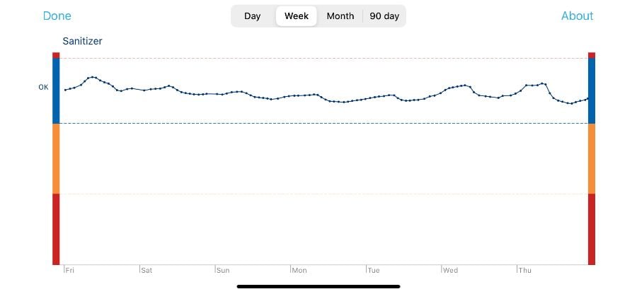

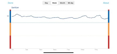

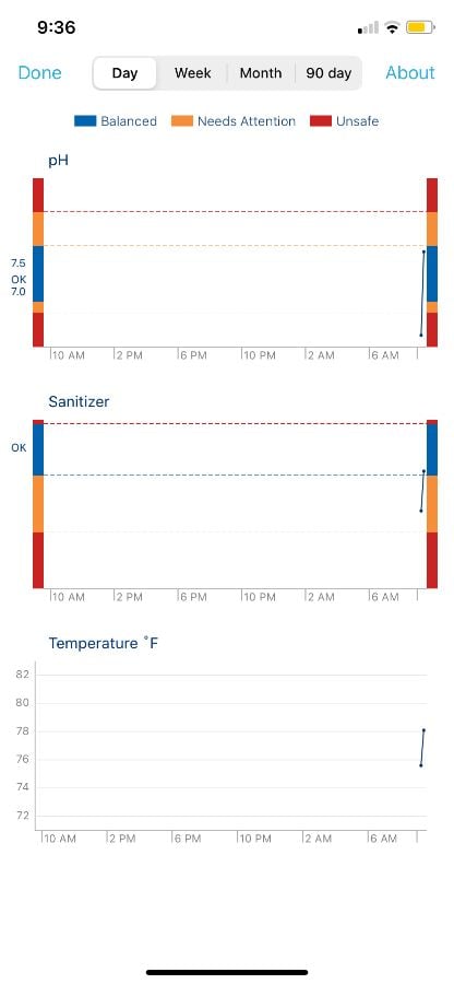

I could say that my pool chemistry levels were the same as the readout I was getting from the pHin, but that is not entirely true. The pHin doesn’t give you a number per se, but a chart of where the levels are throughout the testing cycle.
The chart above shows the sanitizer levels in the pool. You can see that you don’t get a number, but a graph of the change in sanitizer levels throughout the day or week.
Electronic sensors cannot directly measure chlorine or bromine concentrations. Instead, they measure a more important number, the oxidation-reduction potential (ORP) of your water. ORP is measured in millivolts and cannot be converted directly to the parts-per-million of chlorine or bromine. Many government water safety guidelines are being rewritten to use ORP.

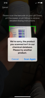

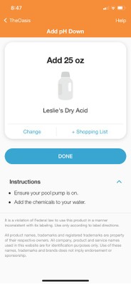

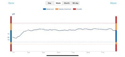

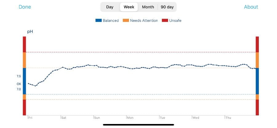

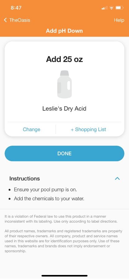

The chart above shows pH levels in the pool over the course of a week. I decided to add pH down to get my levels down around 7.5 and this is where the pHin really shows it’s worth. The app instructed me to scan the product I normally would use to bring my pH down to the proper level. I scanned the UPC of my bottle of Leslie’s Dry Acid. Unfortunately, I received a message stating that the product I scanned wasn’t in their database and to please try another product.
I emailed support (support@pHin.com) and told them of the situation. Within a day Leslie’s Dry Acid was automatically added to my app and detailed dosing instructions showed me how much dry acid I needed to add to my pool. Pretty cool.
My local pool store informed me that it would very difficult with a saltwater pool to get the pH down below 7.5 and that the levels were fine. I talked to pHin tech support about this issue and they were receptive to the idea of tailoring the levels to an owner's needs.
