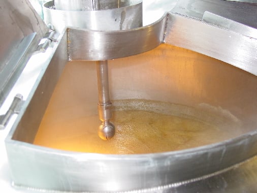

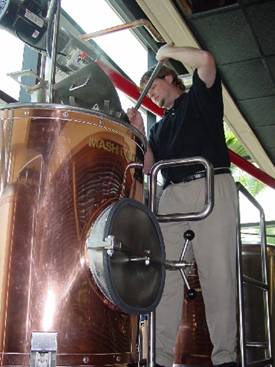

The excitement started with at 9:00am with a 45-minute mash at 165 ° F. We then re-circulated the wort for one hour to set the grain bed and to extract the desired color. The first wort measured at 23.0 degrees Plato (prior to boil).
Sparge Color

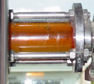

Upon completing the re-circulation, we began the 90-minute boil. At the very start of the boil, we added the 38-lbs of caramelized pumpkin, the first hop addition and the first spice addition. The boil was rigorous with a powerful pumpkin pie aroma that filled the brew room, and the restaurant.
The Boil
