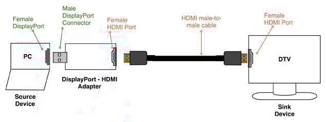

HDMI Licensing's first response to us was a clarification article that can be viewed in full here. It basically reiterated what a complaint cable was and what designated a non-compliant cable. It went on to explain that the real problem was that the Compliance Test Specification (CTS) isn't set up to test such a cable. So, HDMI Licensing will support this:
displayport HDMI adapter
used in a system that would look something like this:
HDMI to displayport adapter

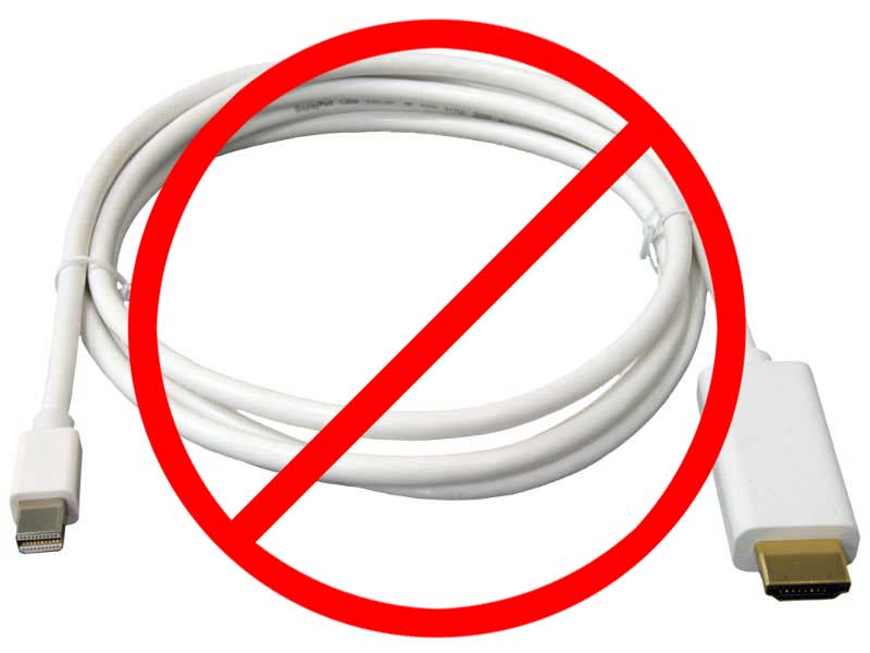

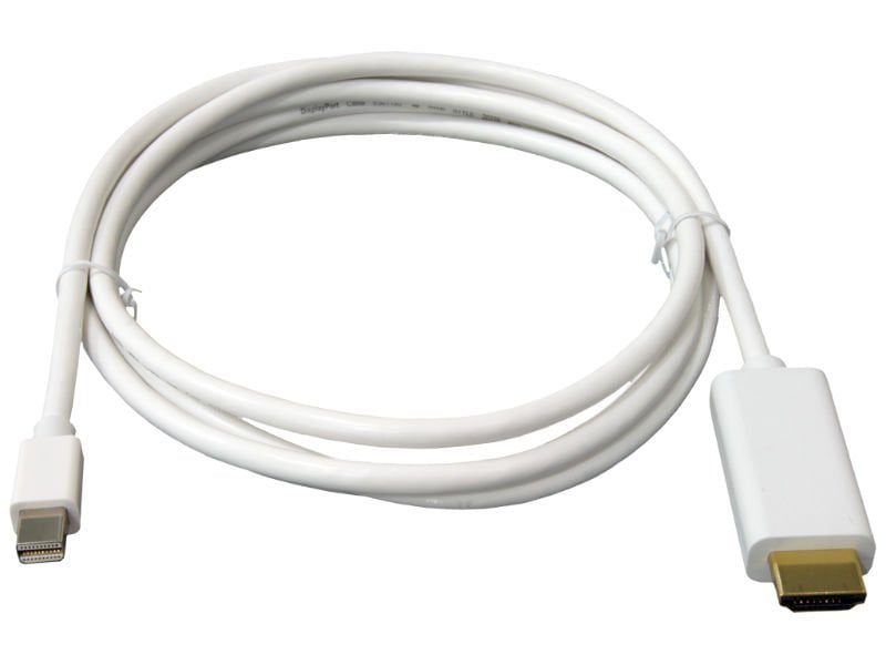

But not this:
displayport to HDMI cable
