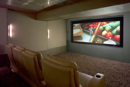

The 336-square-foot space may have offered the real estate the owners needed, but it was far from perfect. Ductwork and steel beams spanned the width of the ceiling, and a water meter and plumbing occupied the back wall.
All this would need to be dealt with before a single piece of equipment could be installed, and the owner brought in a general contractor to handle the build out. His work would involve building a soffit around the ducts and beams and building a false wall over meters and plumbing. A new wall would be built at the front of the room, as well, to create a storage area for a rack of audio and video components. Per the interior designer’s request, the side walls would be slightly angled for visual effect. Even areas like the guest bedroom and a kid’s craft area were modified to create a larger hallway into the theater and to provide access to the hidden theater gear. The entire construction process took about three months.
Audio Video Interiors kept busy during the build-out, though. “We spent a lot of time engineering the space so that the equipment would work perfectly once we were able to put it in,” says Calderaro.
He and crew members would visit the project several times during the three-month build-out to measure, check site lines and run tests.
One of the biggest areas of concern was the projector. The machine would have to be able to shoot underneath the new ceiling soffit to project its images on the 9-foot-wide Stewart Filmscreen screen. Audio Video Interiors chose a Runco RS1100 projector and dropped it lower than normal from the ceiling (the bottom of the unit is about 18 inches from the ceiling surface). Audio Video Interiors carefully calculated the height of the risers and the arrangement of the room’s 10 chairs to ensure that the projector wouldn’t be in the way of anybody’s view.
The seven Triad speakers and two Triad subwoofers that make up the surround-sound system wouldn’t be in the way, either. The front three units and both subwoofers were placed behind the acoustically transparent screen and the four rear speakers were recessed into the tapered side walls and covered with acoustical fabric.
Remarkably, even with all this equipment, it took Audio Video Interiors just one week to install and connect everything. Calderaro chalks it up to good planning and coordination with the contractor, interior designer and homeowners.
