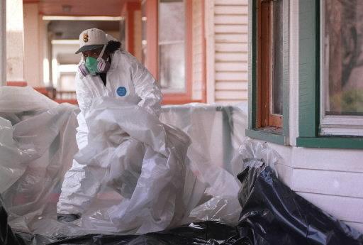

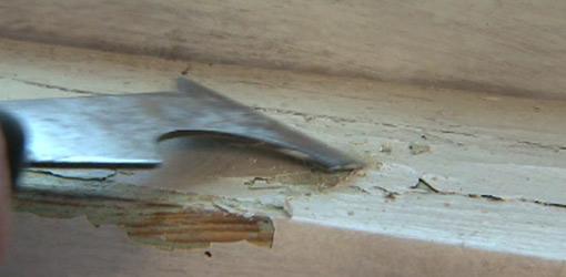

This was the fun day; I had to get up at 3am so I could drive 4 hours to my nearest learning center for the hands-on class that was to last from 8AM to 12PM. Upon arriving at the learning center we all sat down for some helpful presentations and some great question and answer time with the instructors that were there. The hands-on class really just reinforced all the critical aspects of the on-line class to make sure that it was drilled into our heads what we are supposed to do once we became Certified Renovators. There was a lot of discussion on the health problems associated with disturbing LBP (Lead-Based Paint) and how it really affects young children with often life-long problems, hence the rules that have to do with schools and day-care facilities. A portion of the hands-on class was devoted to testing methods to detect if lead is present the paint.   Also there was discussions on how to properly set up a work site, how to contain the work area and how to minimize dust. Since I am in the renovation business, some of the topics in this area were pretty much best practice for us much in the same way we try to minimize the spread and inhalation of demolition and  drywall dust when we are working on a project. The biggest things to take from this is to minimize dust and to use a HEPA dust collection system as much as possible when using power tools. There was also the clean up procedures that are designed to minimize contamination to other parts of the building and other people that might be nearby.
In as much as there are precautions to protect the inhabitants of the building, there were also discussions on protecting and training workers so that they understand the implications and proper safety procedures on the job site. It was actually a fun part of the hands-on class was when we broke down into teams and had to set up a proper work space, with proper containment methods that included protecting furniture, existing surfaces and openings. Each step of the way was supervised by an instructor to ensure that we did things according to the rules. To help make it a little easier, there were handy check lists and books that they handed out too. To be honest, some parts of the procedures were a little overwhelming and it made it nice to be able to glance at the checklist to make sure we were doing all the right things in the right order. When we were all done with the practical part of the class, they handed out the test that was made up of multiple choice questions. In order to pass the program, you had to score an 80% or better on the test. For all you worried test takers out there, we did not have a single person fail in the group of 14 that I took the class with. So given that statistic, I think most folks pass without too much trouble.
