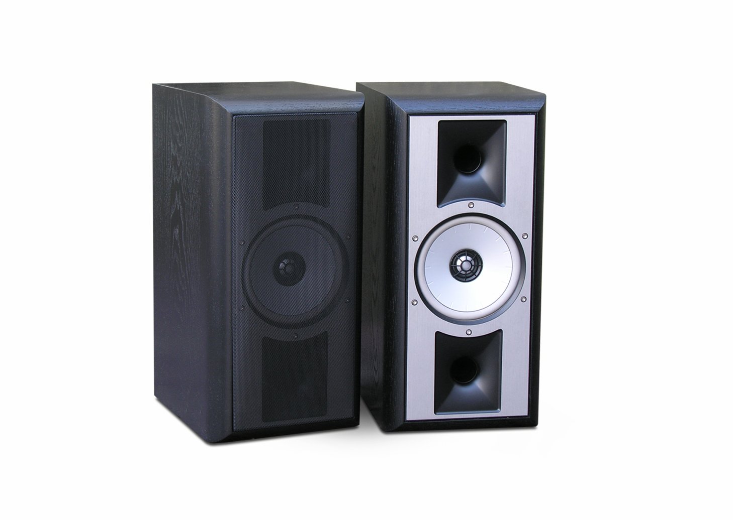

The Thiel SCS4 is too small to be a floor standing speaker, and although on the large size for a bookshelf speaker, it will fit on all but the very smallest bookshelves. It will also fit easily on a typical speaker stand, but my first listening was done with the speaker on the floor. This is not the preferred location for this speaker, and Thiel clearly states this in their manual. When my son came into my listening room hearing the speaker for the first time, he immediately proclaimed, “Wow, that has way too much mid-bass!” (Adam is the Golden Ear in the family). Even elevated, this speaker has a bit too much mid-bass for my liking, and placing it on the floor exacerbates this issue. If we examine the impedance magnitude curve of this speaker, and place this information over the frequency response, it is clear that the output of the speaker is highest where the power demand is highest, and the impedance magnitude is lowest. In my opinion this speaker will sound more natural when driven with a tube amp than with a transistor amp because of the higher output impedance of the tube amplifier compared to a transistor amp. “Fattening” the low frequency output in this region is an easy way for dramatic affect to be added to movie soundtracks, and is sometimes done by manufacturers to create ”the wow effect” in the untrained ears of potential end users. I do not believe that was Mr. Thiel's intent. After speaking to him by phone, I believe he is motivated to make the best most neutral speaker he can, as he is by himself the engineering department, and wants most of all to make something he himself would buy.

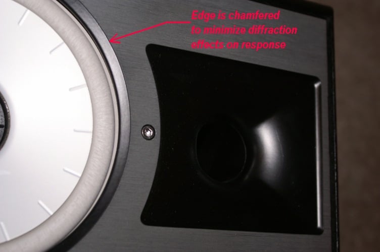

Chamfered edge.jpgThe two ports, one each above and below the coax driver, are also cast into the aluminum panel. The air inlet inside of the box is constructed with a flared plastic tube which glues onto the straight end of the cast aluminum port hole.(flaring reduces port turbulence at high outputs and therefore lessens distortion)

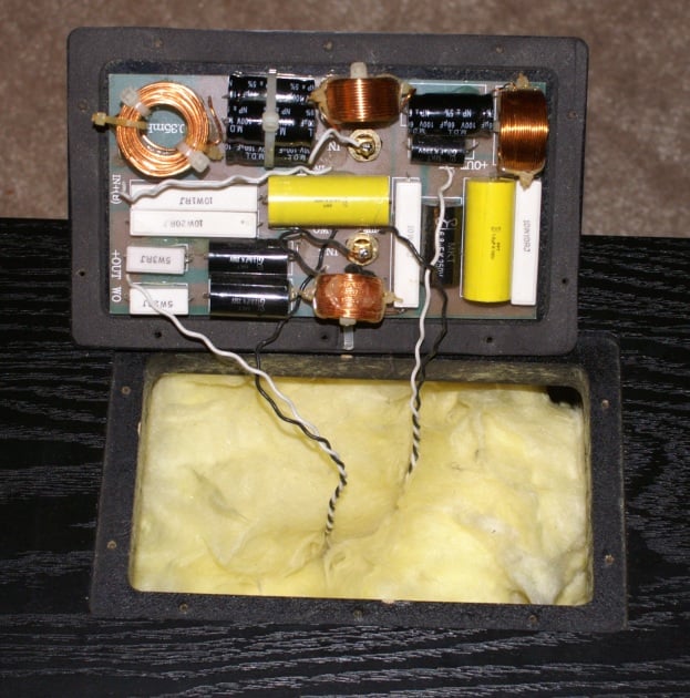

The crossover was a surprise after being told the aim was a first order network in the transition band (first octave on either side of the crossover point). By my part count, this looks like a fourth order network with at least one Zobel network (Impedance compensation). The crossover network uses exclusively air core inductors. The capacitors were either Electrolytics or Film (polyester perhaps)?
Where Electrolytics were used, they were placed in parallel which results in less series inductance and resistance, so their negative effects are minimized. Unfortunately, the resistors are all glued right down on the PCB, minimizing their ability to dissipate heat. This is a minor issue with low power speakers like the Thiel SCS4. To minimize the weakening of the speaker box, the thru-hole and backplate panel are made as small as possible in order to keep the box strength at a maximum. The plastic plate appears to be just large enough to mount the crossover board. By minimizing the through hole size, we minimize the loss of cabinet strength created by the hole.
Rear_Inside.jpgI was delighted to see that Jim Theil, like myself, is a fan of fiberglass insulation. We have both measured polyester fiber fill treatments, typically used by other manufacturers and agree that polyester fiber fill does little to nothing to minimize reflections inside a speaker box. The right amount of fiberglass was used here, and it was located in the right place. It was not lost on me that the fiberglass was skewered in place and held there with solid core copper wire. Audioholics readers who recall Thiels interview and discussion with Gene DellaSala about wires likely remember Thiel prefers solid core over stranded copper for wiring. Perhaps it has less to do with skin effect or material density than it does as being a tool to hold the fiberglass behind the speaker (where it does the most good) and away from the ports (where it will do the most harm). Stranded wire might not hold the fiberglass in place as does the very stiff solid core copper crossover to speaker wires.

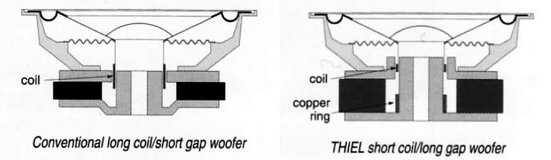

Overhung vs Underhung Voice Coils
The speaker itself is a two way, with a 6.5 inch woofer, and a 1 inch coaxially mounted tweeter. The speaker cone is not entirely aluminum, but rather an aluminum skin over a polystyrene (plastic) material. The combination is both light and strong. This is a difficult thing to achieve with the shallow woofer cone like the one Thiel uses on the SCS4. The use of a deep cone, the usual approach to achieve high strength with low mass, would adversely affect the off axis response of the coaxially mounted tweeter, hence the unusual but effective approach. The low frequency driver (woofer) uses a non conventional motor. In most woofers, the voice coil is longer than the magnetic gap is high. This is known as an overhung voice coil, and is used by far and away most woofers. The advantages of the overhung approach include material efficiency and subsequently cost. The disadvantages include higher distortion and lower power handling (possibly not definitely). Thiel uses an underhung voice coil, which means the voice coil is shorter than the magnetic gap is high. It also means the voice coil is always completely immersed in the magnetic field – (read less distortion). To further reduce distortion, Thiel uses a copper shorting ring in the motor, to reduce magnetic flux modulation, and voice coil inductance changes with position, two other sources of distortion particularly problematic in woofers.
SideBySide.jpgAnother advantage to under-hung voice coils is less frequency response variation of the woofer with high drive levels. A disadvantage to this approach (besides cost) is that if overdriven, the speaker WILL BOTTOM or worse, break. Thiel recommends no more than 200 watts to drive this speaker. I would adhere to that without fail. Minimizing the maximum voltage across the woofer will eliminate the bottoming that will occur with higher than recommended power at low frequency.
Thiel PCS woofer features.jpgWhile Thiel uses aluminum for the tweeter diaphragm (dome) he does not (thankfully) use it for the surround(edge). While aluminum has its advantages, it also has some negatives as well. If you are a fan of aluminum you know who you are. Those of us who are not, recognize that while it may work for the dome (which should be hard) it can be a disaster when used as the surround edge, which is supposed to be compliant. This latter approach is often found in compression drivers (for horn speakers).

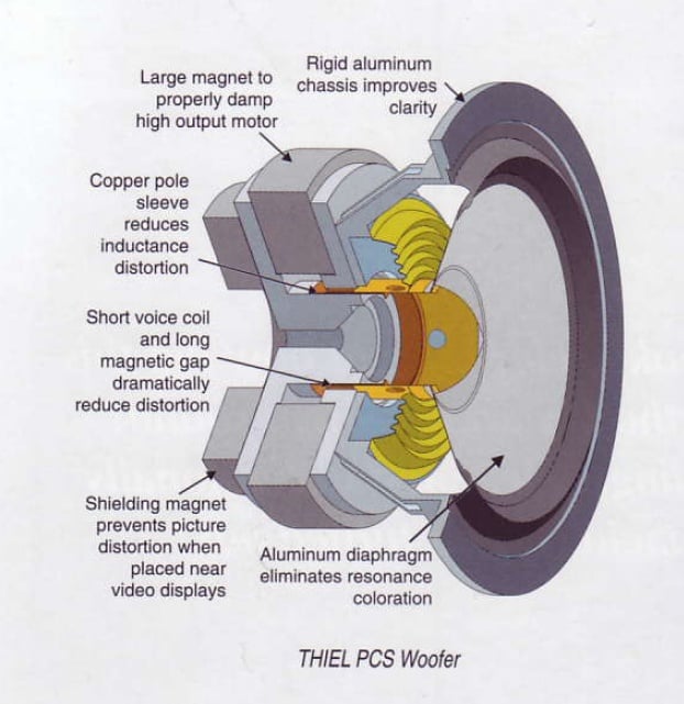

The Coax Driver – For those of you with a greater curiosity about the internal details, I will have to defer my opinion to the vendor. My sample did not include license to take it apart, but Thiel was good enough to provide a sectioned drawing detailing the inner workings of the driver.
Please note the driver itself includes a metal shielding can found in better designed drivers shielded for video applications. That back-can is not shown in the above diagram.

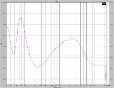

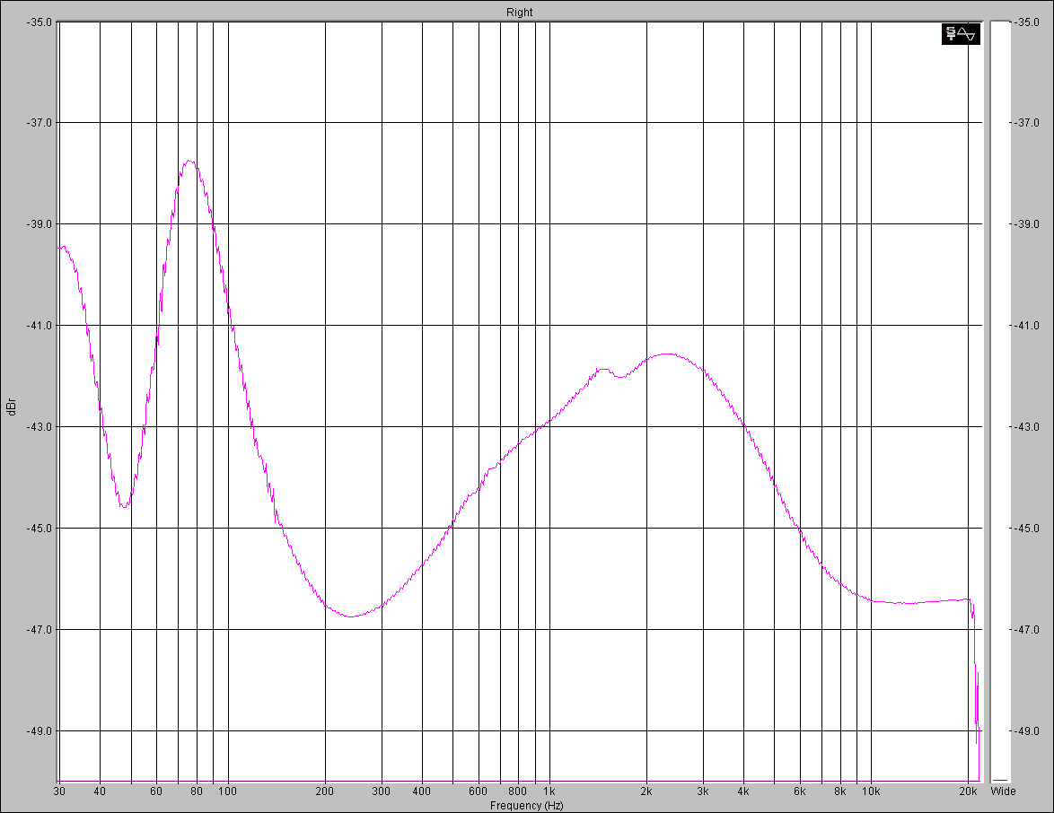

24th_Octave_Z
Impedance Magnitude Measurement of the SCS4 (40 db Graph)
System impedance drops to about 3 ohms in perhaps the worst place it can, the region between 200 and 300 Hz. The reason this is worrisome is because this is the range of frequencies where the greatest long term power demanded in the musical spectrum is often found. Direct measurement of the system DCR shows a VC impedance of less than 3 ohms. (I measured 2.8 ohms on my sample).
The blip in the curve at about 1.6 kHz may be the result of the resonant frequency of the tweeter interacting with the crossover. It might also be a poorly controlled resonance in the woofer cone. This is the same place where the midrange THD grows to be highest during a single frequency sine sweep. (It makes sense because this is often the low frequency limit for the tweeter, where the voice coil will have to move the farthest, putting the greatest strain on the motor of the tweeter. According to Thiel, the actual crossover frequency of the system is 2500 Hz. If that is the case, then this seems to be a resonance not ideally controlled.
The tweeter impedance remains very flat at the highest frequencies. This is either the result of network compensation (the crossover) or a shorting ring (copper usually) on the tweeter motor. The extension of the tweeter on axis is good out to 20 kHz as advertised.

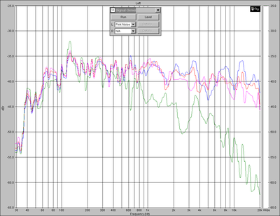

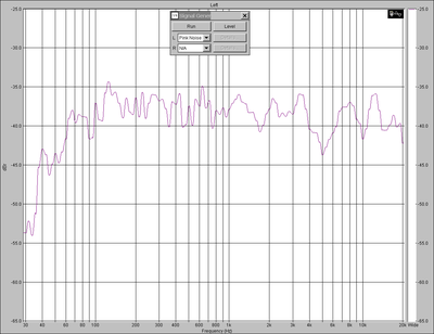

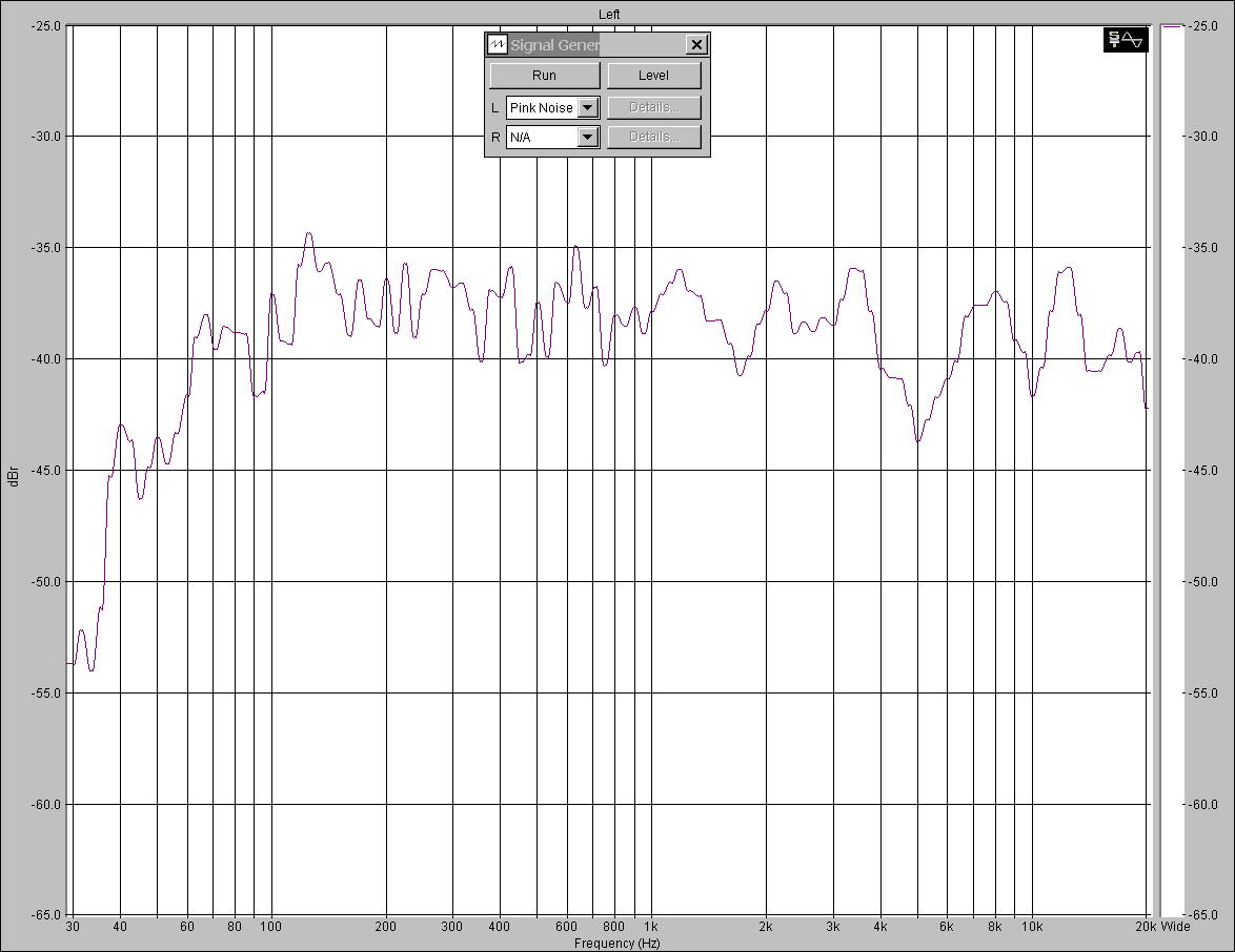

In Room Frequency Response
(with 1/24th octave resolution - 40 db Graph)
As you may be able to tell from the curve above, this is a live room measurement. For those of you who do not make a living with measurement microphones, you are likely wondering either why I might try to do this without an anechoic (echo free) chamber. Besides the million dollar price tag, to build one which is good down to very low frequencies requires a huge amount of space. That said, those of us who do (make their living with a measurement mike) can often look at these curves and see which aberrations are due to the room, and which are due to the speaker. (I call it reading through the room). As a rule of thumb, I take measurements in live rooms near-field on the ground plane (the floor) which works best for subwoofers or to see the low frequency performance of a speaker alone. I have found there is often too much error in this method to use it for full range measurements. The other technique is to place the speaker midway between the floor and ceiling and the mike at a distance around three times the size of the loudspeaker unit. In this case the curve above is taken at 3 times the driver diameter or in the case of a small 6.5 inch coax, 16.5 inches away. (A compromise between sources of measurement error). This is how the SCS4 was measured. If you are asking yourself "why is Paul telling me this?" it is because in a different laboratory, we may see a slightly different curve, and I am mindful not to ascribe ALL of the numerous peaks and dips in the curve above to the speaker alone. Taking a curve of the mate (other in the pair) of this speaker at a larger distance in another laboratory, I did not measure the large hole at 5 kHz. That said, 5 kHz is not the frequency range where rooms typically misbehave.

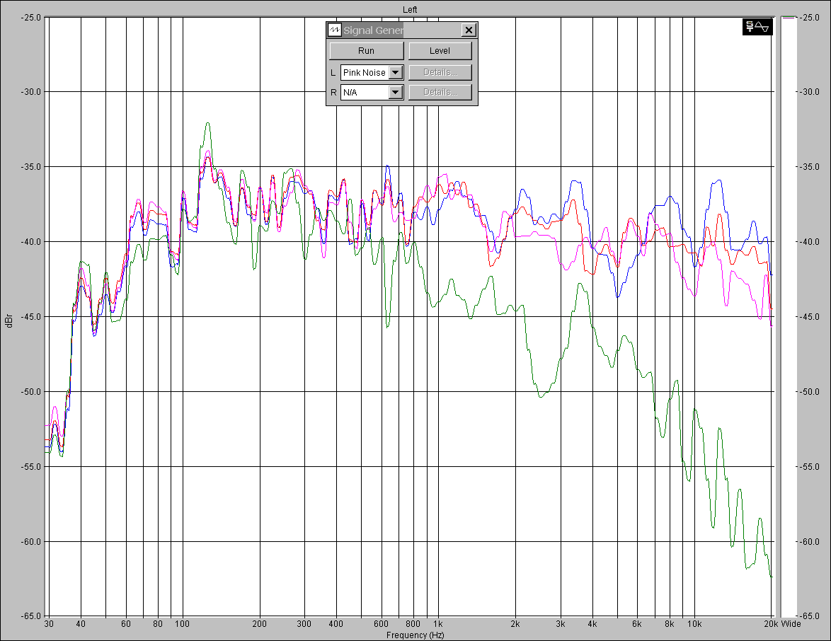

0,15,45,90 degrees
Frequency response at 0, 15, 45 and 90 degrees (40 db graph)
Blue – on axis, Red – 15 deg, Pink – 45 deg, Green – 90 degrees
As you can see, the off axis response is smooth and rolls off in a predictable and well behaved way. At any angle within 45 degrees, there is a small loss only and it is confined to frequencies above 2k Hz, the range of the tweeter. The severe loss at 90 degrees is to a great extent a result of the shadowing of the tweeter by the woofer cone.
