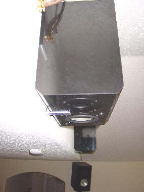

For the role of rear 7.1 surrounds, the 41-SE's fit the bill quite nicely. In the room hosting Reference System 2, the install was challenging given there was no true rear wall to install them. We wanted to minimize drilling into the speakers, especially from the front or sides, but we needed them to point downward due to the location. Adding to the difficulty was their size and 12-lb weight and the fact that they are located directly above the heads of anyone sitting on the main couch. The last thing we want is for them to fall on someone's head, especially mine.
A challenging Installation
To accomplish this installation, I used to two heavy L-Brackets, and one smaller L-Bracket per speaker along with a series of screws in addition to some intuition. The smaller L-Bracket located on the face of the speaker, as seen in the picture, is used to partially support the weight. This bracket was installed on the wall first. I predrilled the back of the speakers to install the two large L-Brackets. I then took the speaker and bracket assembly up on a ladder and used the previously installed smaller L-Bracket to balance the weight of the speaker. While supported by the smaller L-Bracket, I then used a pencil to mark the mounting holes on the wall where the larger L-Brackets would attach. I installed metal screw mollies where these wholes didn't line up to a beam. Once the mounting holes on the wall were ready, I once again, lifted the speaker and supported it on the smaller L-bracket. I then screwed the rear of the larger L-Brackets to the wall in four places. Although the larger L-Brackets alone would probably support the weight, I didn't want to chance them falling. By using the preloading smaller L-Brackets for the weight of the speaker, the larger L-Brackets are now specifically preventing torque, while offering redundancy weight support.

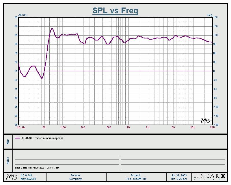

Here are some real world measurements for the 41-SE's using MLS software.
Note: The above plot is a 1/3 ocatve smoothed in room response at 1-meter. Notice the uniform frequency response and excellent extension. Their is a slight bump between 50-60 Hz which can be attributed to port contribution. This bump helped to give the little 41-SE's such authoritive bass without boominess or muddiness typically found on lesser designed systems. The average efficiency of the 41-SE's is somewhere between 85-86dB (1watt/meter). Thus we recommend mating these speakers with a quality power amp of at least 100-Watts/Channel if loud listening levels are desired.

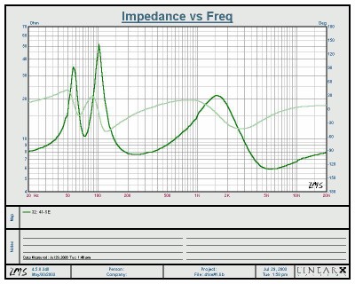

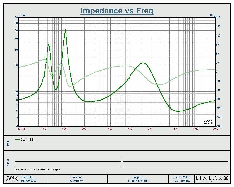

Note: The impedance of these speakers is nominally 8 ohms with a somewhat dramatic rise in the midrange area indicating that a good quality power amp should be utilized to bring out the optimal performance of these speakers. Electrical phase changes of less than 60 degrees within the power band of these speakers indicates a less reactive load to an amplifier which is always a good thing.
