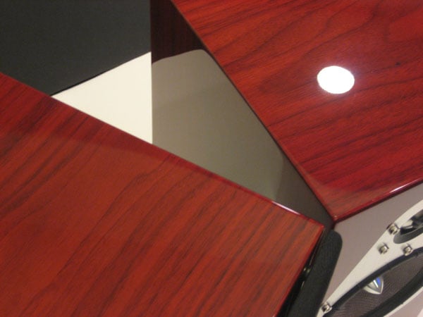

These are... bar none... the most beautiful speakers I've ever seen. While also available in a Gloss Piano Black, the samples we have here are the Piano Rosenut finish and, as you can tell, they are absolutely pristine in terms of the veneer and the gloss coat. Everything about these speakers screams high-end, yet they cost just $400 each. While that's not exactly pocket change, it's a far cry from what many people consider "high-end" and yet most of the audiophile speakers we've seen in our day don't approach this type of build quality and styling.

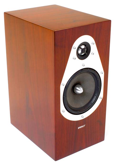

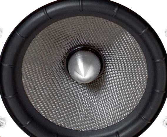

Let me break it down. The finish, while impressive, is just the start. This speaker is a 2-way bass reflex design. Inset within the front baffle is a custom brushed aluminum inner plate. It unites the 1" aluminum dome tweeter with heat-synched neodymium motor and 5-1/4 inch Kevlar woofer. The woofer is shielded and has a real phase plug and a ribbed elliptical surround. Energy positioned the tweeter close to the woofer to create a near-seamless origination point free of lobing effects.

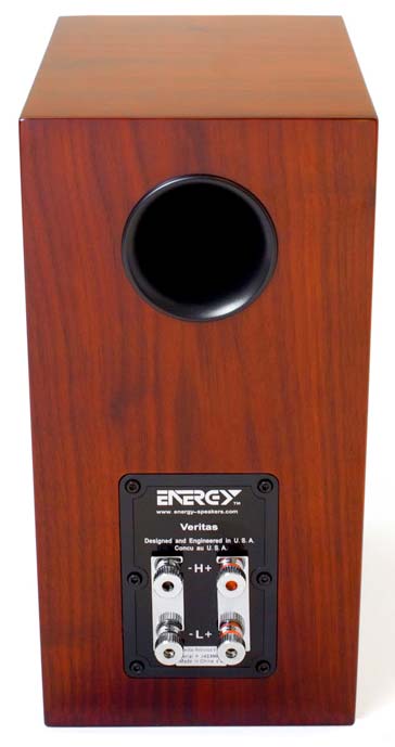

In terms of performance, the Veritas V-5.1 has a frequency response of 50 Hz to 25 kHz +/- 3dB. It has a sensitivity rating of 90dB at 1 W, 1 meter which is very efficient. You may not be able to drive this speaker with a 9V battery, but it's close. On the back of the speaker is a port - which can be stopped with an included foam plug in the event you have them close to a wall and want to reduce the bass output. The box dimensions are 13 x 9 x 6.5 - a respectable size for a bookshelf, with enough room to handle some really low bass and yet small enough to take on a diminished look in any décor. Weight is around 12 pounds each.
Connecting speaker cables to the Veritas line is easy. On the back you'll find a pair of nickel-plated 5-way binding posts. There's also a standard 3/8-inch threaded insert for mounting the speaker to the wall. For best sound we recommend putting these beauties on a nice speaker stand and showing them off - preferably without the cover.
