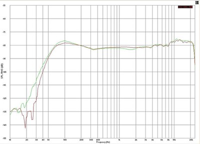

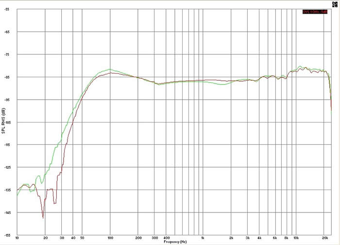

Frequency Response (+/-3dB): 55Hz-22kHz
Extended Response (-6dB): 45Hz-50kHz

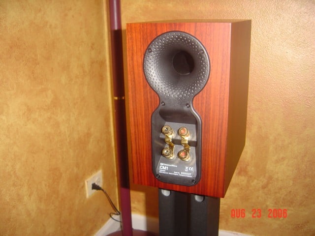

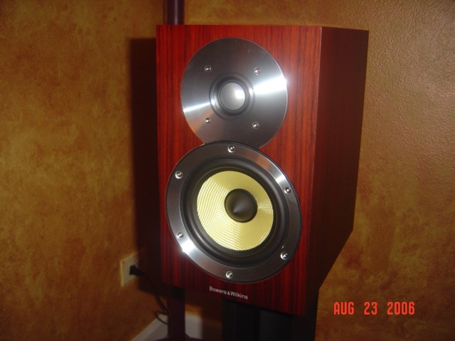

Tweeter: 1” tube-loaded aluminum dome
Mid/Woofer: 5” Kevlar cone
Crossover Frequency: 4kHz, first order slope.
Harmonic Distortion: <1%, 110Hz-22kHz (2nd and 3rd order harmonics at 90 dB, 1m).
Amplifier Power: 100 W.
Dimensions (HxWxD): 11” x6.5” x 10.9”
Weight (each): 14.7 lbs
Enclosure Type: Two way ported.
