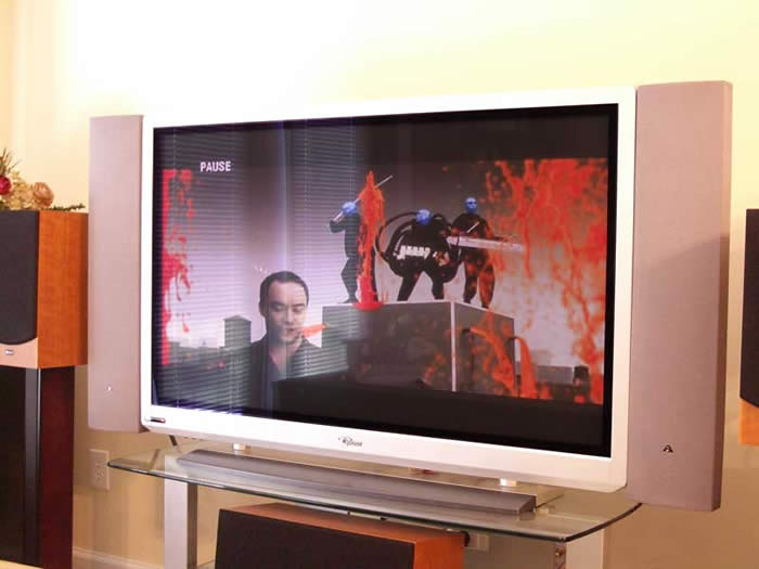

The Artison speakers arrived in three boxes. One box contained the loudspeakers themselves, another held the grills, and still another contained the required hardware for mounting them to the display. This is an efficient packaging system for the company as it allows them to mix and match as needed in order to deliver a system that perfectly complements a particular plasma or LCD product.In our case, the speakers came with light grey grills and hardware that was made to mount directly to the four rear mounting points of the plasma display. The hardware that came with the Artison speakers included almost every size of threaded bolt and washer used on currently shipping plasma and LCDs.
The Artison's glass beaded anodized aluminum cabinets were top notch. All of the hardware mounting pieces were powder coated. In taking a close look at the Sketch speakers I was given a glimpse at what the driver complement was and how Artison intended to use those drivers to accomplish its goals. The Dual Mono center channel units and midrange drivers are completely separated into their own chambers. Both are also ported to deliver some extra punch given their relatively small enclosure size. The 4.5" polypropylene drivers looked well built and the Vifa soft dome tweeters use neodymium magnets with heat sinking much like the ones they used in the past. The geometry of the cabinet and drivers is such that the left and right channel are directed outward from the screen a bit, while the top DualMono speakers are angled inward to originate sound from the center of the screen. The 4.5" drivers have phase plugs at the center and I found the overall construction of the drivers to be solid - from the stiff plastic basket (a nice step up from the typical Chinese stamped drivers) to the woven spider and rubber surrounds.Artison Sketch LCR Setup and Listening Tests
Each speaker is designated as right or left. This is important because you want the top, DualMono center channels firing inward and the lower left/right channels firing outward. Of course, if you flipped them you'd be doing some serious surgery to get them to attach, but that's beside the point. The speakers have 2 sets of gold-plated push post terminals for the center and main drives. Once installed, you connect a speaker wire (included) between the two center channel speaker terminals to create the DualMono center. With the included wire, it was a tight fit to also insert a 12-gauge speaker wire into the push post, but I managed. You may want to twist the ends together to create a single bundled end for insertion.
Speaking of those bars, the speakers came with felt-covered flat pieces of powder-coated metal which inserted into a horizontal mounting bracket which secured to the rear of the flat panel. The felt lining made sliding the speakers incredibly easy and smooth and also did a nice job of protecting all of the involved components in the process. By carrying the width of the center mounting bracket and adjusting the sliding positions of each speaker, display sizes from 40" - 63" can be accommodated (the minimum height of their shortest grille is 23.8".)
