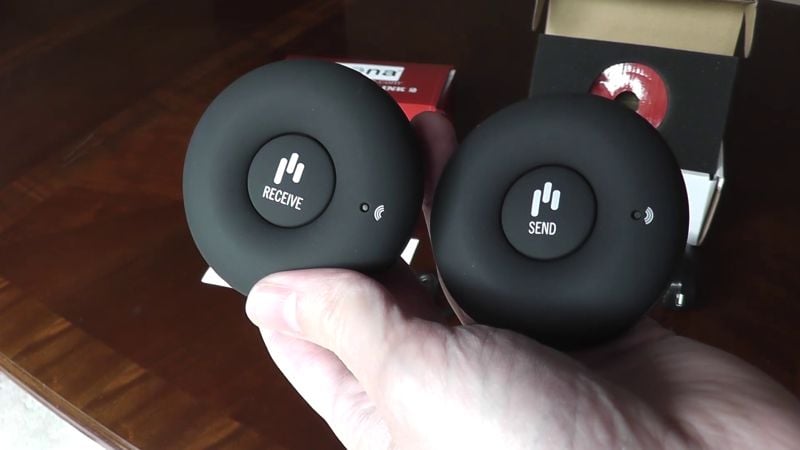

The HAL system consists of a 3” round transmitter and receiver to wirelessly stream an audio signal. It is powered by a USB port, or via an included wall adapter. It can be used to distribute audio throughout your house, with up to 3 total receivers, or wirelessly connect subwoofers at up to a 100 foot range. The HAL features 48kHz/16 bit transmission quality, and can connect to any analog audio source via a 3.5mm input, or to a computer via the built in USB. If you get interference, or want to setup multiple systems, you can easily toggle between the 3 color-coded channels using the button on front.
Greetings HAL.

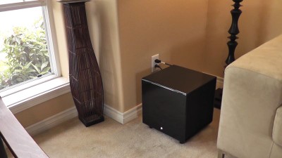

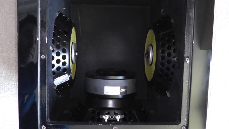

The HAL and Bravus II 8D subwoofer shipped with Aperion’s trademark attention to detail, including a fabric bag for the sub. The Bravus sub is a 27lb, 12 inch cube perched atop 1.5” rubber feet or metal spikes, which provides breathing room for an 8” down firing driver. The sub also features two 8” passive radiators instead of a port on either side of the enclosure. The enclosure itself is black gloss with rounded edges which lends itself to a sophisticated look, and the small size means you can tuck it out of sight, should you so choose. A 10” and 12” version are also available for those with larger rooms to fill.
The Bravus II subwoofer is powered by a 300 watt RMS amplifier and has a standard compliment of controls including a power switch with an auto setting, a 2-way phase switch, variable crossover and level knobs, mono LFE and stereo line inputs, and speaker-level inputs with nice 5-way binding posts. Less common is the inclusion of a USB-style power port, which we used to power the HAL and connect the sub wirelessly to the Allaire Bluetooth speakers.

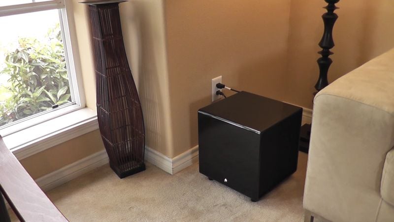

Aperion's Bravus II 8D is compact enough to fit in all but the tightest spaces.

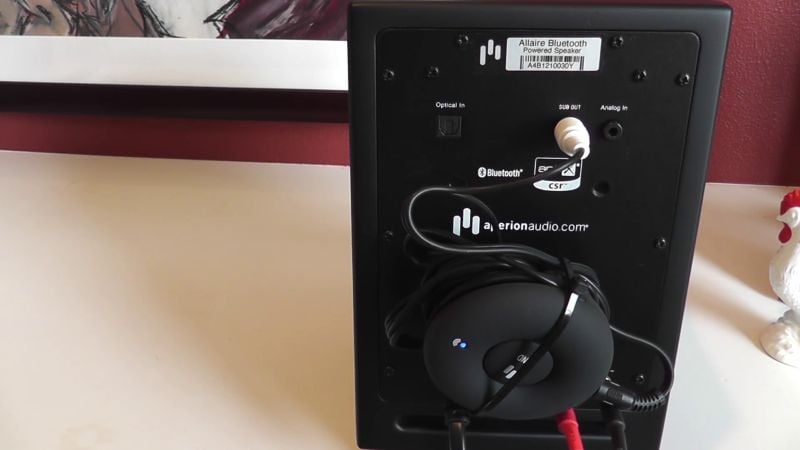

To connect the subwoofer wirelessly using the HAL, I simply had to power the HAL via the USB port on the speakers and sub, and use the included 3.5mm to RCA cable to connect the transmitting unit to the speaker’s sub-out, and the receiving unit to the subwoofer’s stereo line input. The 5-foot cables provided were a little excessive in length, and needed to be tidied up with a zip tie. I would have awarded Aperion bonus points if they’d included shorter cables given that these products are being bundled for use together; however, you can easily buy shorter cables if you don’t like my zip tie method.

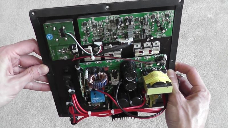

The 300W plate amplifier and internals of the Aperion Bravus II 8D.

I really enjoyed being able to send music from my tablet or phone via Bluetooth, switching tracks easily with my device close at hand, but not having to settle for the subpar sound most Bluetooth users are accustomed to. The Bravus subwoofer tucks nicely out of the way next to a couch, while the Allaire speakers are smaller than most of the pictures and knick knacks I already have on my mantle. Add in the HAL system powered via USB, and I actually have fewer wires running along baseboards and to wall outlets than I would traditionally. If you are looking for a system with the latest features that sounds big, but doesn’t take over your room, you may want to avail yourself of Aperion’s Allaire Bluetooth Speakers and Bravus sub bundles.
