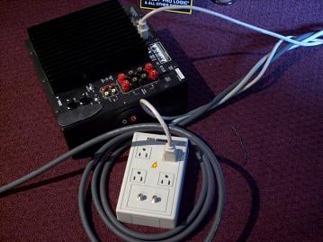

Just
for fun, I wanted to see if I could introduce RF into the cable by
wrapping an amplifier power cord cable around the DVI cable (Many times
the DIY'er will inadvertently run cables across 110v romex and this
will trigger many problems). The photo below shows the power strip and
amplifier power cable wrapped around the Impact Acoustics DVI cable.
The amplifier I used has a little transformer hum even when sitting
Idle. I was unable to introduce any noise or RF interference into the
cable revealing that the Impact Acoustics DVI cable has excellent
shielding. In addition to that, its build quality is exceptional.

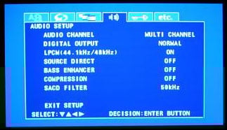

The next page in the Setup menu is for configuring the Audio Setup. The first setting is for audio channel speaker configuration. I chose the factory default multi-channel, because I have a multi-channel system. You can also select 2 channel SRS off or 2 channel SRS on. Highlighting the Multi-channel setting takes the user to a sub menu. On this sub menu page, there are the speaker configuration, channel level, delay time and audio set ups. I configured all my speakers to Large because they are full range speakers. I selected subwoofer on. Selecting the Small speaker setting will activate the 80Hz crossover on the analogue outputs. This is a usable crossover and is much more effective than the 100-120z crossovers found in some other DVD players. With that said we would still like to see a fully adjustable cross over for the analog outputs on even mid-priced DVD players. 40Hz-150Hz would be the desired range. The next item in the sub user menu is the internal test tone generator for the player. You can apply the test tone individually to the front left, front right, center, surround right, surround left and subwoofer channels. The user can adjust individual channel levels from 0dB to -10db (there is no gain which is as it should be). There is also a setting for adding +10dB to the subwoofer in conjunction with the subwoofer level adjustment. This setting is very useful in cases where the subwoofer's relative level is simply too low when using the analogue outputs of the player. The user can then trim the added gain by adjusting the subwoofer level. The next group of settings is for speaker delay times; they are available in both feet and meters. We have to applaud Denon for providing actual length adjustments instead of the millisecond adjustments found in many other players.
Back in the Audio setup menu I left the Source Direct in the factory default Off. When On is selected, it allows analogue output of the audio signal without adding any of the speaker size settings or delay times that were configured in the multi-channel sub menu. I left Bass Enhancer in the factory default Off position. The bass enhancer does not affect the digital outputs on the DVD-2910. The purpose of Bass Enhancer is to output the bass from the main channels to the subwoofer for two channel sources. This is a useful feature for those using non full range front speakers and require the subwoofer to be active to achieve full range sound. There is a final adjustment for SACD filter/crossover setting. You can select 50 kHz or 100 kHz and, unless you are a dog, we'd suggest leaving it at 50 kHz. I was very impressed with the amount of user controls and adjustments that can be made in the audio section of this player. With all the settings available to the user, it will be very easy to dial-in and calibrate a multi-channel system.
Pressing the Pure Direct button on the RC-985 remote or on the Denon DVD-2910 front panel allows you to select Normal, Pure Direct Mode #1, or Pure Direct Mode #2. The user can store the Pure Direct mode of their choosing: digital output on/off, video output on/off, display on/off, all on or all off or any combination in the two provided memory banks. In the SACD Setup menu you can choose to select the SACD mode Multi-channel, Stereo or CD. The wide range of user adjustability with the DVD-2910 is very impressive. The Denon engineers have hit a home run with the development of this user interface and impressive list of options and adjustments. They should be applauded for their efforts.

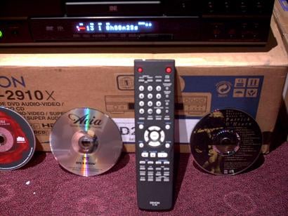

DVD-2910 Remote Control and Build Quality
The Denon RC-985 is much better than typical remotes that come with DVD players. It is very responsive,
the buttons are well laid out, and it works from long distances and even at extreme angles. It is not
backlit and that's something we think is important assuming this remote will actually get used. In all
reality, we can see most users using this remote to program a universal remote - and Denon probably
realizes this. After transferring the functions, store it away for back up or set up functions
only.

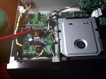

Removing the top cover of the Denon DVD-2910
revealed the heart of the DVD player. The Denon DVD-2910 is beautifully constructed with high quality
components and its board layout and design are well engineered. Please don't remove the cover from your
DVD player. I am a qualified technician with the knowledge and tools to do this.

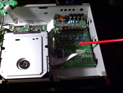

The Denon DVD-2910 uses a very robust power supply. Also note the ferrite core on the primary power cable and the size of the heat sinks!

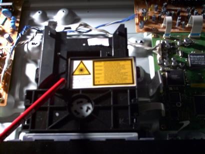

The DVD-2910 uses a very high quality transport that is mounted up high and away from heat generating sources. It is a vibration resistant design to reduce the effects of unwanted vibration from outside sources.
The DVD-2910's video board and FL2310 processor uses a 12bit/216 MHz video D/A converter. Once again very high quality components are used on this player's video board and the physical PC board was secured to the chassis with 10 screws.

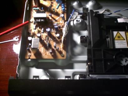

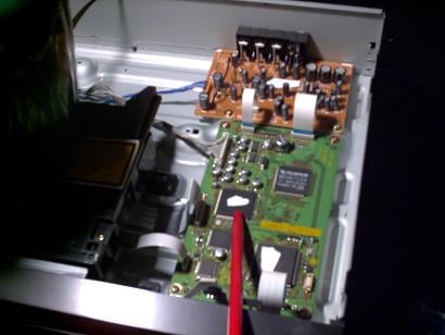

The Denon DVD DVD-2910's audio board is mounted directly below the video board. I removed the video board for a closer look and found that the DVD-2910 uses 24 bit, 192kHz DSD-1791 audio DACs, an Analog Devices 32-bit processor and 80 Hz crossover with 12dB and 24dB low pass slopes, HDCD decoder, and 24/96kHz compatible digital outputs.
Now just for perspective let's take a look at the inside of a well-known DVD player that many of the electronics chain stores sell for about $200.
As you can see from these pictures the power supply power board and general power board layout is much smaller than the Denon DVD-2910. This is the typical transport found in lower end DVD players. It is an open design that is not isolated from vibration. You should also be able to see the video board and the small audio board located just behind. These pictures, visually at least, show the difference between a higher-end DVD player and a low-end DVD player. This particular DVD player was well regarded for its price point. But in this case you really do get what you pay for. There are simply no short cuts to building a high quality player. Engineering, R & D and higher quality components cost money; and in this case the Denon DVD-2910's build quality is exemplary.

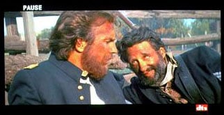

Dances With Wolves is an early
released DVD with average transfer quality. The image below is very good for evaluating DVD players. I
generally look for jaggies and flashing on the uniform buttons, moiré and image softening on the log
fence and grain and loss of detail in the background. The Denon DVD-2910 did an excellent job of
reproducing the scene. Everything looked crisp, clear and detailed with the 480p component connection.
The 1080i DVI connection looked slightly sharper but there was a hint of flashing along the log
fence.

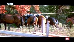

The next scene from Dances With Wolves is also very good. In this scene there is a lot of
motion, the horsetails are swinging and the leaves on the trees are rustling. There are several
straight lines to observe the rope across the horses and the fences. The background is also very
detailed and in focus. The DVD-2910 did a magnificent job of displaying this scene; there were no
jaggies, no flashing or motion blur, and the image remained crisp, smooth, and
detailed.
