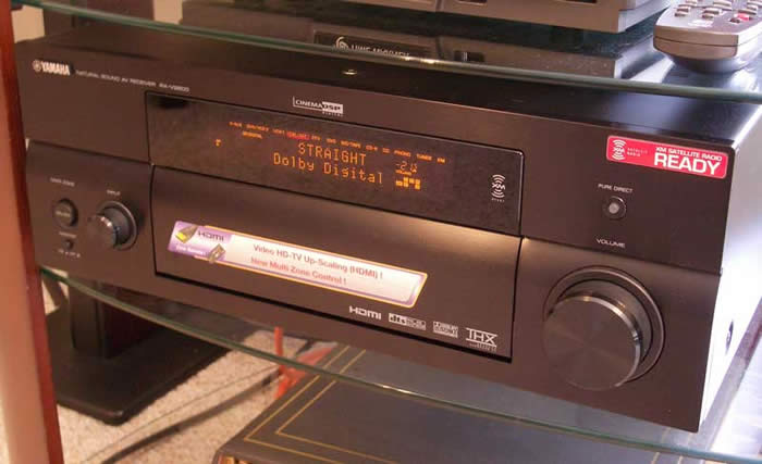

Yamaha RX-V2600 Introduction
In reviewing the new Yamaha RX-V2600 I feel like I 'm swearing in a new justice of the Supreme Court... After all, it's new and exciting, but there's also a lot of discussion and debate surrounding the newcomer. With the RX-V2600, Yamaha has entered that place where the label "AV processor" really starts to emphasize video processing. Let's face it, while there was always plenty of audio processing going on, the "video" part of the AV equation was mostly limited to switching . No longer. The new RX-V2600 breaks new ground and starts anew with a set of updated features that gives notice to the competition:
