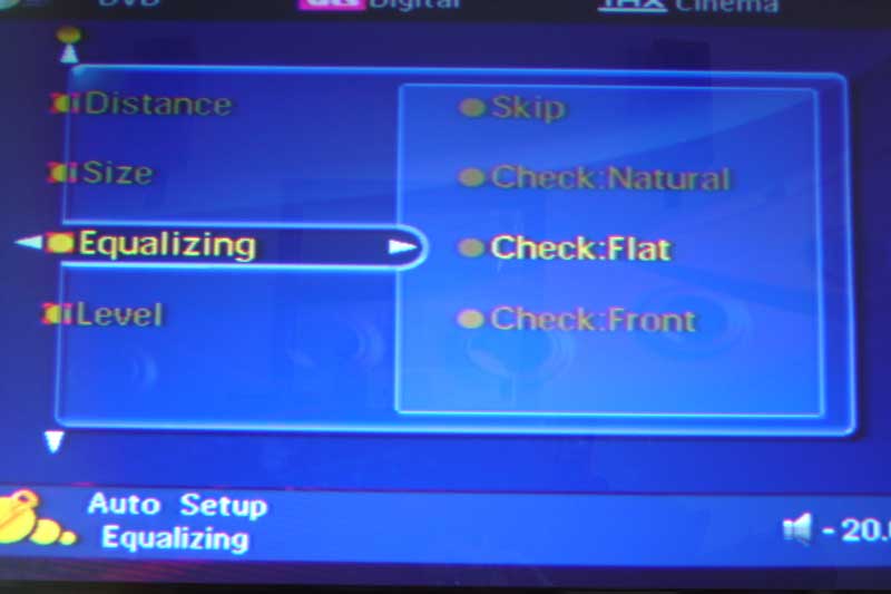

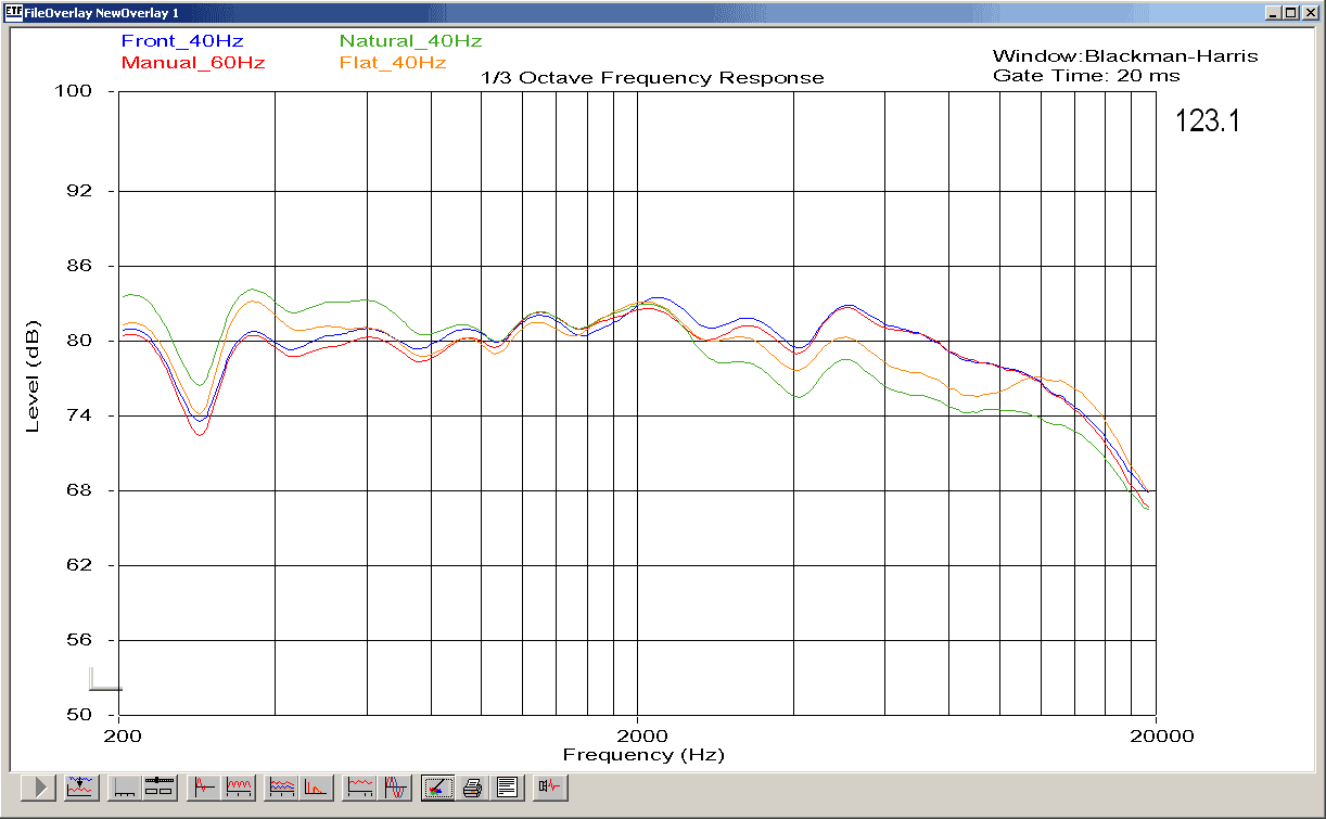

Having just reviewed the Denon AVR-3805, I was anxious to test out Yamaha's YPAO system to see if it was a more productive setup and parametric EQ option for basic room correction. I also wanted to see how well the 130 watts/channel amplification could drive the 4-ohm RBH Sound 1266-LSE main speakers which require quite a bit of power to sound their best.
