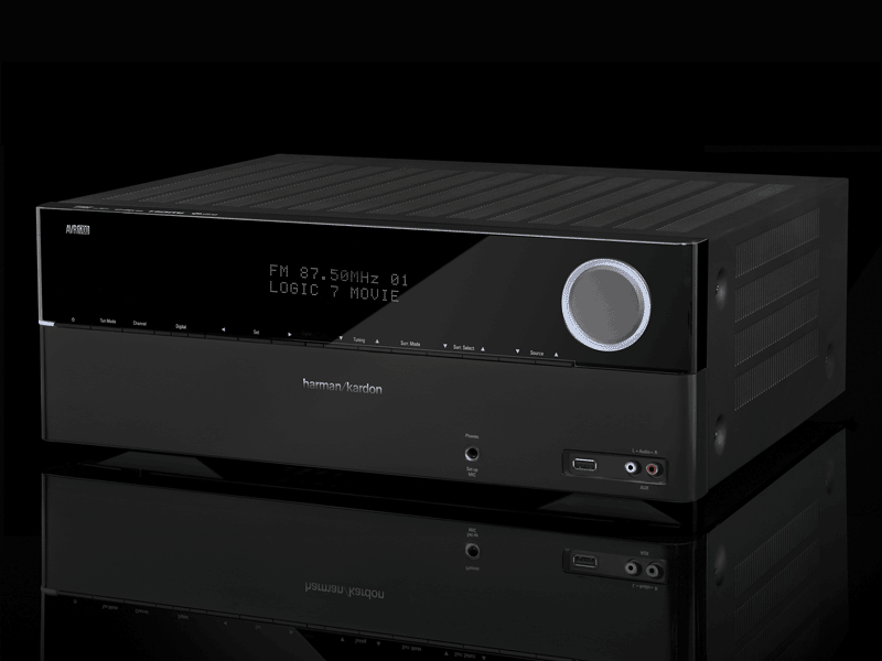

harman/kardon AVR 1700
- 5.1-channel surround sound receiver
- 100 watts per channel (two channels driven @ 6/8 ohms, 1kHz, <0.1% THD)
- 95 watts per channel (two channels driven @ 8 ohms, 20-20kHz, <0.07% THD)
- Eco-friendly digital power supply design
- Six HDMI inputs with 3D, Deep Color, and Audio Return Channel
- Dolby TrueHD and DTS-HD Master Audio decoding
- USB port for MP3/WMA music-file playback, i-OS docking, and system upgrades
- EzSet/EQ calibration
- DLNA 1.5 certified network connectivity
- HARMAN Music Manager and HK remote control app
- AirPlay
- vTuner Internet radio
- RS-232 and 12V connections
- Night mode
- IR remote control
- Dot-matrix front-panel display

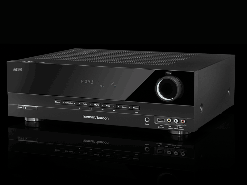

harman/kardon AVR 700 Frontpanel View
The AVR 700 and AVR 1700 receivers are both 5.1 channel configurations that support HDMI 1.4a including 3D video, Deep Color, and an audio return channel with the requisite DTS-MA and Dolby TrueHD decoding, along with the other standard Dolby and DTS modes and a number of homegrown processing modes. Other similarities between the models include five-way binding post speaker connections, a two-prong detachable IEC power cord, and a front USB port with playback of MP3 and Windows Media audio files.

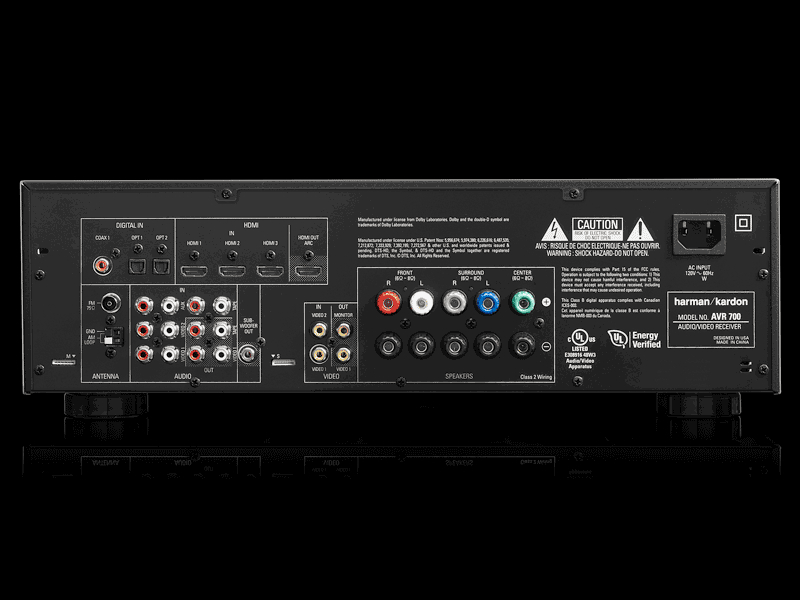

harman/kardon AVR 700 backpanel
AVR 700 Connectivity
- HDMI: Three in and one out, rear
- Digital Audio: One coaxial and two optical in, rear
- Analog Audio: Four stereo in and two out, rear, and one stereo in, front
- Analog Video: Two composite in and two out, rear, one composite in, front
- USB: One port, front

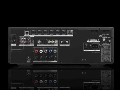

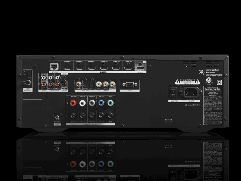

harman/kardon AVR 1700 backpanel
AVR 1700 Connectivity
- HDMI: Six in and one out, rear
- Analog Audio: Two stereo in and one out, rear, and one stereo in, front
- Analog Video: Two in and one out, rear
- Network: One RJ-45 Ethernet port, rear
The most significant differences between the two models appear on the AVR 1700 with the Ethernet port and network related functionality. When connected to a network, the AVR 1700 supports DLNA 1.5 and AirPlay as well as vTuner Internet radio. Additionally, the front USB port supports iOS device docking, the AVR 1700 can be remotely controlled using Android and iOS devices by downloading HK remote control app, and Harman also provides a music manager app for the receiver. Other feature differences found on the AVR 1700 include EzSet/EQ setup/calibration, RS-232 and 12V trigger connections, and a learning remote control for up to five other devices with an extensive list of compatible device codes included in the users manual.
