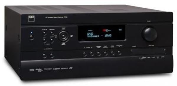

New Acoustic Dimension, NAD Electronics latest entry at the flagship A/V receiver level is the T-785 Surround Sound Receiver. Clad in classic NAD charcoal gray, this 56 lb receiver boasts a dual toroidal transformer power supply that is rated at 120 watts full frequency range power into an 8 ohm nominal impedance. The T-785 also features modular construction of the pre/pro circuitry that is billed as future proofing for the receiver, that can perhaps eliminate the need to otherwise replace a more than satisfactory power amplifier section just because Hollywood wants to resell all of their movies in a conveniently, for them, incompatible new format.

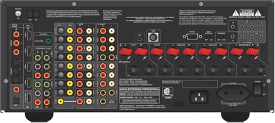

The pre/pro section of the T-785 is built on a modular design with six removable boards that provide all of the processing and connectivity. Four of the boards provide all of the analog audio and video input/output connectivity that are divided into: HD component video, SD composite and s-video, two channel audio, and multi-channel audio. The remaining boards, currently the AM200 and the VM200 in North America, provide digital audio and video processing and connectivity. Additionally, the T-785 also supports a number of custom installation features and includes an RS-232 port and a contingent of IR in/out triggers.
A/V processing on the T-785 is handled by a dual core, 32/64 bit Texas Instruments Aureus digital signal processor. The DSP is supported by five two channel Burr-Brown 24 bit/192 kHz D/A converters, a multi-channel Burr-Brown 24 bit/192 kHz A/D converter, and a Sigma Designs VXP image processor. The T-785 provides support for all current digital audio formats including lossless Dolby TrueHD and DTS Master Audio. The T-785 also provides a full compliment of Audyssey functionality including Auto Setup, MultEQ XT, support for MultEQ Pro, Dynamic Volume, and Dynamic EQ. The Sigma Designs VXP video processor used in the T-785 features a programmable scaling engine up to a maximum 2048 x 2048 pixels resolution. With present video specifications, the T-785 supports up to 1080p video resolution with upconverting, aspect ratio conversion, analog to digital video transcoding with HDMI output, NTSC/PAL video format conversion, as well as a host of other features.
The analog audio modules for the T-785 include the full range of standard connections. This includes 7.1 channel input and 7.2 channel preamp output, 6/1 (rear/front) stereo inputs, and 3 stereo outputs including a zone 2 out. The analog video modules provides three component video inputs, one component output, and 5/1 (rear/front) composite/S-video inputs and four outputs including monitor and zone 2 out. The front panel, in addition to the auxiliary audio and video inputs, also features a headphone jack, an analog media player input jack, and an auxiliary toslink connection.
The AM200 audio module provides traditional digital audio connections for coaxial and toslink with three of each for input and one of each for output. The VM200 module provides HDMI v1.3 connections with 4 inputs and 1 output. Additionally, the VM200 provides a port for connectivity with a separate iPod dock. From the NAD website, future upgrades for these cards appear to include an updated VM module to support HDMI v1.4; assuming home 3D ever really takes off.
