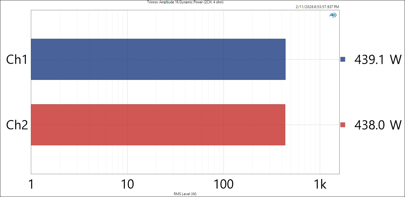

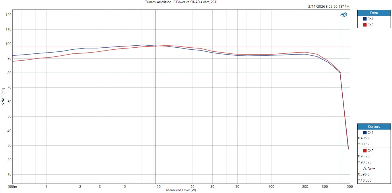

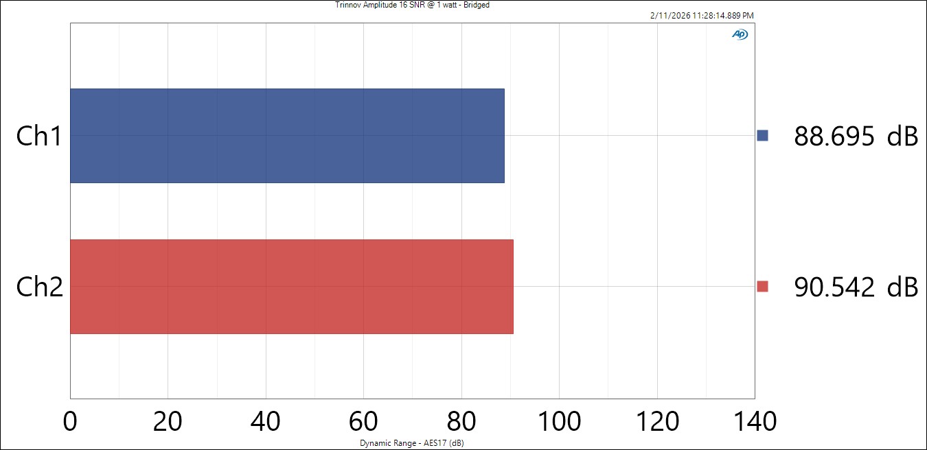

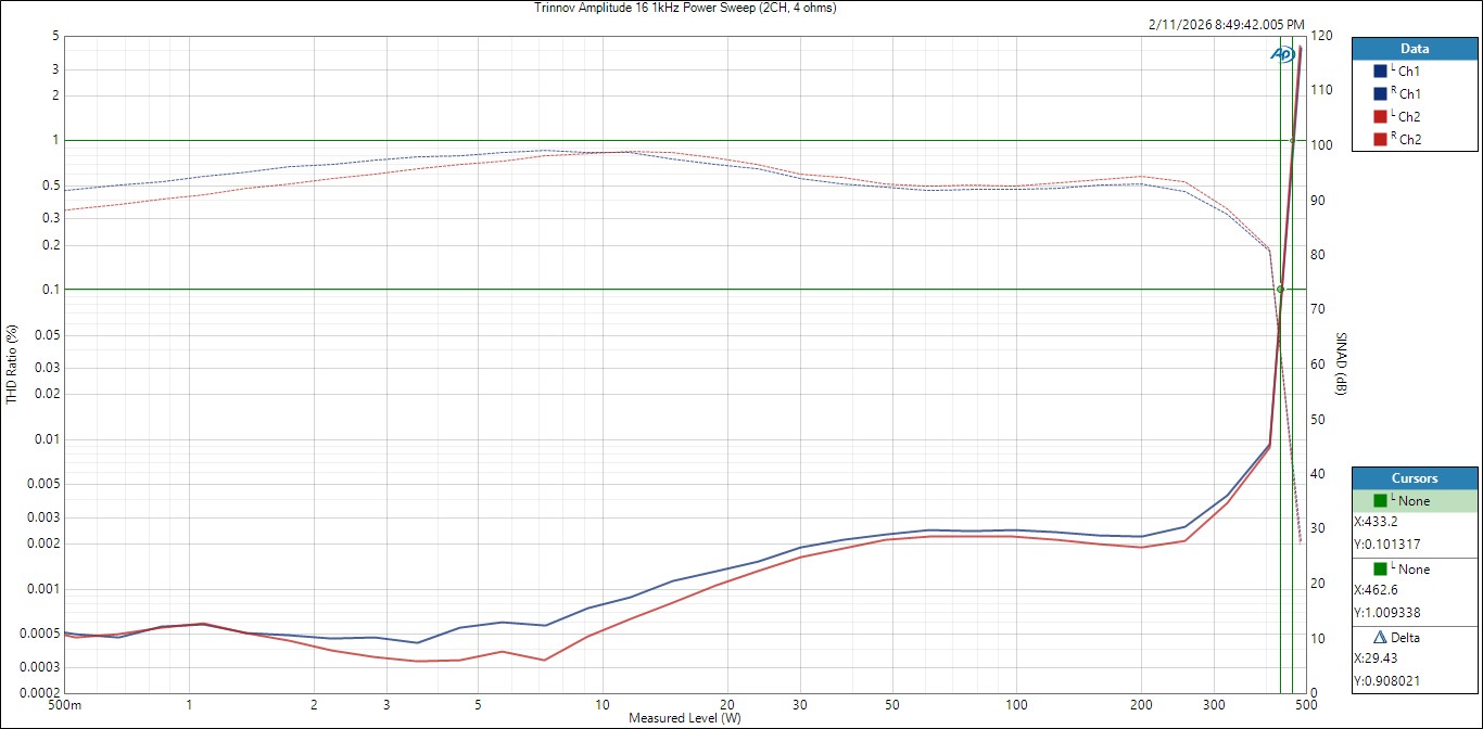

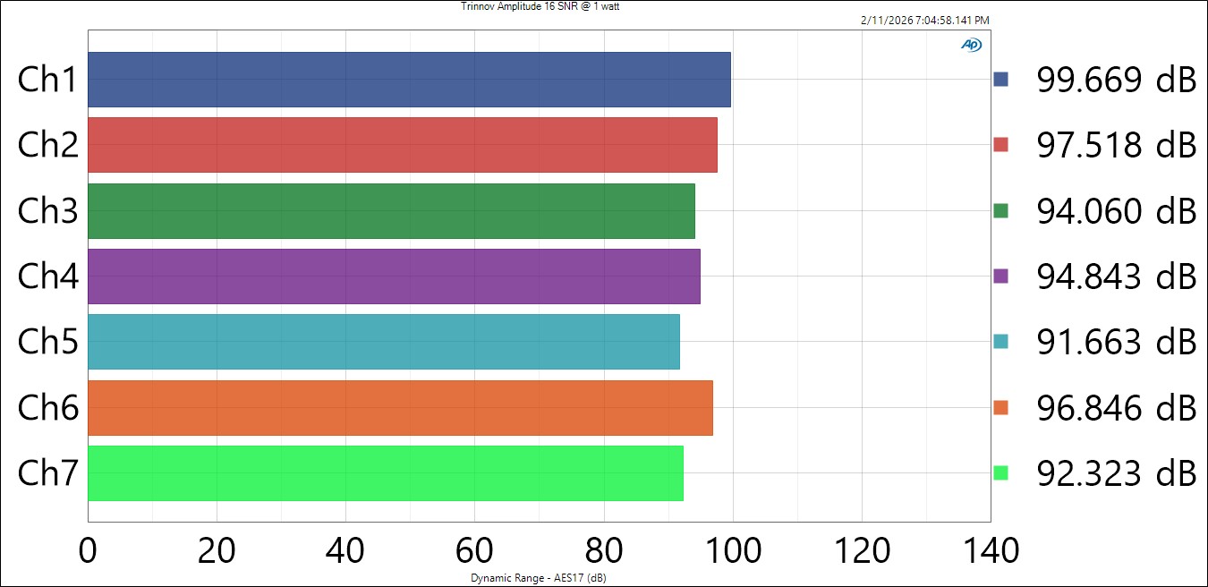

The Trinnov Amplitude16 is one of the most powerful 16-channel home theater amplifiers on the market, rated at 200 watts per channel across all 16 channels. In our detailed test report, the Trinnov Amplitude16 demonstrates exceptional headroom, producing up to four times its rated power when channel pairs are bridged thanks to its ICE Edge Class D modules and dual 1600-watt SMPS power supplies. We also compare its measured performance against the Marantz AMP 10 and StormAudio PA16 to see how today’s top 16-channel amplifiers stack up. Dive into the full bench test to see which multichannel powerhouse comes out on top.

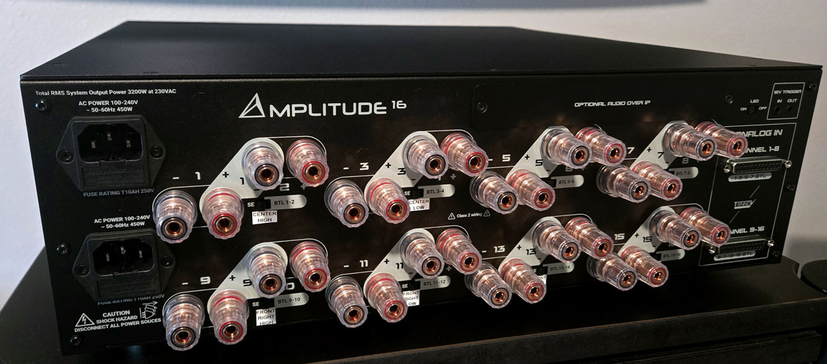

Trinnov Amplitude16 Backpanel

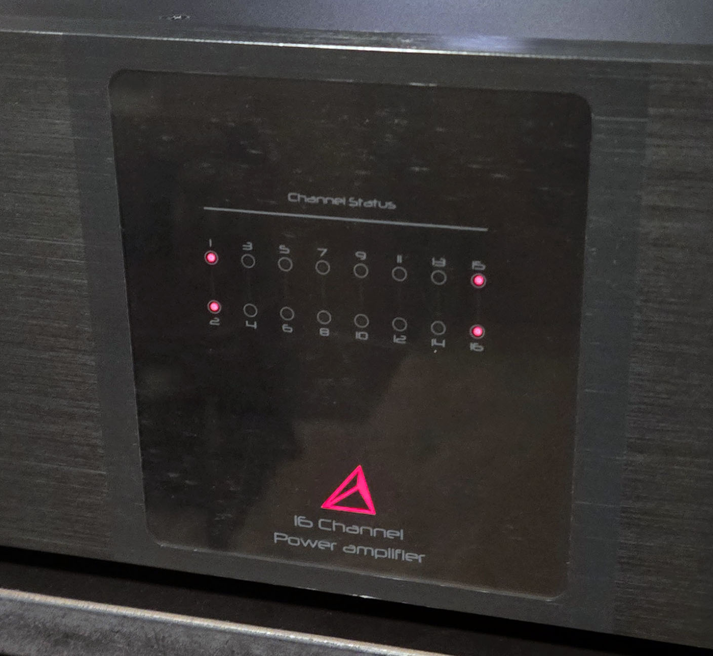

Trinnov Amplitude16 Fault

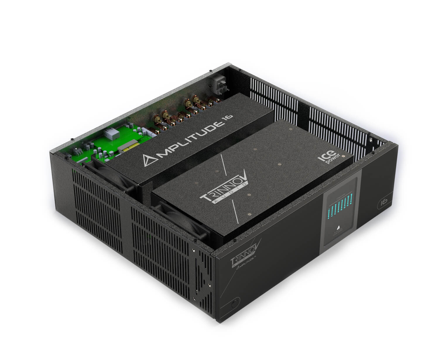

Trinnov Amplitude 16 Top View

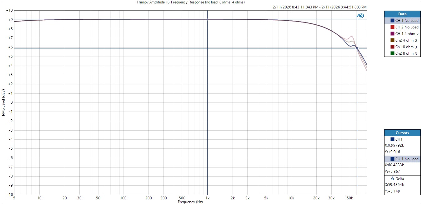

Trinnov Amplitude16 Load Conditions

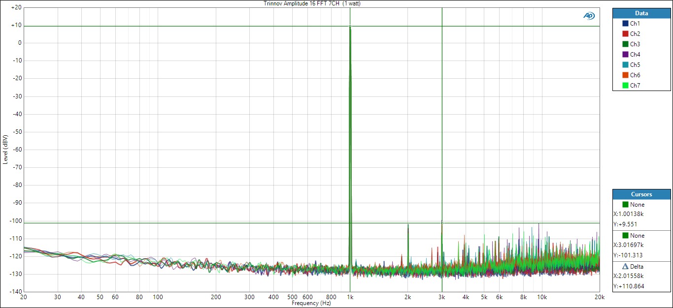

Trinnov Amplitude16 FFT 1watt

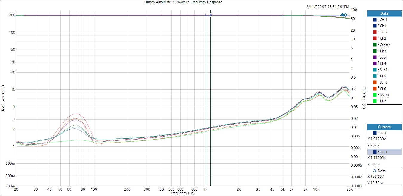

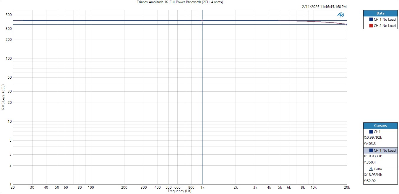

Trinnov Amplitude16 Full Power BW
Trinnov Amplitude16 Full Power BW 4 ohm

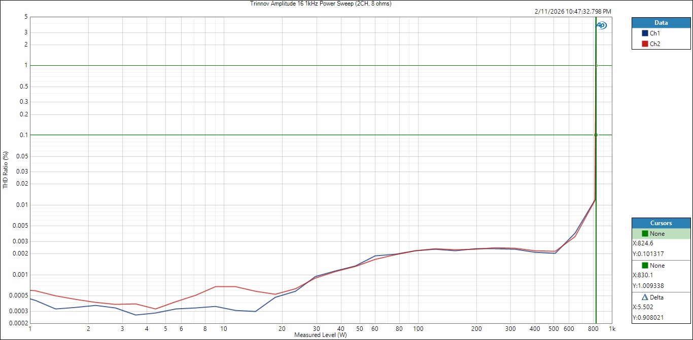

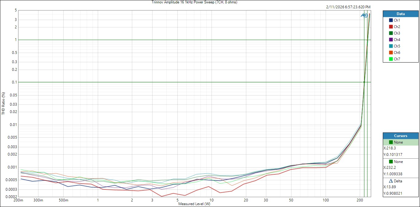

Trinnov Amplitude16 PSweep 7ch 8ohm

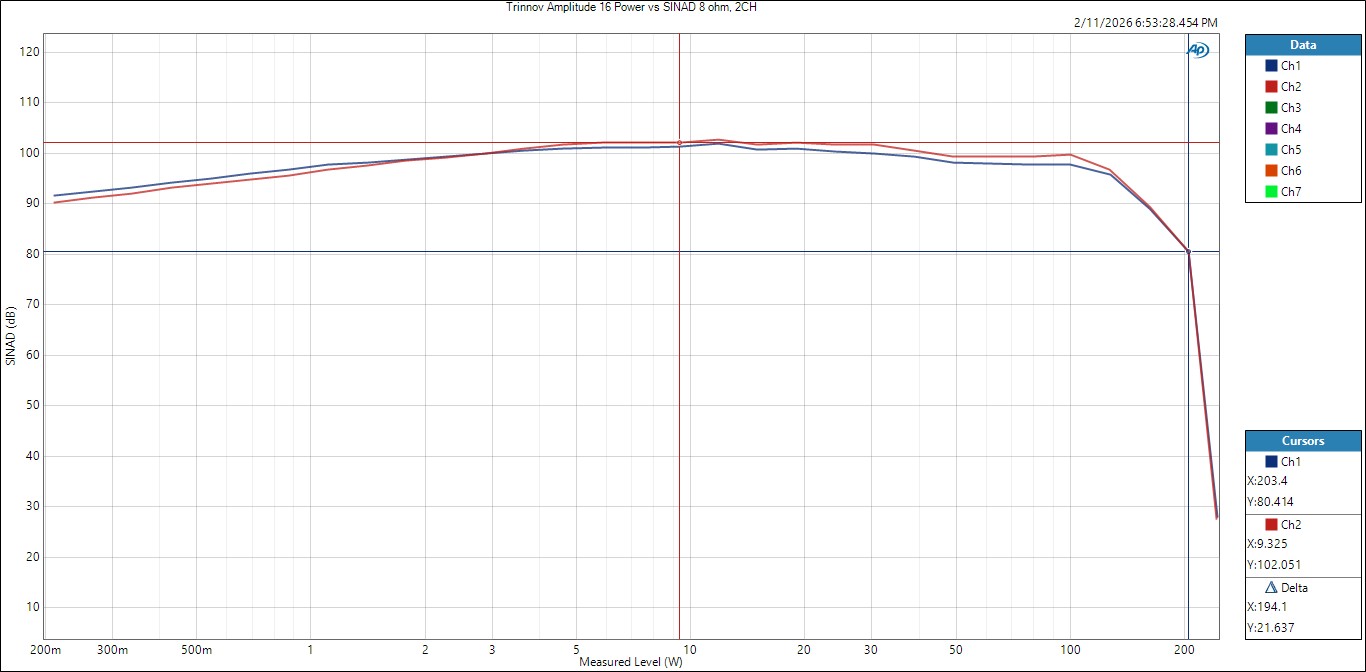

Trinnov Amplitude 16 SINAD 2ch 8ohm
Trinnov Amplitude16 Psweep 4ohm
Trinnov Amplitude16 SINAD 4ohm

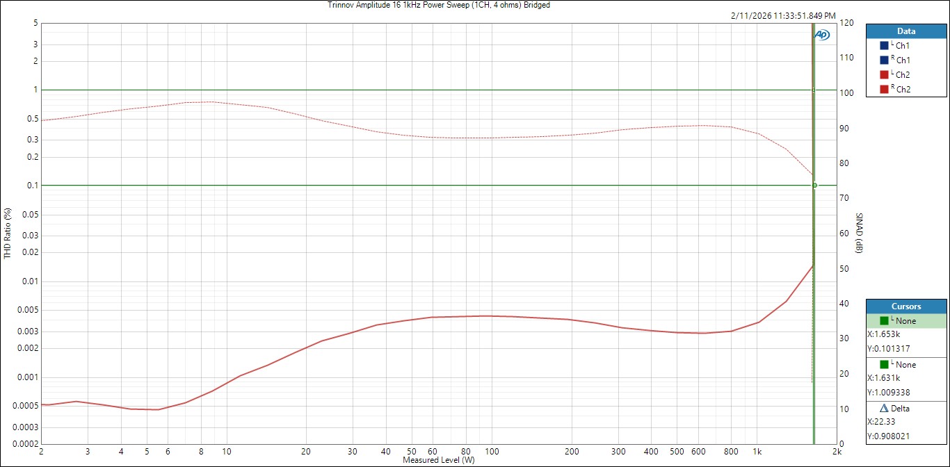

Trinnov Amplitude16 Psweep Bridged 4ohm
Trinnov Amplitude16 Dynamic Pwr 4ohm
Trinnov Amplitude16 SNR 1watt
Trinnov Amplitude16 SNR Bridged

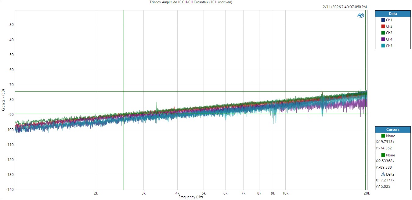

Trinnov Amplitude16 XTALK

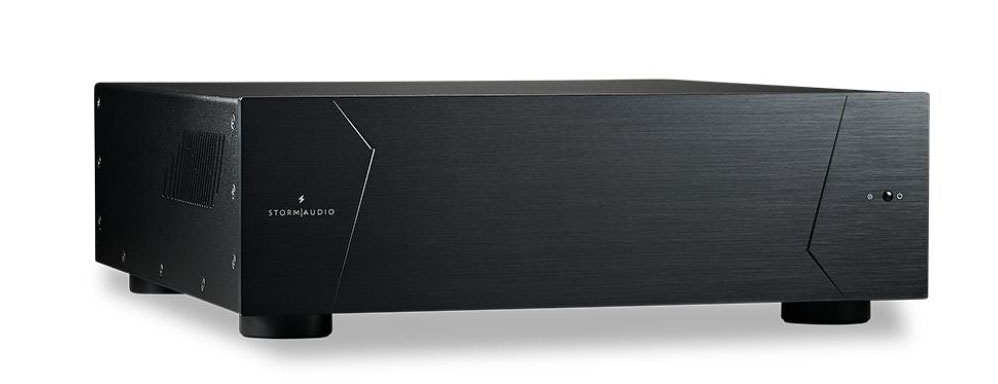

StormAudio PA16
Marantz AMP10

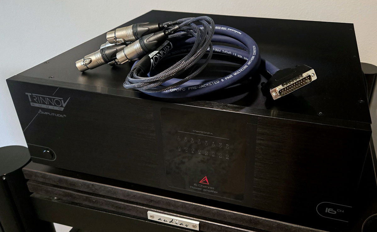

Trinnov DB25 cable
