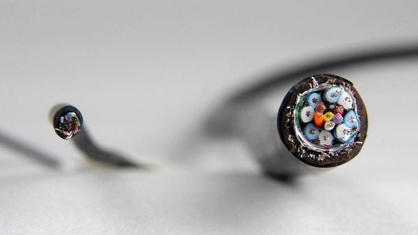

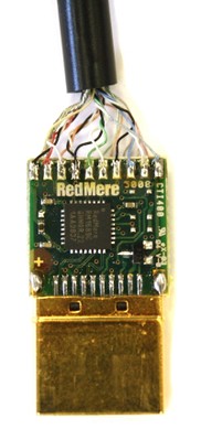

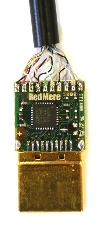

But now, HDMI cables developed with RedMere technology are taking a different approach. The cables are downright thin - and I'm talking super-thin, with wires that measure just 2.5mm in thickness. The cables contain Redmere's MEA1689 Integrated Chipset that allows sustains speeds of 3.4Gbps per channel (10.2 Gbps total). The MEA1689 is a compact module which fits inside the sink-side (display-side) casing of an active HDMI cable assembly. The cable is actually directional, so you have to pay attention to the markings to make sure the electronics are on the display/sink side.
redmere internals
MEA1689 Chipset Features:
  • Separate data equalization performed for each channel for up to 3.4Gbps
  • Clock equalization up to 340MHz
  • DDC rise time accelerator using active I2C accelerator device
  • Contains RM1689 devices for HDMI active cable equalization
  • Low power
  • No external power required
  • Supports up to 40m 1080p
  • Module size 15mm x 26mm

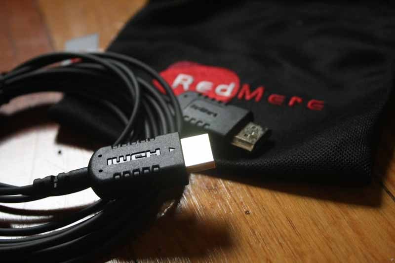

The sample cable we received can safely bend a full 180 degrees within a 3/4-inch radius. That's amazing. It's also got a HDMI connector at each end that is only 1-1/2" long, not including the 3/4" of strain relief. RedMere claims that this amounts to about a 75% reduction in cable size and weight.
