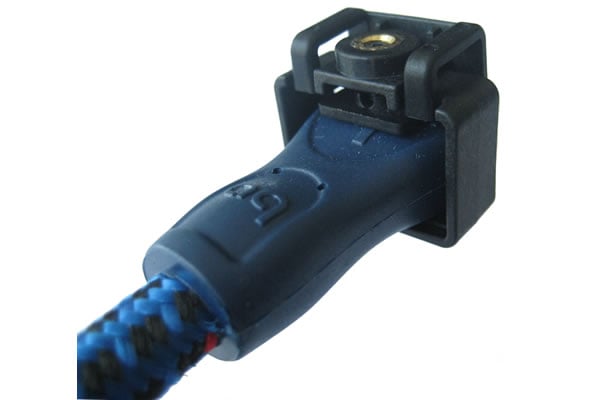

Lindy Connector Lock for HDMI Cables
Lindy decided to manufacture a nifty HDMI Connector Lock that overcomes the limitation caused by a lack of screw-down connections for HDMI's flawed form factor. Unfortunately, their solution is one that is designed to be used in conjunction with their Premium Gold HDMI cables and not a universal solutions. That's too bad since the market may have gone gangbusters over a third party method of fixing existing cables. Lindy's Connector Lock is manufactured from a thermoplastic polymer which, when warm, easily slips over the HDMI connector and forms a tight fit as it cools down. A built-in thumbscrew then allows the cable to be secured to most typical HDMI face plates or a suitably equipped HDMI device (those with a fixing screw located just above the connector).

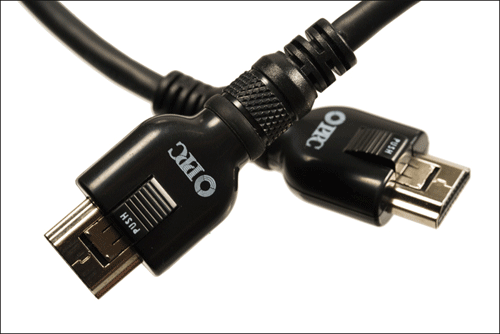

Ottovonmo/PPC (Perfect Path) Locking HDMI Cables
Ottovonmo (and also PPC or Perfect Path) have developed a line of HDMI cables with built-in retention and also a series with PerfectLock technology that provides up to 25 lbs of retention in the port. Their technology doesn't transfer the strain to the chassis, but it does offer a significant step up from the normal HDMI socket connection. This technology is built right into their 600, 700, and 1000 series of cables. What's unique about PPC is that they are one of only three companies that have garnered the approval of the HDMI Licensing Group (the others are Torrent (see above) and a UK company, Polar Creative. With that said, we hardly think anyone should wait around for HDMI to deliver their blessings as the company, in our opinion, is the one responsible for the mess of a connector that is HDMI. If anything, HDMI should have standardized a much more effective connection in the first place, and most certainly should have come in at a later date with its own suggestions for improving the physical standard to offer options for strain relief.

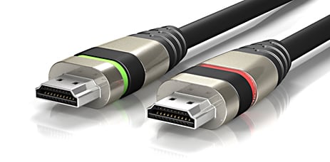

PolarCreative Locking HDMI Cables
PolarCreative's solution to the HDMI tension dilemma was to construct a new cable connector that took advantage of the integrated tensioning pins already present in HDMI. Their solution uses a sliding sleeve to push the pins into a locked position, transferring the cable's weight to the receptacle. The only downside to this (and other solutions approved by HDMI Licensing, is that it does nothing to transfer the strain relief to the chassis. The somewhat fragile HDMI receptacle is still susceptible to this strain, though to-date all of the solutions heralded by HDMI Licensing employ this methodology (which favors universal appeal and compatibility over security or strength. PolarCreative's HDMI cables are by far the most slick-looking of the enhanced tension format that we've seen. It's clean, almost futuristic oval shape and sliding sleeve design put it at the top of the cool-looking locking cable list.
