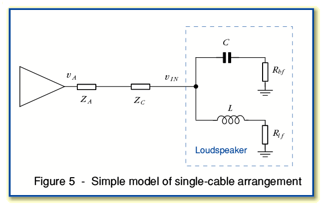

When using the loudspeaker modelled here we can now represent the situation when employing a single cable (i.e. not bi-wired) by the circuit shown in Figure 5.
Here we can represent the output impedance of the power amplifier as a series impedance, , and the impedance of the cable by . Note that does not represent the characteristic impedance of the cable as a transmission line. It is simply the series resistance and/or inductance of the cables being used.
When the amplifier asserts an output (a.c.) voltage of this will result in a voltage, , appearing at the loudspeaker terminals. In this simple case we know our loudspeaker has an input impedance (tweeter and woofer sections linked in parallel) of . Hence we can say that
equation
In situations where the cable and amplifier impedances are frequency dependent (and not simply resistive) this will lead to a frequency-dependent degree of attenuation, and some relative phase dispersion. However if and are substantially resistive and independent of frequency the main result is a small reduction in the volume of the resulting sounds. The total load seen by the amplifier will be at all frequencies in this situation. Hence the power efficiency of the system at all frequencies will be proportional to .
The circuit is a fairly simple one and has only one current node. This means we can immediately say that
equation
where is the current being produced by the amplifier at any instant.

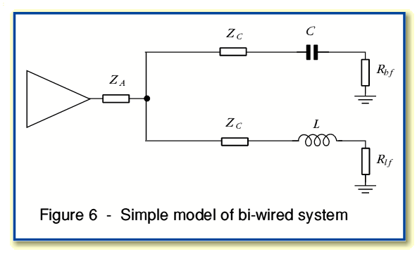

The situation when using a bi-wiring arrangement may be represented by the circuit shown in Figure 6. For simplicity it is assumed that the two cables are identical.
As with the previous case, if we assume the cable impedances are essentially resistive then their effect is to increase the total resistance seen in the high-frequency and low-frequency ‘arms’ of the circuit by the same amount. At first sight this seems to imply that we have essentially just altered the overall load by the same amount as before. However this may not be the case as the presence of the separate cable impedances will independently affect the nominal turn-over frequencies of the low-pass and high-pass networks employed. The special case we initially envisaged was that the turn-over frequencies (as well as the load resistances) of the two arms were identical. This meant their parallel combination was purely resistive. However we may now have ‘unbalanced’ the arrangement so that this is not longer true.
As with the single-cable arrangement, the system illustrated in Figure 6 has a single node. Hence we can say that the power efficiency will simply depend upon how may vary with signal frequency. We may therefore look to see if the total load impedance now varies with frequency as if it does, this implies that the above bi-wired arrangement may be expected have a frequency response that differs from that produced with a single cable.
