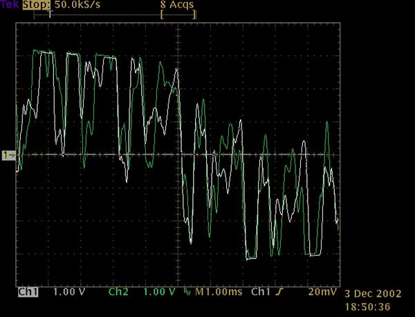

One of the major problems that have cropped up in many of the pop music releases in the past 5 to 6 years is level control. I have painfully listened to my step kids CDs and heard the shrilling sounds they conveyed. I wasn't surprised when I hooked up the CD player's analog outputs to my oscilloscope and observed levels so high that they were clipping on a consistent basis. One normally thinks of clipping as a power amplifier problem, yet clipping in the digital domain can be just as bad. But before we go further let us define a basic explanation of what digital clipping is and how it relates to audio applications.
We know that if we overdrive an amplifier the amplifier will limit the signal and we typically see a flattened peak at the output. This is called clipping, and thus results in gross distortion. When we try to drive a CD player past the 0db full-scale point, two things can happen. The CD player will go into clipping just like an amplifier or some players (due to their digital filter/converter structure) can have a little more headroom above 0db full scale. If we drive them a little harder they will go into clipping also. CD players differ in one major respect from amplifiers. At 0 db full scale the player is at its lowest distortion; anything above that whether it is clipped or not results in gross distortion. The author knows of no CD player that can exceed 0 db full scale without gross distortion. If that's the case why are we seeing this happen on a great majority of recently released CD's?

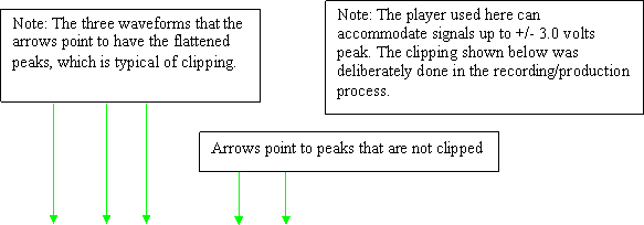

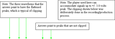

This oscilloscope photo was taken from a recent Jennifer Lopez Pop CD release . The author has found this to be typical of many new pop music releases:
