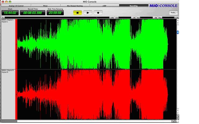

The next CD that is up for inspection is the Joe Zawinul CD Brown Street with 15 members of the WDR big band. I am listening to the fourth track titled Badia/Boogie Woogie Waltz and the solos are staying at one consistent loud level. I look at the peak level meters and they are staying constantly at about –2dbfs with plenty of 0dbfs readings. I hear the 15 or so members of the WDR big band come in after one long solo and the levels don’t change. Well this is certainly sounding like hyper compression to me. I just didn’t think you could actually compress music to a 3 db dynamic range. Once again I connect my oscilloscope and sure enough I see plenty of peaks digitally limited and going right to 0dbfs with a healthy amount of intersample peaking going above that. I find that with material such as this using the digital attenuator on the Winamp EQ set to –3 db (which actually measures –2.75 db) makes material like this somewhat less obnoxious, but I am left with the sad conclusion that hyper compression has come to Jazz.
The scope shot below is a partial representation of the right and left channel of the track titled Badia/Boogie Woogie Waltz from the CD Brown Street by Joe Zawinul.
Compression
