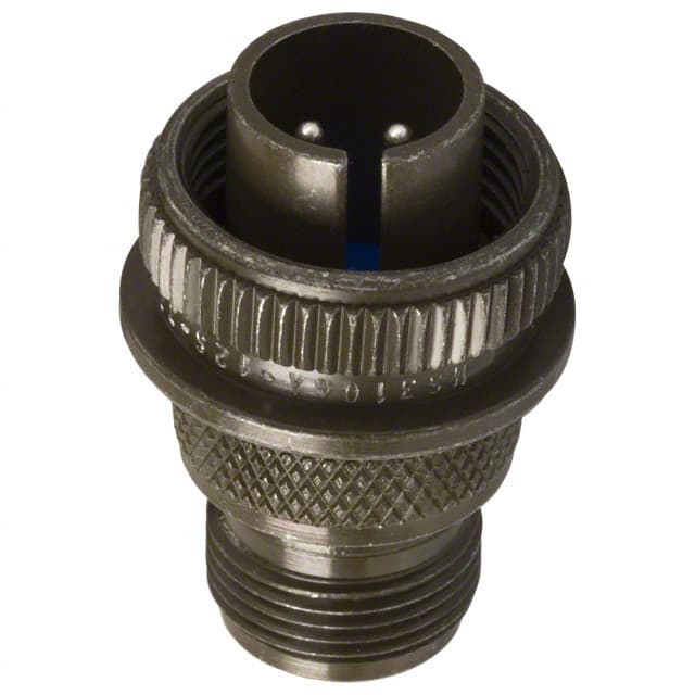

That picture really helps.
That is a 2 pin amphenol female connector. You need the male companion. They used to be common on industrial gear like PA amps.
They are still available and Digi-Key have 55 in stock.

All two pin Amphenol connectors are off set slightly, and so are the ones I specked for you. I specked the correct connector for you. If you look at the pin diagram on the site, you can see they ARE the male plugs that you need.

ALL those two pin amphenol speakers connectors are off center, so you can't get the speakers out of phase. They HAVE to be in the correct orientation to be able to insert them. Having them reversible would make no sense. I have never seen one that you could reverse. In any event those connectors are long discontinued, and what Digi-Key have are old stock. So my advise is to by them. If it should happen that they do not work, then you will have to mount different speaker sockets, like Neutrik on your unit. You will have no other option.

Unfortunately when I received them they are larger than what is on the projector.
Not the same plug as needed.

The Ampenol plug barrel part is about 1mm to large. Fine, i can put that in my lathe and machine it down, but it would still not help.
Reason is the ring that secures it has a thread way different and WAY too large. It is about 2mm in diameter larger than what is on the projector.
This is clearly NOT an Amphenol connector that is on the projector.
See images, quite different.
