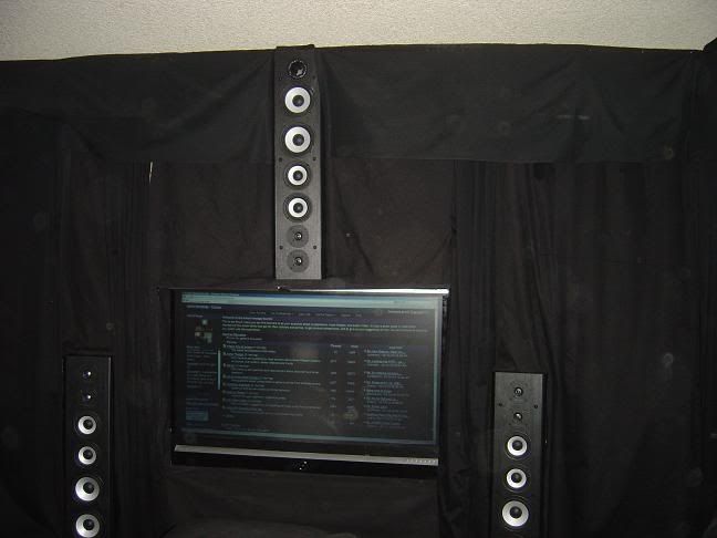

chriscmore said:
It's possible that no center channel (using just L/R in a phantom center configuration) would sound better than using duplicate centers. Experiment and see, but don't spend non-returnable money on this approach.
That was my experience when I experimented a while back. A few drawbacks I found to running a phantom center was soundstage collapsing to the side you’re sitting closest to. Not being able turn up the volume on the center channel separately. And not getting any center channel info coming from the mains when using analogue inputs.
NeverSeen said:
I gather that it would be better to set my center up vertically than leave it horizontal. Because my center is designed as being horizonatal will it not benifit me to set it up on its side?
If you have room for a horizontal center turned vertically you might have room for another main above the TV. After experimenting with almost every center channel configuration I could think of I realized I could fit another main upside down above my TV and found center channel nirvana. (eventually I’ll get a projector and screen but the apartment is a bit small for that).
Trying a MTM center vertically above the TV did pull the soundstage up like chriscmore mentioned, however this didn’t happen with the main up there probably because the tweeters were still just above the TV where a normal center would sit. The only difference I notice in the sound field having the center tower above the TV than in front of it and level with the mains is a much more expansive front soundstage. The sounds emanate from the TV but expand and produce a wall of sound up front. Very neat.
Also as chriscmore says, aesthetically it was a bit much at first. After having it there for a while it still looks just wrong, but it sounds just right so who cares how it looks.

morkys
Interesting approach with the tower speaker upside down set above the plasma. Totally impossible with a projector unless you use an acoustically transparent screen, and then there is no need to have the speaker up so high.
Agreed. I bought the tower center originally in anticipation of getting a projector and acoustically transparent screen when I buy a house. I decided there was no use using a traditional horizontal center when I figured out I could fit a tower up there. To my surprise I found out it sounds excellent. The tweeters are only separated 8 inches vertically so pans across the front are smooth. At the same time the vertical separation of the other drivers creates a wall of sound which helps open up the front soundstage, something I find nice since I have to sit so close to the screen/speakers.
Grunt - Try placing your L/R up on study little platforms. Often speakers sound better raised a few inches off the floor, as it decouples them mechanically and you reduce the bass wave reflection from the floor. It might make them too lean if it's too high, but trying that may even out your front soundstage without having to resort to lowering your TV. If they're crossed over to a sub, you may not notice any change other than image location. I think it might reduce the "mudbass" and clear up any chestiness sound in the 80-250Hz range.
Free to try...
