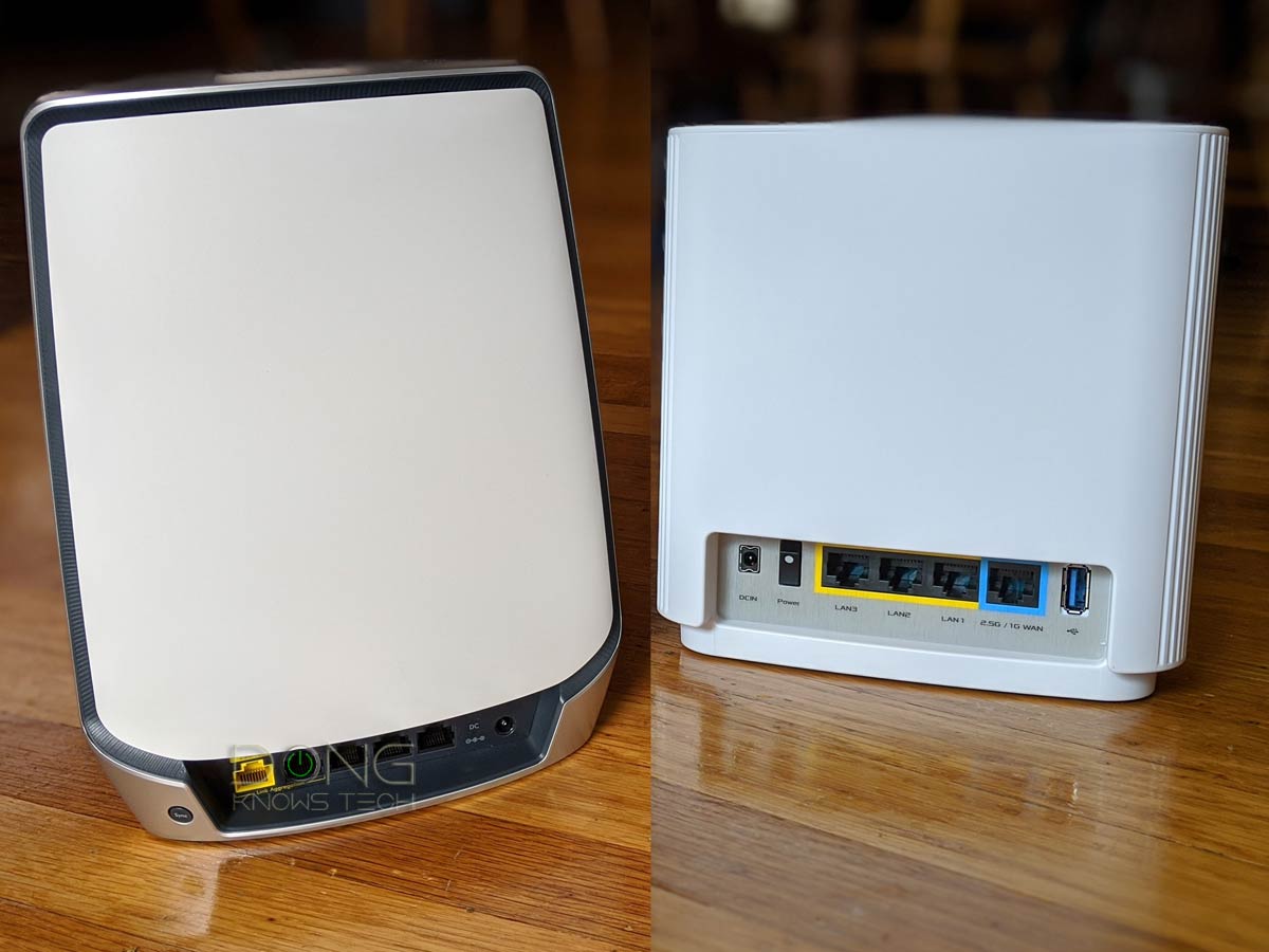

I will say this: I am not familiar with XT8. I've found a pretty comprehensive review here:
wireless uplink channel or as Asus calls it a backhaul - is a WIRELESS connection used by Wirelessly attached Wifi Access point aka Mesh.
Gotcha. Backhaul I get. :)
I read a lot of reviews of all the current crop of Wifi6 and 6e mesh devices, including reviews on DongKnows. The nice thing is that Asus Zen XT8 seems very well liked by most. And it works pretty well so far!

Just fiy: For some stupid reason, Mesh router makers always choose 5ghz band for backhaul as it's much faster, BUT 2.4ghz has better range/wall penetration, so - go figure.
Trebdp83
That's the rub. I let my wi-fi AX/6 router mix the two as needed using Asus Dual-Band Smart Connect. I nearly set up Mesh nodes but decided against it. But, I'm not dealing with as big an area as others may be.
