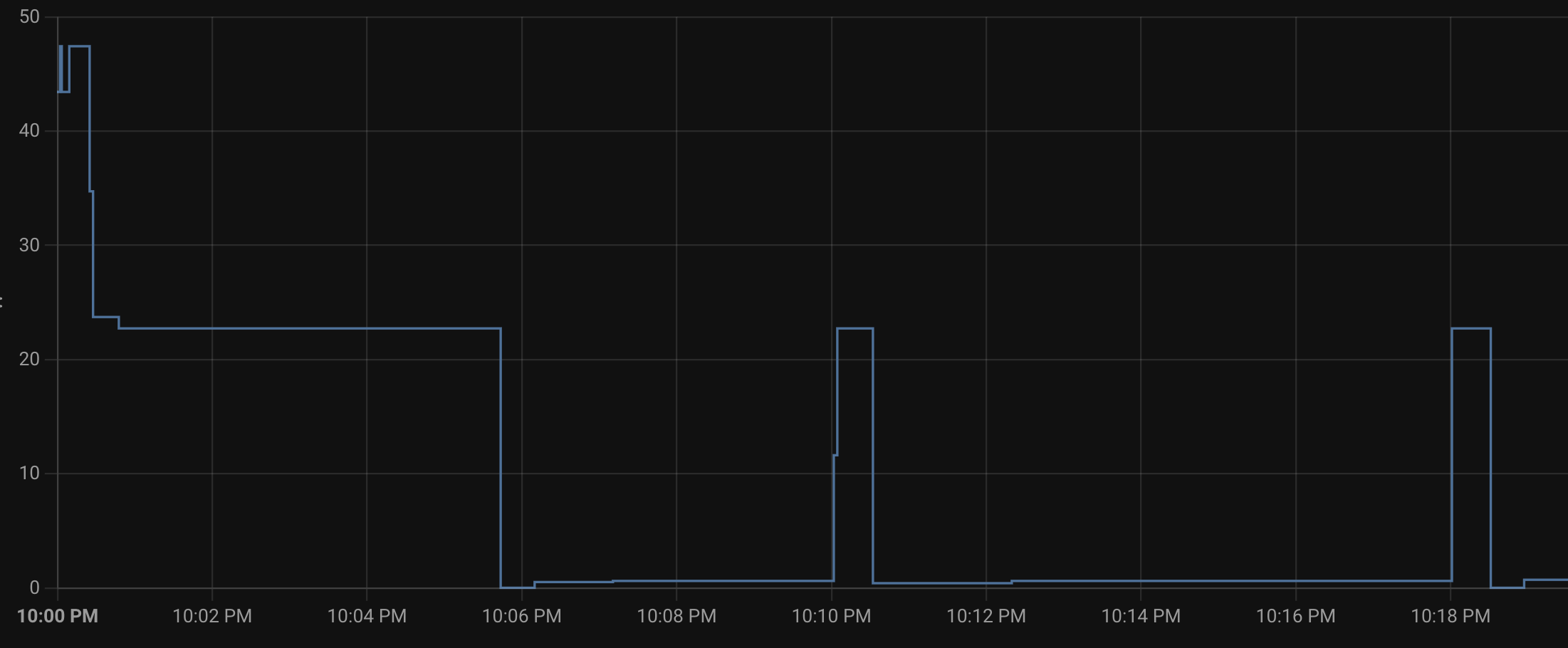

for those who want to support me finding root cause of this issue - here is recommended sequence of testing
setup
- Sony Android TV connected to AV-receiver (ARC) via HDMI - eco mode enabled - otherwise TV will remain at 22watt and not go to standby
- audio source connected to AV-receiver via HDMI
1. play audio via HDMI e.g. from BlueRay / use nice relaxing music ;-)
2. turn-off Sony Android-TV with remote
3. verify that Sony Android-TV is in standby - connect something with LED to USB. you may use a Kill A Watt to verify. standby is approx. 0.7watt.
Picture shows the wakeup peaks...where audio drop outs occur.
4. listen to music if audio drop outs occur...

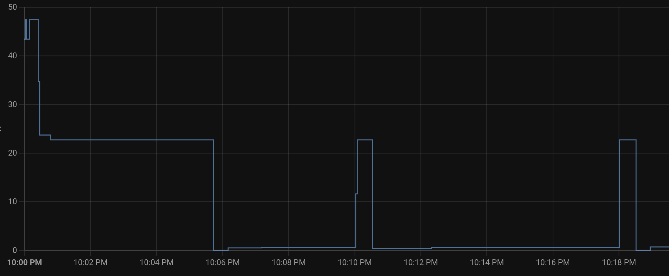

sequence of testing
setup
