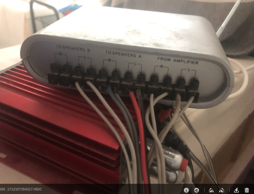

I have an amplifier connected to a switch, sending audio to pair A speakers which work, however pair B outputs no audio?
I haven't yet tested the cables from the working amplifier switch, swapped around and things.

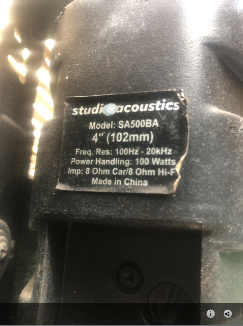

The speakers in question are:
  • Studio acoustics
  • SA500BA
  • 4” (102mm)
  • Freq. Res: 100Hz - 20kHz
  • Power Handling: 100 Watts
  • Imp: 8 Ohm Car/8 Ohm Hi-Fi

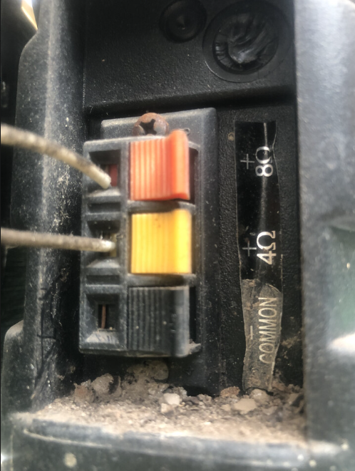

Red connect button: +8 Ohms
Yellow connect button: +4 Ohms
Black connect button: -COMMON
Q1: I'm wondering if there's a test I can do, like a multimetre test, but how much power (amps, volts, watts) should the cables have?
Q2: Is there a general rule of ISO standard on which cable connects to the Red and Yellow connect buttons? E.g. the speaker cable is a pair with grey and grey with a black stripe. I connected the grey with a black stripe to the yellow connect button, as black is associated with ground and red is associated with power.
  • Studio acoustics
  • SA500BA
  • 4” (102mm)

The common terminal is the Negative, the other two are for Positive. Move the wire from the 4 Ohm terminal to Common.
E
eiger3970

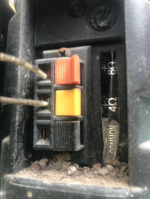

Thank you, removed the grey with black stripe cable from the yellow connection and inserted into the black connection, however the issue remains.
I checked the switch by swapping the B speakers cable positive and negative, but no audio.
Is there a way to test the cables for voltage, as moving the wires into the working speakers is a major hassle.
Sorry, the old outdoor speakers had some wasp mud nests that had to be crushed.

I'd pull the speakers and take them to another system to make sure they work, outdoor speakers that would be my first suspicion aside from maybe corroded connection or something. Hidden wiring could be chewed by rodents.

Thank you, success. The outdoor speakers are alive on the indoor speaker wires, but no audio on the outdoor wires.
Therefore, the outdoor wires or the switch is faulty.
So much for a 20 minute fix, a week long project now.
