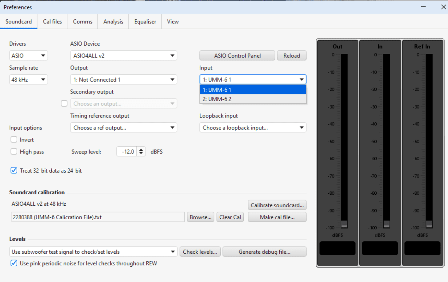

I have a separate issue that I’m stuck on tonight.
On the REW Preference Soundcard page, I am having an issue with my Output showing “Not Connected” I’ve spent a couple hours trying to figure it out with no success. How do I fix this?
I also added the UMM-6 mic and the input gives me 2 options, a 6 1 or a 6 2. Which do I choose?
