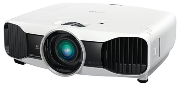

That said, the Epson 5020UB is a beast and quite a good projector. It will look better than a brand new BenQ TH575 ($500) for sure.
There are other models out there as well which fall into this category and perhaps budget. But, it is not exactly new having been released over 10 years ago. Still, it holds the similar form factor to the current 5050UB, so it's not that crazy of an idea. Just make sure if you pick anything up, that you test it thoroughly prior to taking ownership or getting stuck with it.
I would say a model like the Epson 3800 for about $1,300 refurb probably wouldn't look one bit better than the 5020UB, it just offers a warranty and cheap replacement lamps.

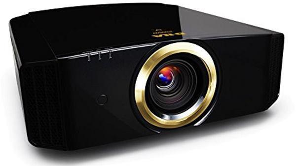

I'm thinking a used Epson 5030ub or the JVC model (or similar) you gave as an example. I don't think I can swing a 5040ub right now. They seem to be going for a lot more. Do you recommend any other comparable JVC models?

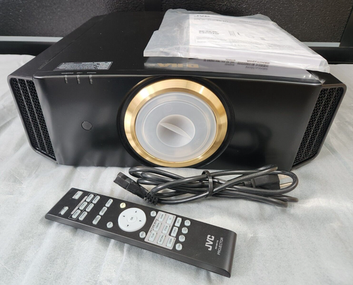

Between the JVC and the Epson which would you recommend for a controlled light room 120" 16:9 screen with 11' viewing distance and 13.5' throw? Projector central doesnt have ANSI lumens or calculator for the JVC. Thanks.
BMXTRIX
BMXTRIX
Make sure you are aware of throw distance and how much actual room you will need for the projector. Also, any projector purchased off eBay that is 'used' will have a 30-day money back guarantee regardless of what the seller says. So, like the 4810 I linked to previously, the seller says 'No Returns'... well, that's kind of BS. They say it is used, eBay says that if a seller claims something is 'used', then it MUST be in proper operational condition. So, as a buyer, you have 30-days to ensure that's the case.
In a room with proper light control and dark paint on the walls and ceiling, the JVC is a no-brainer IMO because it really will have very good black levels and contrast. It'll look awesome.
The JVC will benefit from a better room. As will any projector. But, the JVC will look better than the Epson.
Throw distance calculator, distance is measured from LENS to screen, so make sure it fits in your room. Note that the RS440 uses the same lens as the 4810.
