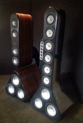

 Status Protos
Status Acoustics Titus 8T (left speaker) & Titus 2 (right speaker)
