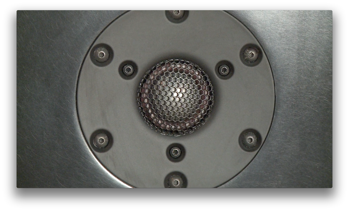

The beryllium tweeter is a Denmark-made Scan-Speak D6640 (or D3004/664000) that retails - just on its own - at $500 each. Compared to the equivalent fabric dome from the same company, the Beryllium version offers higher resolution and lower distortion. The Midrange cone is a blend of beryllium and aluminum. It's stiffer and lighter-weight than aluminum with a less pronounced breakup mode that is shifted further beyond the bandwidth of where it plays. This driver blends seamlessly with the tweeter.

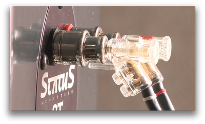

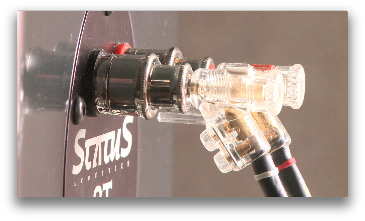

The melting pot of parts doesn't end there, however. The 16 WBT Platinum binding posts are made in Germany while the enclosures, grilles and brackets are made in Utah where the speaker is assembled and tested. The Status 8T Speaker system is internally wired with Kimber Kable 4TC. If you add up just the wire and binding posts, that’s over $2,600 for the speaker system!

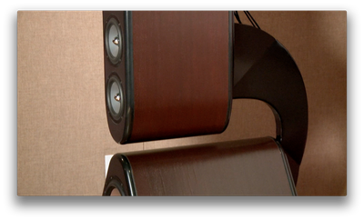

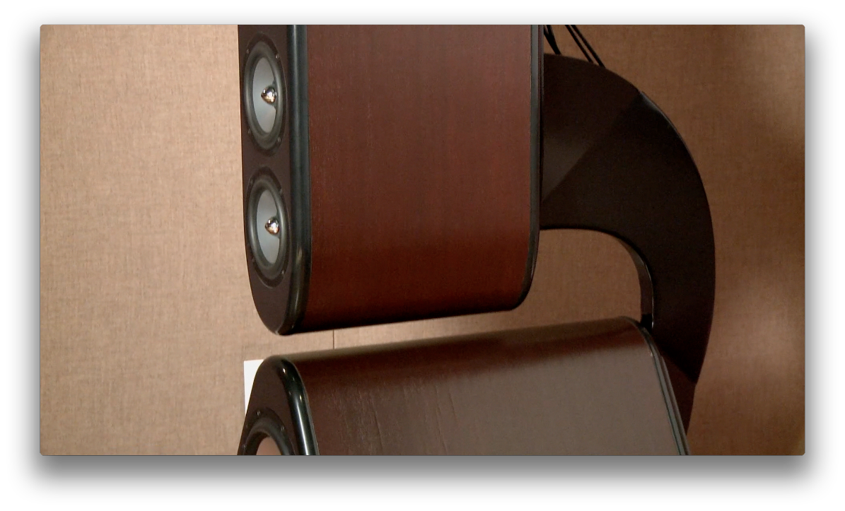

Before we talk any more about the build quality and components, it's good to know what the design goals of this speaker are. The Status 8T speaker system is made to produce true-to-life natural sound with realistic imaging characteristics and absolutely unrestricted dynamic range. The unique curved modular enclosure was made to deliver all of this performance in a relatively small, yet attractive visual profile - a tough order, given that the Status 8T's weigh 345 lbs. Each. The bass module weighs 175 lbs. and the satellites add 135 lbs. For those of you good at math, that leaves 35 lbs. unaccounted for. See that steel bracket that floats the mids and tweeter above the bass module? There you go...

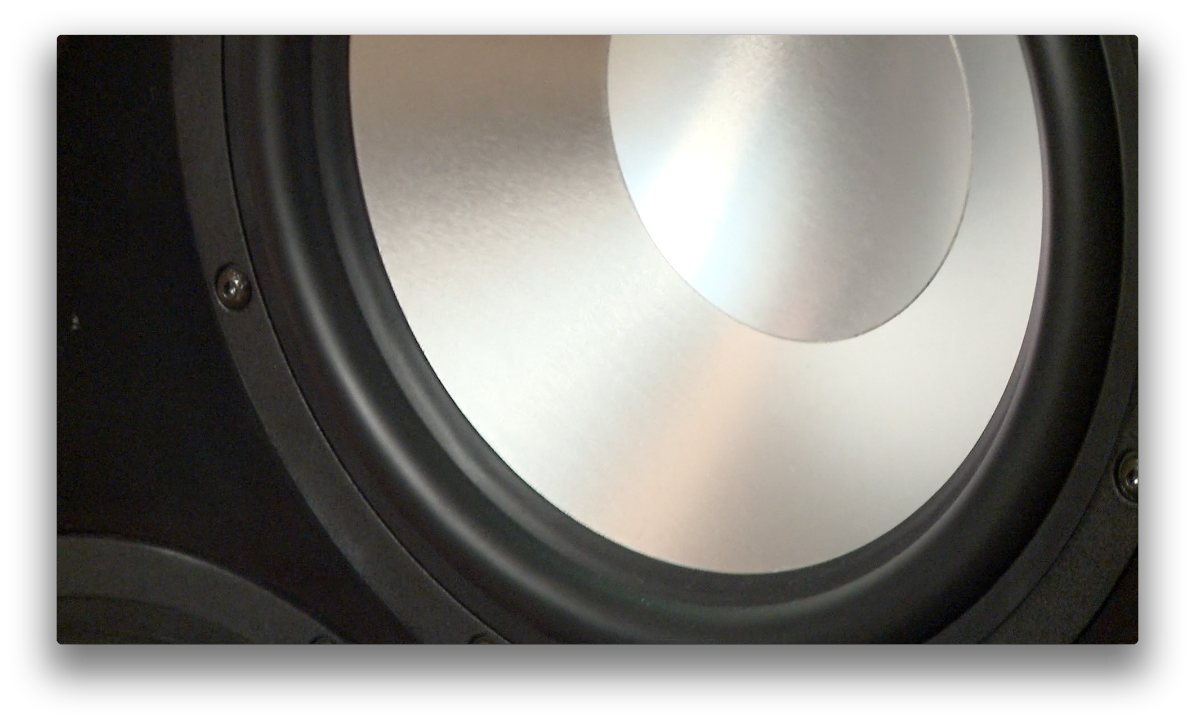

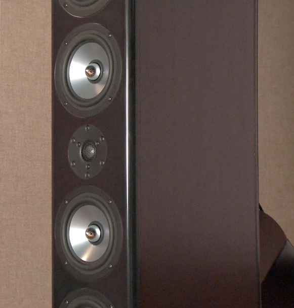

The inside of these speakers are even more impressive than the outside - if that's possible. Status Acoustics decided to use a vertical MTM pattern for the drivers  - and the two extra mid-woofers lower distortion, increase dynamic range, and produce a more palatable sense of realism. And each of the midrange drivers... they're isolated to eliminate standing waves in the chambers - a factor that is made even more possible by the absence of parallel walls inside the cavities.  The bass module sports three (3) 10" high excursion aluminum cone subwoofers with 3" voice coils and 12lb motor structures in a rear vented enclosure with dual 4" diameter dimpled ports.

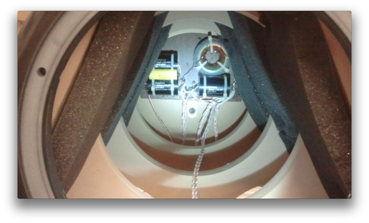

So inside - what you find is a cabinet construction process that bonds multiple layers of material together which is almost a completely backwards method of construction from what's typically done. It's also a lot more expensive - but it offers some advantages, like being able to vary the cabinet wall thickness at will and deliver additional bracing. And these cabinets are completely inert. Even the front and back cabinet baffles are unique - they are made of an acrylic polymer that, when combined with the HDF, has a higher acoustical dampening factor than wood.

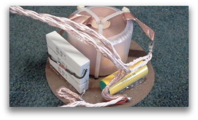

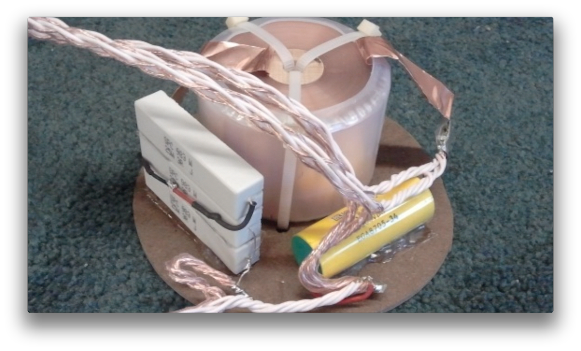

Also inside is the Status 8T crossover network which employs ultra high quality Jensen foil inductors, high voltage, tight tolerance Kimber and Solen polypropylene capacitors and a subwoofer inductor that is larger than the transformers found in most flagship A/V receivers. The Status 8T speaker system can be single, bi- and even tri-amplified. There are two connectors for the bass module and four connectors for the satellite module.

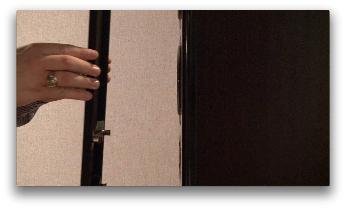

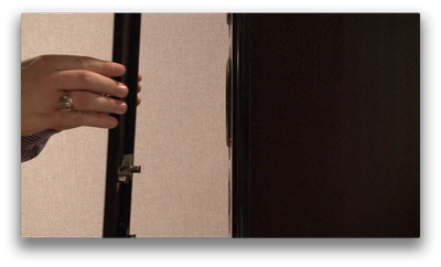

Outside of the cabinet we couldn't help but love the grilles of the 8T, which are constructed of HDF tightly covered with low loss grille material. Status used 24 high strength neodymium magnets which they integrated into the front baffles and grilles for each speaker. The grilles make a very firm and immediate connection that starts even when you're still a few inches away from the front baffle.
