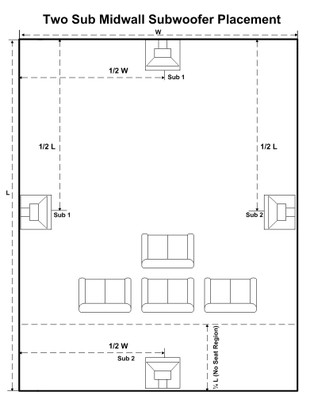

Figure 1a. Two Sub Midwall Placement
If you are running two subs, the ideal locations for them in a rectangular room are on opposing vertical or horizontal midwalls. Two subs configured in such a method work nearly as good as four subs configured via our 4 Corner Placement recommendation. You will however need to stack two subs for each location to achieve the same output as the 4 Corner Placement unless you chose two subs with twice the output capability of the four subs you were planning on using.

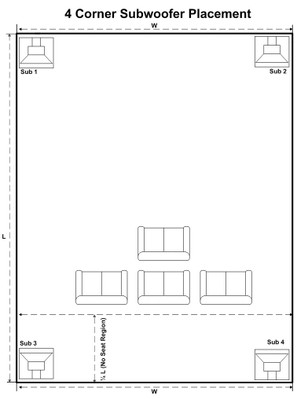

Figure 1b. 4 Corner Placement
In you are running four subs, the ideal locations for them in a rectangular room are the corners of the room.  Assuming all subs are identical, this will achieve up to 12dB of increased output when compared to a single corner loaded subwoofer. Placing the subs in all 4 corners will maximally reduce standing waves through destructive interference and provide the most linear and consistent frequency response for all seats.   Used in conjunction with global equalization, this option provides nearly as good frequency response and seat to seat variation as the midwall placement with the huge advantage in efficiency.  This can allow you to use smaller less powerful subs compared to the less efficient 4 midwall placement.

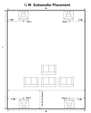

Figure 1c. 1/4 W Placement
Although this isn't spelled out in the CEA recommendation, Dr. Toole references it in his book as a good solution for two subwoofers but suggests additional subwoofers may be needed.  In my experience I've had excellent results placing two subs against the front wall at locations of 1/4 the room width.  I've had even better results placing two additional subs in a similar manner against the back wall.  This configuration can achieve nearly as good frequency response performance as the 4 Corner placement with nearly as much bass gain as well.
