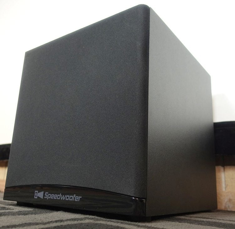

Unpacking and Appearance
The Speedwoofer 10S MKII arrived at my doorstep double boxed. Inside the boxing, there were polyethylene corner stand-offs to keep the sub cushioned from shock as well as giving it clearance from the box edges. The sub was wrapped in a soft plastic sheet that should protect it from moisture and scuffs. Altogether, the packing was good and should enable the sub to survive typically rough shipping practices.
Once

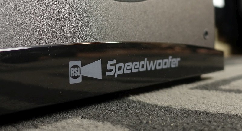

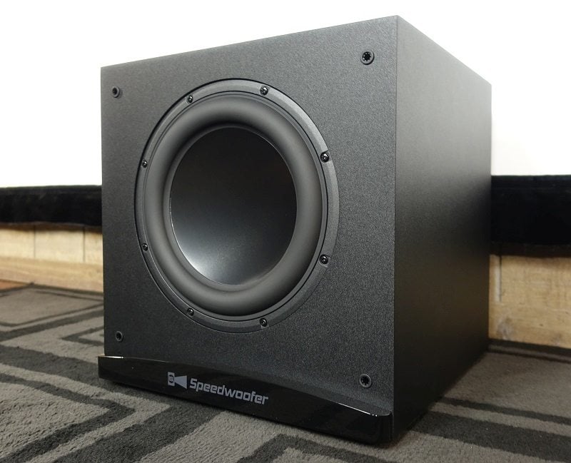

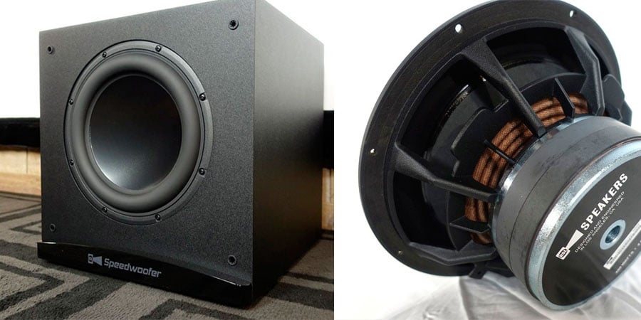

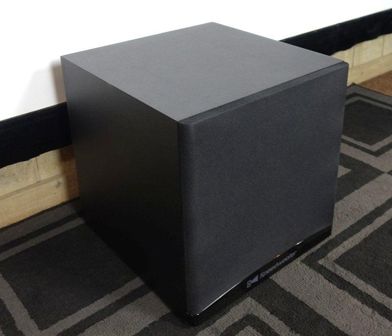

unpacked, the Speedwoofer 10S MKII turned out to be a fairly typical-looking
subwoofer and not bad at all. The finish is a lightly textured vinyl that we
see on many lower-cost speakers and subs that offers a slightly satiny
reflectivity but not quite as smooth. This nice thing about it is that it is
relatively durable compared to other finishes and it does not show
fingerprints. With the grille on, the Speedwoofer 10S MKII is not a terribly
remarkable unit, and the only distinguishing feature of it would be the lower
gloss piece with a curved upper lip that has the model name printed on it. Once
the grille is removed, we get a look at the cone, and it is a pretty
cool-looking anodized aluminum dustcap that is encircled with a beefy half-roll
surround. Aside from the neat-looking cone, the Speedwoofer 10S MKII is merely
an inoffensive black cube, and its smaller size should give it a pass in
situations where other household members might object to intrusive audio
equipment. It can also be had in white which will help it blend in lighter
decors. One thing that might have been done to help soften the appearance would
have been to round over the lengthwise edges, at least for the top of the sub.

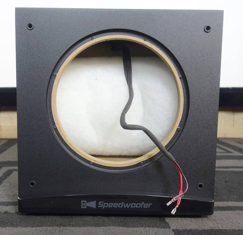

A quick glance at the Speedwoofer 10S MKII doesn’t really reveal what is unique about this sub; on the surface, it appears to be a typical subwoofer with a 10” cone. For a fuller understanding of the Speedwoofer 10S MKII, we have to dig a bit deeper. One of the unique features of the sub lies in its internal construction with the “Compression Guide Technology” which divides the interior space into three different chambers where the backwave pressure from the rear of the cone can compress and expand in a manner that reduces resonances. As I said in my review of the RSL CG5 & CG25, which also employs this design feature, it seems to borrow from transmission line theory which can get quite complex. Within the sub, there is a solid diagonal piece that stretches from the lower front of the enclosure to the upper rear, so there are two larger compartments in the enclosure. The upper rear of the sub is open so that the backwave goes over it into the lower compartment. There is an opening in the front of the lower compartment that opens up to a slot port that extends to the back of the sub. The larger chambers divided by the diagonal piece are filled with a thick batting material for damping internal waves.
I
couldn’t say how efficacious the Compression Guide Technology really is, but if
nothing else, it does add a good deal of rigidity to the sidewalls of the
cabinet. The MDF enclosure is already fairly well put together for its price
range with a 1” thick front baffle and ¾” thick sidewalls and braces as well as

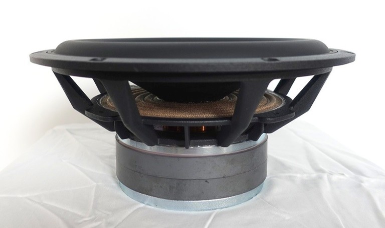

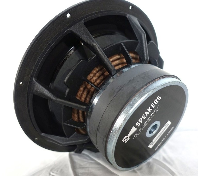

corner braces to reinforce the edges. It’s an unusually stout cabinet for the

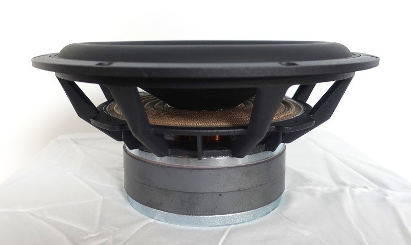

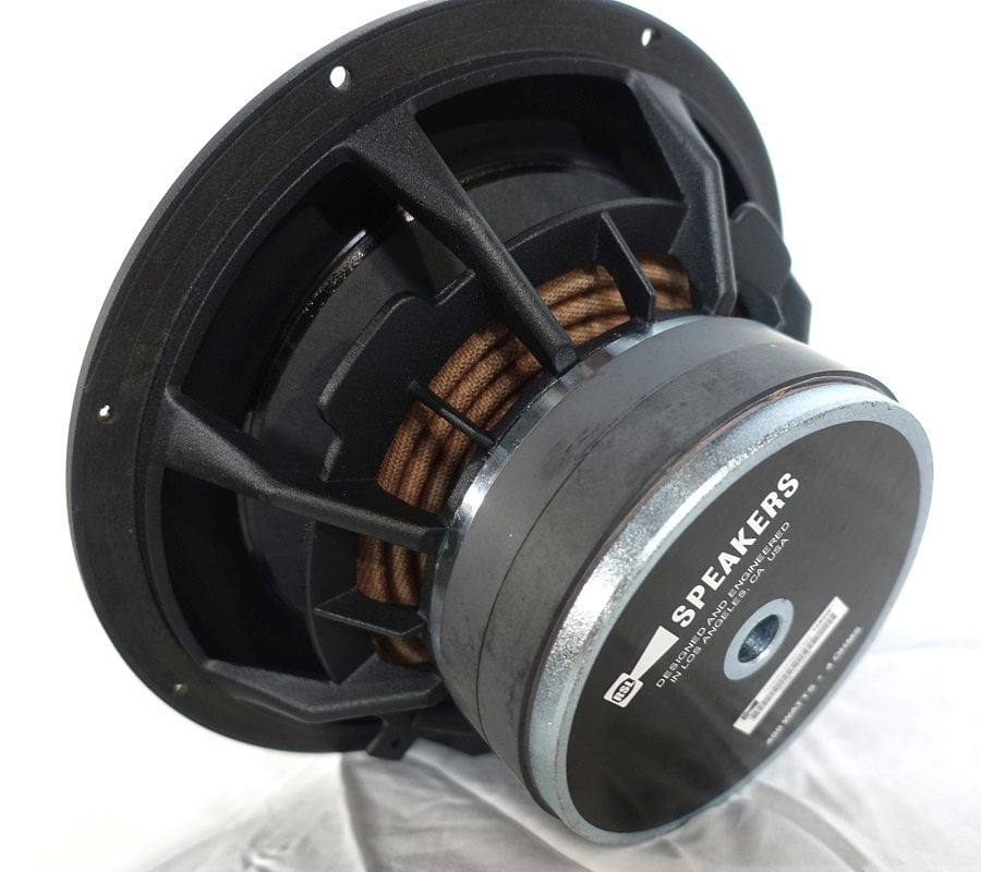

pricing. The driver is pretty beefy as well. It uses a Kevlar reinforced paper
cone with an anodized aluminum dustcap. It connects to a cast aluminum basket
via a Nitrile rubber surround and a Nomex spider. It has a 2” copper voice coil
set inside of a 1 ⅜” double stack of magnets that have a 5 ½” diameter. That
should provide a lot of magnetic flux for the coil to play with, but it does
depend on how powerful the magnets are which is not a published spec. Venting
is done both under the spider and through the pole piece.

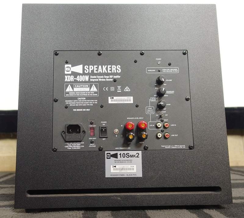

The driver is powered by a Class-D 400-watt RMS amp with a high-speed DSP processor that RSL calls the XDR amp (where XDR stands for “eXtended Dynamic Range”). Connectivity includes a left/right pair of RCA inputs and outputs as well as speaker-level inputs. It also has a built-in wireless receiver for RSL’s optional wireless transmitters that can be had for an additional $50. What is nice about RSL’s wireless transmitter is that it will work with multiple Speedwoofer 10S MKIIs simultaneously which is not something that Bluetooth-based transmitters can do. The amplifier provides two operating modes, Music Mode and LFE Mode. LFE Mode adds a bit more extension for some deeper bass whereas the Music Mode stays closer to the response of the original Speedwoofer. The DSP circuitry is a lot more feature-rich than the original’s non-DSP amplifier and includes advanced thermal management and protection schemes for fluctuations in voltage and DC conditions as well as having a lower noise floor and lower distortion output. On the amp panel, there are knobs for volume, phase, and low-pass filter (40-200Hz with 24/dB octave slopes), as well as an auto-on switch. The low-pass filter knob also controls the operating mode.
RSL Speedwoofer 10S MK II Rear View
The Speedwoofer 10S feet are fairly typical cylindrical rubber pieces that should do well at damping vibrations and not scratch any hard flooring. The grille is held in by normal grille guides and doesn’t seem like the type that would snap off easily. With grille on, the front of the sub has curved corners, so it won’t cut or jab anyone unfortunate enough to brush against it. Without the grille, all the edges are hard 90-degree turns. If the user has kids or pets, it would probably be best to use this unit with the grille on, not just to protect the cone but to protect against injury from anyone running into a hard edge.

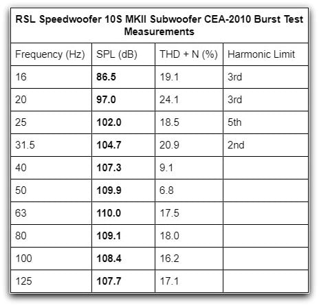

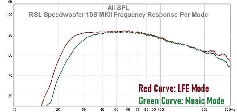

RSL Speakers Speedwoofer 10S MKII Measurements & Conclusion

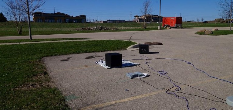

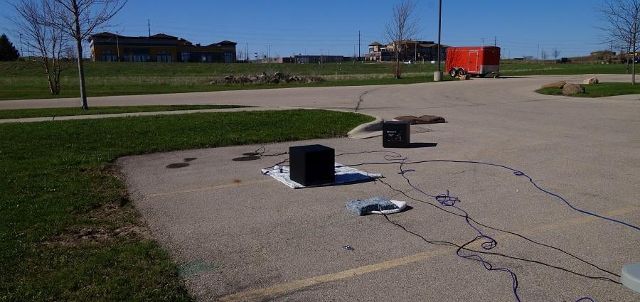

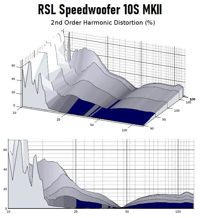

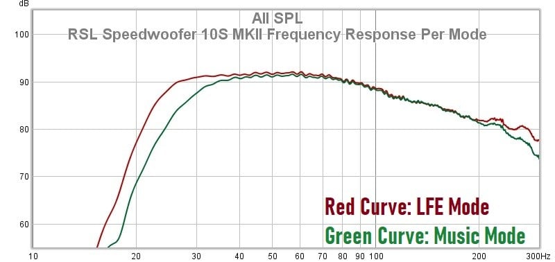

Testing on the RSL Speedwoofer 10S MKII was conducted with the microphone facing the woofer at a 2-meter distance. The temperature was recorded at 49F degrees with 70% humidity. The subwoofer’s gain was set to maximum and the low pass filters were left off.
The above graph shows the measured frequency responses for the RSL Speedwoofer 10S MKII subwoofer per its operating modes. The LFE Mode holds a nice flat response from the mid-20s up to 100Hz while the Music Mode rolls off the response at around 30Hz. I used the sub in LFE Mode for my own listening, and most people would probably find that more satisfying. The extra deep bass is noticeable. Above 100Hz, the upper-frequency roll-off is gradual, and it could probably be EQ’d for a flatter response without much trouble for those who want to use a 120Hz crossover. ‘Music Mode’ will have enough frequency bandwidth for the vast majority of music recordings. Music rarely dips below 30Hz, especially in acoustic recordings. RSL may have made this mode available for instances where room gain can really boost lower frequencies which is not an uncommon occurrence. There are plenty of movies that do dig below 30Hz, so for home theater aims, LFE Mode is recommended.
The above CEA-2010 measurements are
short-term bursts that show the subwoofer’s clean peak SPL before heavy
distortion sets in. Our measurements have been referenced to 2-meter RMS, which
is 9dB down from the standard requirement for the measurements to be shown at
1-meter peak. However most publicly available CEA-2010 measurements are shown
at 2-meter RMS, so we followed that convention. The burst performance is very
good for the price and size of the Speedwoofer 10S MKII. With short-term output
exceeding 107dB at 40Hz and above, it is no wonder that it could rock so hard
even in my medium-to-large room size. It has some real low-end grunt as well,
with a recorded measurement of 102dB at 25Hz. The overall measurement set here
nets our Bassaholic Room Rating on the higher end of the ‘Medium’ Room Size
Rating meaning that it should be able to remain powerful in a room of up to
3,000 cubic feet.
For information on how the room ratings are determined, please read our article Bassaholic Subwoofer Room Size Rating Protocol.

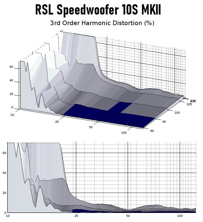

However, if you don’t intend to rock hard frequently, I do think it could handle somewhat larger room sizes at moderate loudness levels. On the other hand, a dual Speedwoofer 10S MKII setup could easily handle larger rooms and still come in at under $1k. Even better, a dual sub setup is better for reducing the adverse effect of room modes and standing waves, so you can get a flatter response and a higher quality sound than is possible with a single subwoofer.

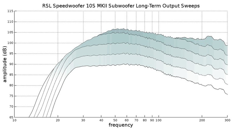

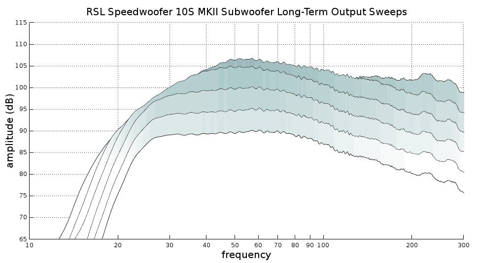

Testing for long-term output compression was done by first conducting a 20-second sweep tone where 50Hz hit 90dB with the subwoofer 2 meters from the microphone. We then conduct further 20-second sweeps by raising the gain by 5dB until no more output could be wrung out of the subwoofer. These tests show us the long-term continuous headroom that the subwoofer is capable of. The Speedwoofer 10S MKII holds its response shape up to the 100dB sweep before any compression sets in. Above that point, it does start to run out of gas in deep bass, but there is still plenty left in the tank in lower-mid bass where we see it can exceed 105dB from about 40Hz to 90Hz. Again, this is a very respectable showing, especially considering the size and pricing.

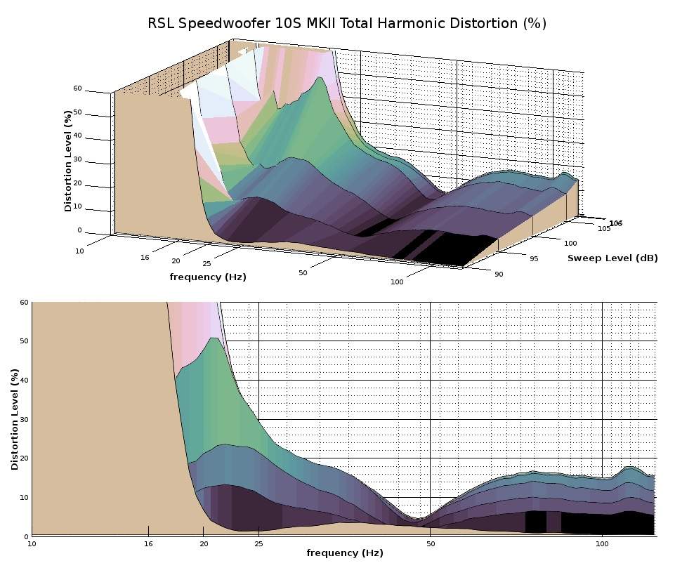

The above graphs show the corresponding total harmonic distortion to the long-term output graphs. Essentially, they depict how linear the subwoofer remains for the corresponding drive level seen in the long-term sweeps. The quantity being measured is how much of the subwoofer’s output is distortion and is shown here as a percentage. Starting at the 90dB sweep, there is very little distortion present. However, when pushed a bit harder, harmonic distortion does start to crop up, but not in quantities that are likely to be audible at anything but the highest drive levels, at least outside of deep bass. The nature of the distortion is what starts to matter at this point, and it is what we get a look at in the following graphs…
The above graphs depict measurements of the constituent harmonics from the long-term output sweeps and are what the total harmonic distortion measurements are composed of for the 2nd and 3rd harmonics. These individual harmonics can give us a clue as to what might be the cause of some quirk or non-linearity. We are only showing the 2nd and 3rd here because they more or less reflect the higher even-order and odd-order behaviors, although higher-order harmonics tend to be much further down as a percentage of distortion compared to the second and third.
Here we can see that most of the distortion product outside of deep bass below 25Hz is largely comprised of even-order harmonics. Since it seems to increase at fairly even intervals with respect to the rising drive level, I would guess this would be due to inductance rather than a suspension or motor issue. The fact that it is notched out just below 50hz would support this; were it a matter of stress from the suspension or motor, there wouldn’t be an absence of distortion at that frequency. The good news is that even-order harmonics are more difficult to perceive than odd-order, especially in music recordings. All musical instruments produce lots of even-order harmonics of their own, so if any even-order harmonic distortions are audible at all, the listener may not even be able to distinguish them from that of the instrument. The bottom line for these measurements is that if the listener doesn’t want to be met with any audible distortion products, just don’t crank the Speedwoofer 10S MKII as hard as humanly possible.

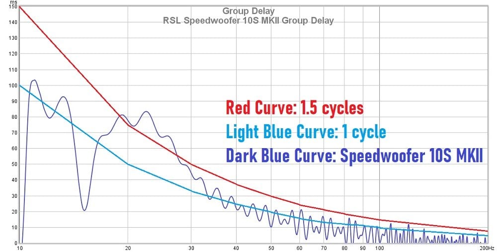

Group delay is the measurement of how much time it takes for individual frequency bands of an input signal to be produced by the speaker. It can indicate that some frequency components are developing slower than others or are taking longer to decay. It is generally thought that 1.5 sound cycles are needed for group delay to be audible at bass frequencies, although there is an argument that group delay should remain under 20ms to be completely unnoticeable, but that is likely meant for mid and upper bass frequencies.
The Speedwoofer 10S MKII seems to average group delay a bit below 1 cycle until port tuning which should keep it below any audible decay times for pretty much any content. It does exceed 1.5 cycles below 30Hz, but that is likely too deep in frequency to be readily perceptible by human hearing. There isn’t anything else remarkable about this measured performance; it isn’t extraordinarily good but it isn’t bad at all either. This is simply a competent level of group delay, and listeners are not likely to hear any laggy bass or overhang.
