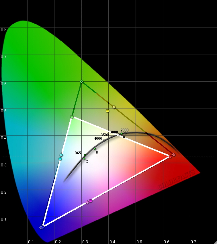

Mitsubishi LT46148 CIE Color ChartThe CIE color chart measurements for the Toshiba 46LX177 were not up to what we had been expecting, especially with its claim of xvColor support.  Red and blue are pretty much dead on, but green falls far short.  During my calibration I attempted to see if I could expand this performance utilizing the 6 color processor settings in the video menu.  Regardless of what changes I made, I could only shrink the triangle - never increase it to include more colors.

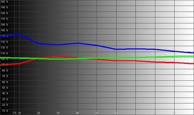

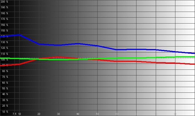

Other measurements were also a little disappointing during the bench tests.  The gray scale measurements shows RGB levels set heavy on the blue throughout the IRE range. Green stays pretty steady throughout the range, and red dip slightly from about 30 IRE throughout the rest of the range.
RGB levels

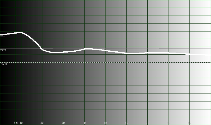

The temperature history shows it starting high (almost 7900K at 40 IRE) and gradually going down as you increase through the IRE scale - though it is always above the 6500K target throughout the range.

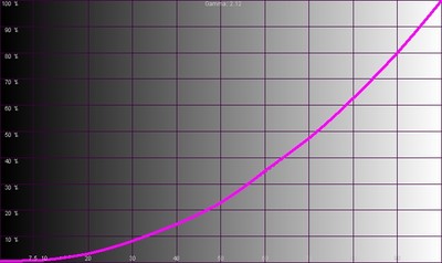

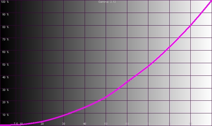

The gamma reading  (2.12) came in on the low end of the target range (of 2.2 to 2.5) but still at a pleasing level - very similar, in fact to how a CRT display performs (thought by some to be the model example for gamma). This smooth gamma curve produces a very even transition from bright to dark and makes for a very watchable picture that is carried out by real-world testing and viewing sessions.
Gamma
