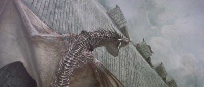

Comments on HQV Testing
There were few surprises with the results of the onboard HQV Realta video processing. The only question I had going in was how well the scaling would work since the native resolution of this monitor was so high. It turns out that my fears were unfounded – mostly. The patterns technically passed both jaggy tests as well as the flag test, however it was apparent that scaling to 1600p wasn't as smooth as many 1080p monitors I've seen. I utilized both 1:1 mode as well as Wide (we recommend 1:1 if you want the correct aspect ratios.) Those extra scaling steps to 1600p yield the occasional rough edge. The other anomaly involved Motion Adaptive Noise Reduction, which I know HQV's Realta is proficient at. We noticed some minor streaking in the picture and felt that we could quite give it a full score. I'd hesitate to assign a reason for this, but we wanted to note it.
