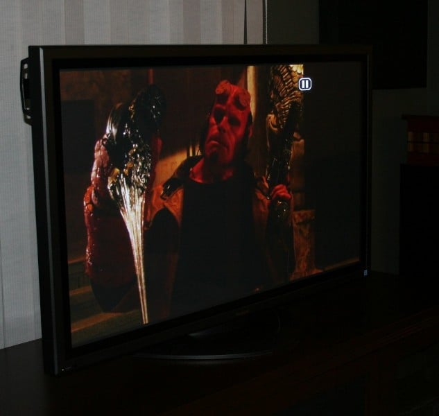

Front.The TH-50PF9UK shares the same chassis as the TH-50PH9UK and the TH-50PHD8UK. It is heavier than the PH9UK but it keeps the same styling. The small frame and lack of speakers really give this display that “window” look. The thin frame just disappears into the background and I’ve seen applications where people have actually installed picture frames over the edges of the display.
I’ve read reports of “hums” or noises associated with units in this line of Panasonics. The hum seems to be associated with the plasma screen itself while others have complained about the fan noise. Personally, I don’t see how anyone could complain about any noise from these displays. I specifically paid attention to any stray noises and noticed nothing. I sit about 8 feet away from a 50” display (far closer than I think most would). With the speakers off, and after hours of use, I could only hear noise when I place my head behind the unit. Even with my ear directly up to the screen, I heard next to nothing. If you are experiencing any stray noise, I’d first suggest you look at other sources. If you are sure it is coming from the display, consider placing some absorptive material behind the unit. It could be enhanced by reflections off the back wall.

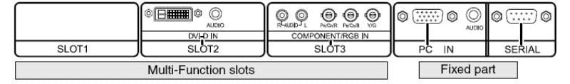

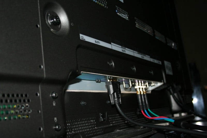

Interchangeable blades are a feature of this line of Panasonic industrial plasmas. With the 720p sets, they came standard with a component and some combination of s-video and composite inputs. If you wanted HDMI, you had to pay extra. With the TH-50PF9UK, you get a component and a DVI-D input. Now, since this display is really just a monitor – no pesky tuners or anything – trading in an s-video input for DVI-D is HUGE. For a HD display, s-video and composite are all but useless. Having two HD capable inputs will probably save many users from having to purchase a separate blade. With an HDMI to DVI cable, most any source can be used with the display – you just don’t get integrated audio.
inputs
Those of you using a computer (or HTPC) will be glad to know that you have access to a PC Input (15pinHD) that is 1080p capable. On top of this, there is an empty slot ripe to be filled with any blade you need (at an additional charge of course). While I personally would have preferred an HDMI input over the DVI-D, the display has no speakers and DVI-D has no appreciable picture quality difference from HDMI.

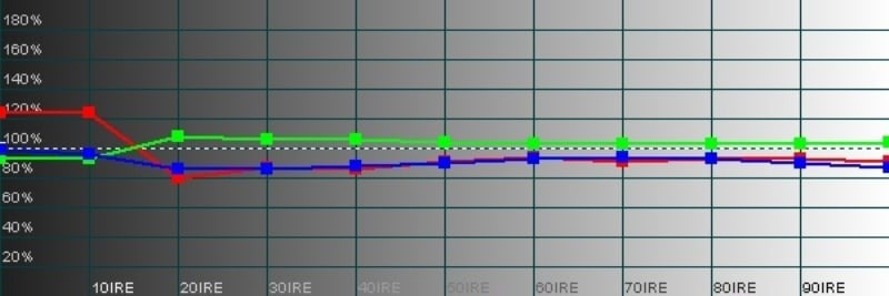

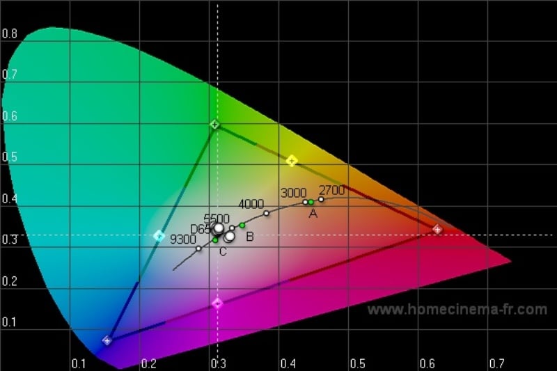

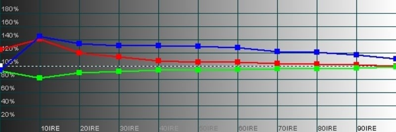

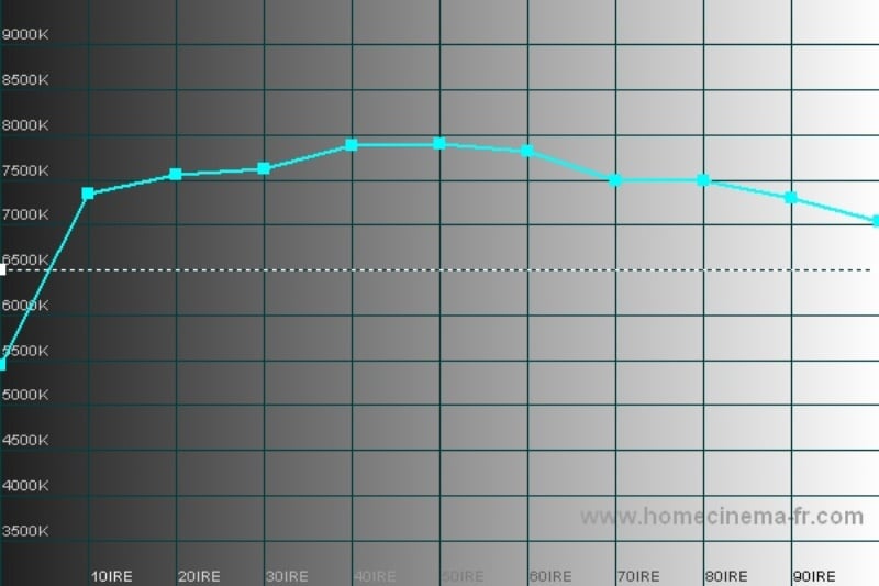

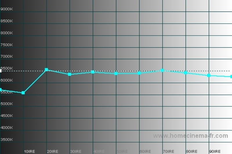

CIE_afterEven though this is a 1080p display, I was surprised and the similarities in the calibration to the 720p sets I’ve tested. Once again, blue was way too high and to a lesser degree, red. I’ve often been asked to give my calibration settings but honestly, that would be a bit misleading. I’ve calibrated both the inputs (component and DVI) on multiple sources and for every source it is a bit different. Suffice it to say that you most likely need to knock blue down a significant amount (on some inputs, I bottomed it out) and red about half as much. Even then, I couldn’t get the set dialed in perfectly. I used the Sencore ColorPro 5000 to calibrate the display but used the free program HCFR Colorimeter (which Jeff Lawson recently pointed out to us on our forums) along with the Spyder II meter from the datacolor SpyderTV PRO kit to generate the below graphs. If anything it pointed out that the two colorimeters were still tracking pretty closely together.
temp_b4
As you can clearly see, the display was running fairly hot out of the box (using the Standard setting) between 7500 and 8000k.
temp_after
After calibration we were much closer to the desired 6500k.
RBG_b4
Before calibration, it is obvious that the blue is very high with red a bit over the mark.
RBG_after
Here we see much better alignment between the primary colors.

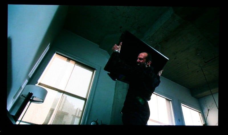

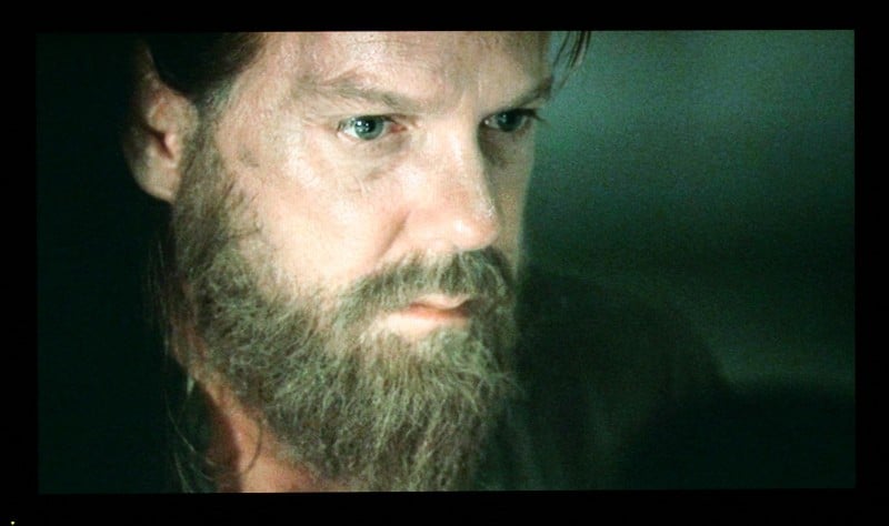

Crank

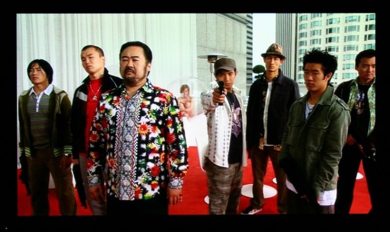

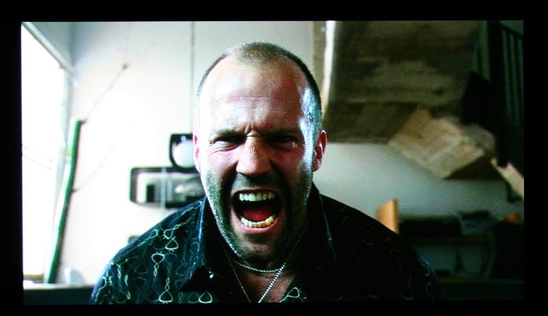

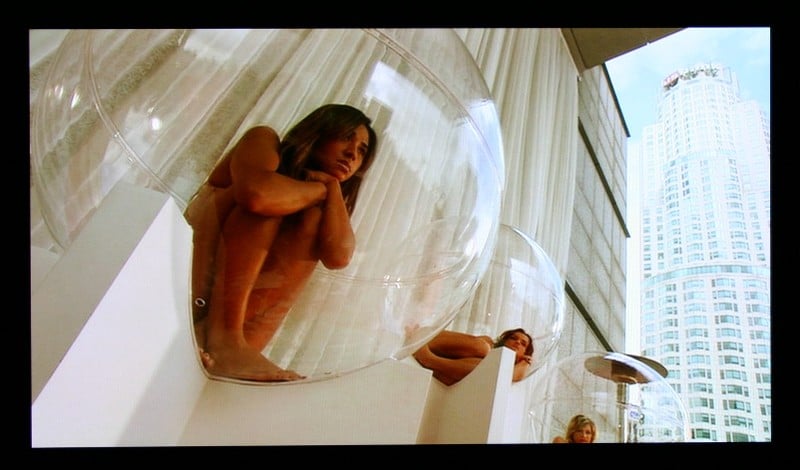

Jason Statham first crossed my path in Lock, Stock and Two Smoking Barrels. Of course he went on to star in the two Transporter movies as well. While his choice of scripts hasn’t been exactly to my liking, I have enjoyed his performances. When I saw the previews for Crank I immediately put it on my Netflix list. I was sure it would be a popcorn flick (all action, little substance), but I have a soft spot for such flicks. Hey I’m a guy.
As thin as the plot was (must have been from all the holes) the picture quality was really the most disappointing. The directors seemed to rely on MTV style Digital8 blurring action shots. I guess we’ve all got the Blair Witch Project to thank for that. The Panasonic TH-50PH9UK did the best it could with some mediocre material. The girlfriend’s dress, an impossibly colorful shirt at the end, plenty of textures… it all looked spectacular.
Crank1 Crank2
Crank3 Crank4

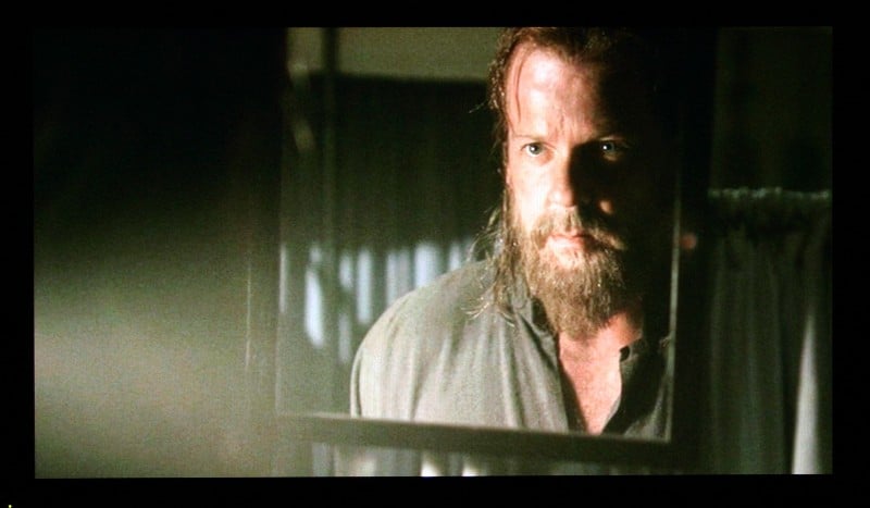

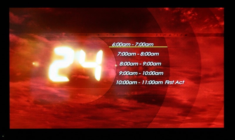

24: Season 6 Premiere
I couldn’t help but pick up this disc. For those of you living under a rock, 24 is arguably the best show on TV… perhaps ever. Never mind the neocon name-calling – that’s just a jealous competitor station’s way of getting some attention. Having two children (under the age of 4), I wasn’t exactly in the position to watch the 2 night, 4 hour premiere live (it started at 8pm, far too early for my young’uns). I DVR’ed it but I have standard cable. The picture quality is OK (once you get used to all the artifacts) but the sound really bites. Fox wants to make sure they give every possible person the chance to watch the hit show, so, in a marketing coup, they release the 4 hour premiere on DVD the week it was aired (TNT, USA, SciFi, and the like don’t do this, they just replay the same episodes over and over and over again for a weekend/week/ever). I was interested in the increased picture quality (of course) but mostly I wanted to enjoy 5.1 surround sound… Well, fat chance. Apparently they are saving surround sound for the official DVD release. This was in 2.1. Quite disappointed.
24_1     24_2
24_3
If nothing else, plasma’s do one thing well – blacks. The Panasonic TH-50PF9UK did not disappoint. 24 is full of vibrant colors, quick motion, and dark, dingy scenes. On all counts the TH-50PF9UK performed flawlessly. I so no evidence of macroblocking, banding, or other artifacts. Noise reduction is nowhere to be found, but with the right source, this will be reduced as well. I found myself transfixed by the clarity of the image. From 8 feet away, I could easily see pores, beads of sweat, and the amount of mascara they were wearing – and this from a standard definition DVD. During the outside scenes, I was particularly impressed with the color reproduction. Impossibly green grass, vibrant fabrics, and beautiful explosions kept you cognizant of this display’s abilities despite all the beiges and dark scenes. What was really funny was that I was watching the President watching his men on the same TV I was watching him on… Wait, I think I just sprained my brain.
