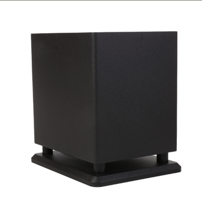

After lugging the XV15 into my theater room I was grateful that the port and base plate provided convenient hand holds for carrying. It is manageable by one guy but moving it would be a lot easier with two. At first judging from the pictures online that I had seen I assumed that the XV15 finish would be a very rough black finish similar to truck bed-liner. Very durable and tough but not very civilized. On that account I was wrong. The finish, which is described by Power Sound as a “sand” texture, is much better looking than I thought it would be. It is a dark, slate gray/black that has a very smooth texture similar to a fine grit sand paper and is almost satin in appearance. It looks much better in person than in the pictures. Don’t get me wrong this is no furniture grade finish that you will yearn to put on prominent display. This will be a large subwoofer to most and it is a basic, square, black object. But that said the finish is well applied, is of high quality and should disappear into a dark room easily.

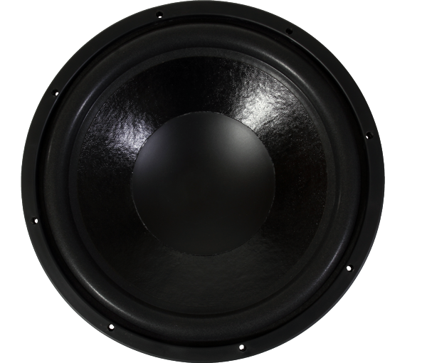

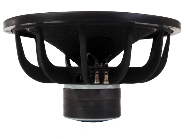

The 15” driver used in this system is constructed on a 12 spoke cast aluminum frame and uses a heavy pressed paper fiber cone with an inverted dust cap. The surround is a large half roll of Rubatek foam which should allow generous excursions. The voice coil is a 2” diameter copper flat wind with an 8” poly cotton spider providing centering and returning force. The motor is comprised of a triple stack of y35 grade magnets of about 5” diameter and a vented pole piece to remove heat from the gap. This driver appears to be sturdy, heavily built for a subwoofer selling in this price class and capable of withstanding large excursions. Power Sound indicates that the driver is capable of 2” peak to peak stroke.
Power Sound Audio XV15 Driver

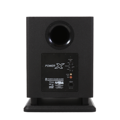

The amplifier of the XV-15 is a lightweight and efficient Class D BASH hybrid type that is said to combine the best of class AB and class D topologies and is rated at 500 watts rms and 1000 watts peak output. The amplifier is Energy Star compliant and in standby mode is said to consume only 1 watt. In use the amplifier seemed to be very efficient as claimed as it barely even got warm to the touch even while being subjected to high duty cycle test signals. The inputs provided consist of a pair of RCA style unbalanced connections with the left input marked as the LFE, and no outputs of any kind. Controls consist of the input sensitivity, phase, low pass filter and auto/on/off selector only. Additionally Power Sound mentions a laundry list of advanced protection and tuning circuits in this amplifier design: Thermal, DC offset, short circuit and load protections, plus driver current and voltage monitoring and advanced frequency specific compression.
Power Sound Audio XV-15 Back View
The XV15 enclosure is constructed of CNC cut 1” MDF panels and a 1.5” thick base plate. The lone finish available is a dark, fine textured black that is quite durable and resistant to smudges, scratches and fluids. The base plate attaches to the top section of the enclosure by 4 legs which have a bolt passing through them to tighten the pieces together. The port extends deeply into the enclosure interior to within a few inches from the opposite wall and is flush mounted as is the amplifier plate. The driver is not flush mounted but being under the enclosure and very seldom seen there really wouldn’t be much point to it anyway. Internally the enclosure is lined with what looks like fiberglass insulation. Unfortunately while the amplifier was removed and the interior of the enclosure was inspected I neglected to actually take any pictures! The XV15 never showed any signs of enclosure panel vibration, rocking or any noises related to internal resonances or vibration when probed with high power test signals outdoors. It was inert throughout. The XV15 is a very solidly constructed subwoofer as evidenced by the 92lb weight and the components are all of excellent quality for this price range. I am a bit baffled by how Power Sound has managed to assemble this subwoofer in the U.S. with primarily U.S. components and managed to ship the 92lb sucker all for $799 while still making some sort of profit for themselves.
