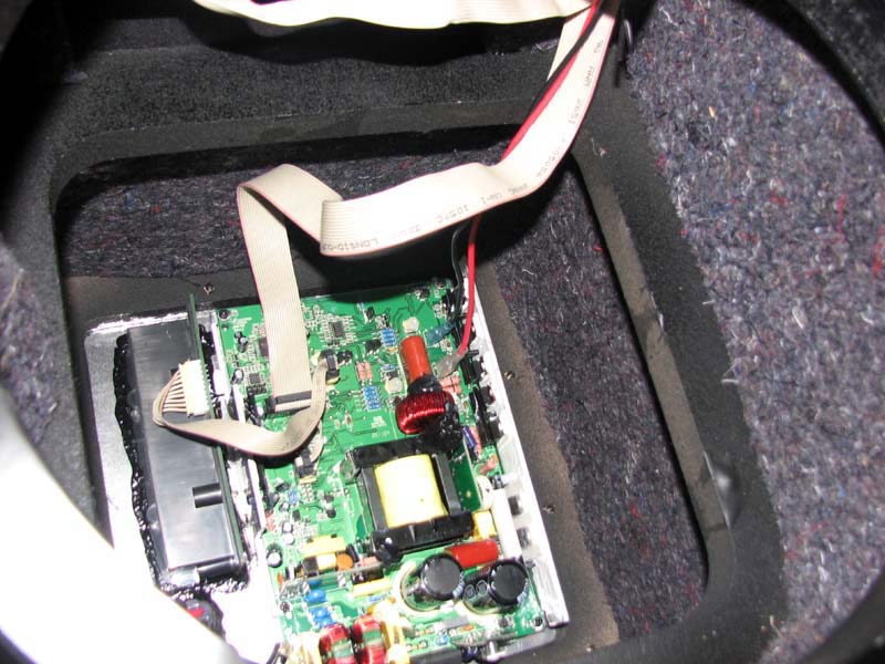

We were impressed with the Ultra Series subwoofer's build quality when we reviewed the Ultra 12, so we expected nothing less of Emotiva with their new X-Ref 10 subwoofer.  The X-Ref 10 uses a high efficiency 300 watt (continuous rated) power amplifier with high current switch mode power supply. It appears to be a clean design just as we’ve come to expect from a company specializing in quality, yet affordable, amplification.

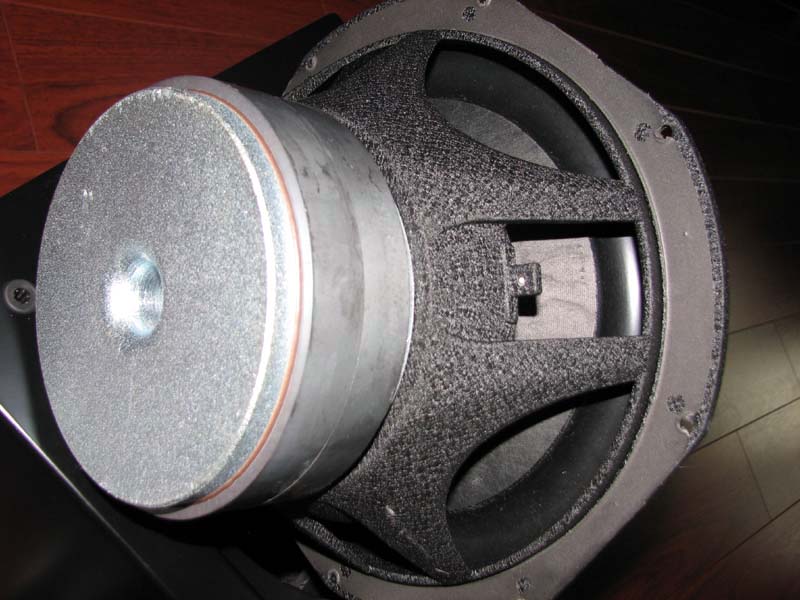

The 10” driver is a high mass paper cone which Emotiva calls a “proprietary para-aramid blended fiber" cone.  It sports a 2” voice coil and a large dust cap and 1” butyl rubber surround to help it reach long excursions.  The driver frame is constructed of a rigid die-cast basket with a vented motor assembly and tinsel leads to reduce mechanical distortions.  I measured the effective cone area to be around 8” and the rubber surround to be about 1”.  These are pretty standard dimensions for a heavy duty 10” cone.
Like the Ultra series driver, the X-Ref driver employs tinsel leads to help eliminate the worry of lead slapping against the driver during high excursion, while also proving more travel.  Looking at this baby out of the box is like a work of art.  We’ve seen subwoofer drivers from competing products costing 3-4 times the price that employed generic stamped frames and conventional cone geometries.  Emotiva has obviously invested much of the budget in this product into the actual parts.

Tinside_boxhe cabinet appears to have a 1” thick front baffle and ¾” side panels with very ample bracing and acoustical dampening materials batting the sidewalls.  The bracing is even rounded off on the interior corners providing additional reinforcement. The rounded braces are a nice touch and you can tell that Emotiva has a pride in workmanship that you don't always see with subwoofer manufacturers.  The knock test all around proved this sub had a very inert enclosure.  The woofer is flush mounted with 8 threaded screws and inserts rather than just bare MDF for a more snug and reliable fit.

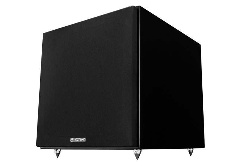

The Ultra X-Ref 10 is essentially a compact 13" cube and weighs 33lbs. It has usable in-room extension down in the 30Hz range and Emotiva specs typical in-room output at about 112-115dB which we will elaborate on in the measurements section of this review.

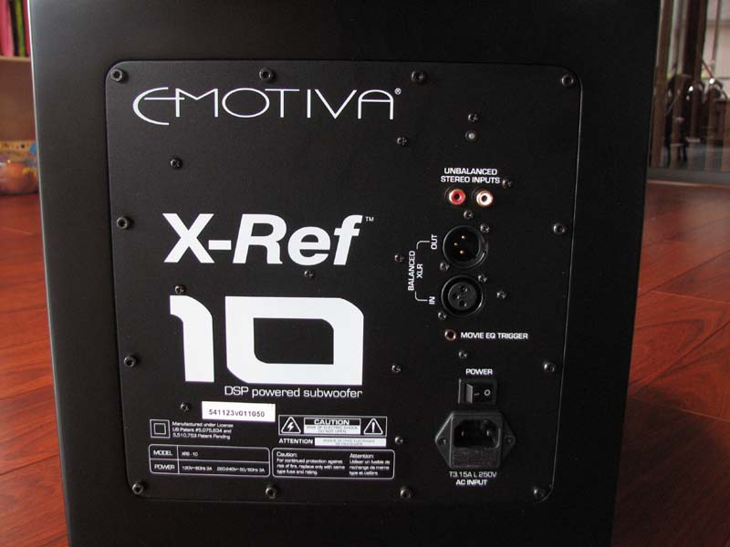

On the back you've got both balanced (a rare find on any consumer subs, especially at this price) and unbalanced inputs and one balanced output to daisy chain more X-Ref subs. A trigger input and power toggle on/off and a detachable power receptacle are the only other interfaces on the back panel of the X-Ref 10.
There is no “auto” setting for power.  The unit simply goes into standby mode after about 10 minutes of inactivity.  You can observe this by the color change of the back panel LED which is green when the sub is active and red when it’s in standby mode.
Make sure you make all of your connections with the subwoofer turned off to avoid a loud humming sound when connecting the line level inputs if the sub is not in standby mode.

About the only thing you won't be able to do with this subwoofer is feed it speaker level inputs or use it to crossover full-range frequencies to a pair of satellite speakers (there are no speaker level inputs or outputs whatsoever). With a modern AV receiver this shouldn't be a problem, but if you have a lower-tech integrated amplifier or a true legacy system or audiophile rig, you may need to look into an external crossover.
