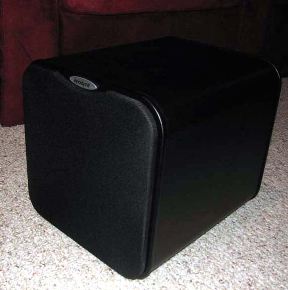

The Velodyne MiniVee, like most upper echelon Velodyne products cabinet features beautiful radiused edges. The driver is internally mounted with no visible mounting screws and recessed into the baffle. The black cloth grille sits flush on the front baffle with a cutout displaying the Velodyne badge top and center. The MiniVee sports 4 rubber mounting feet with no provisions for carpet spikes.
The MiniVee comes in only one finish option which is a dullish black.  It certainly lacks the charm of a real wood veneer, but given its small footprint and ease to blend into any nook or cranny of a room, it can easily be tucked away to be "heard but not seen" as my late uncle used to say about children, or was it the other way around?  Hmm...

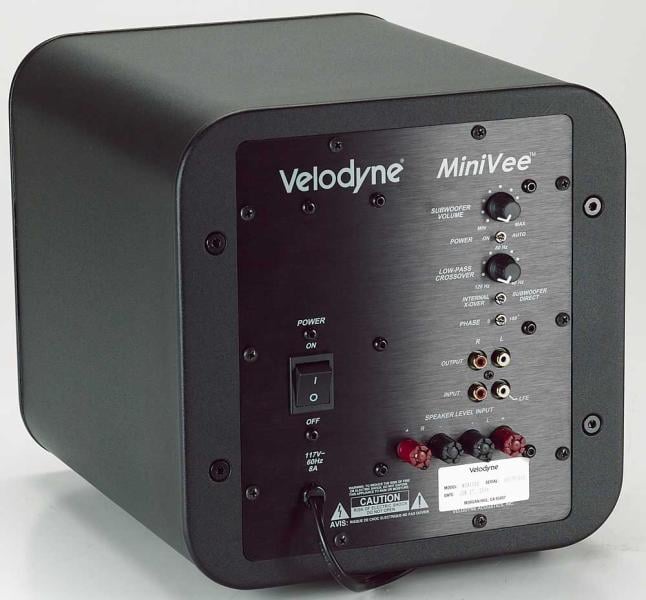

The rear of the unit is home to the typical mounting plate for the amplifier and controls you find on most powered subwoofer products. To the left side is a large rocker styled master power switch and a non-detachable power cord.  It's kinda a bummer Velodyne didn't make the power cord detachable.   To the right side of the plate amp are all the controls and inputs. These controls include two knobs allowing continuously variable settings for volume and the low pass crossover frequency. There are toggle switches for activating the auto on/off feature, the internal crossover, and setting the subwoofer phase between 0 and 180 degrees. Below the controls are two pairs of gold plated RCA connections for line level input and output as well as two pairs of five way binding posts for speaker level input.  There are no speaker level outputs. For those analog two-channel buffs wanting to apply bass management to their satellite speakers, you will need to do so via other means.
The internal crossover system for signal input is adjustable from 40 to 120 Hz and uses staged for low pass filtering that accordingdriver.jpg to Velodyne varies between 12 dB/octave at the crossover frequency to 48dB/octave above the crossover frequency. The line level output is fixed at 80Hz with a 6dB/octave slope

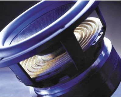

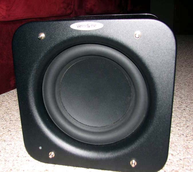

The driver used in the Photon-8 has an 8 inch outside diameter with an actually 6.5 inch effective piston diameter. The cone itself is a composite resin that is reinforced with Kevlar fibers and is mounted to the frame with an oversized EPDM rubber surround while the internal suspension is said to use an oversized spider, both to accommodate high excursion but retain linearity.
The motor structure on the back of that cone is also appreciably oversized. The magnet structure weighs in at 204 oz (12.7 lbs) that effectively constitutes fully 1/3 of the entire subwoofer system's weight and weighs more than some comparably sized subwoofer systems. In between the cone and that magnet is a high temperature, 2.5” diameter, dual wound coil. Coupled with a cast aluminum basket frame and we have the makings of what should prove to be a very potent little driver.

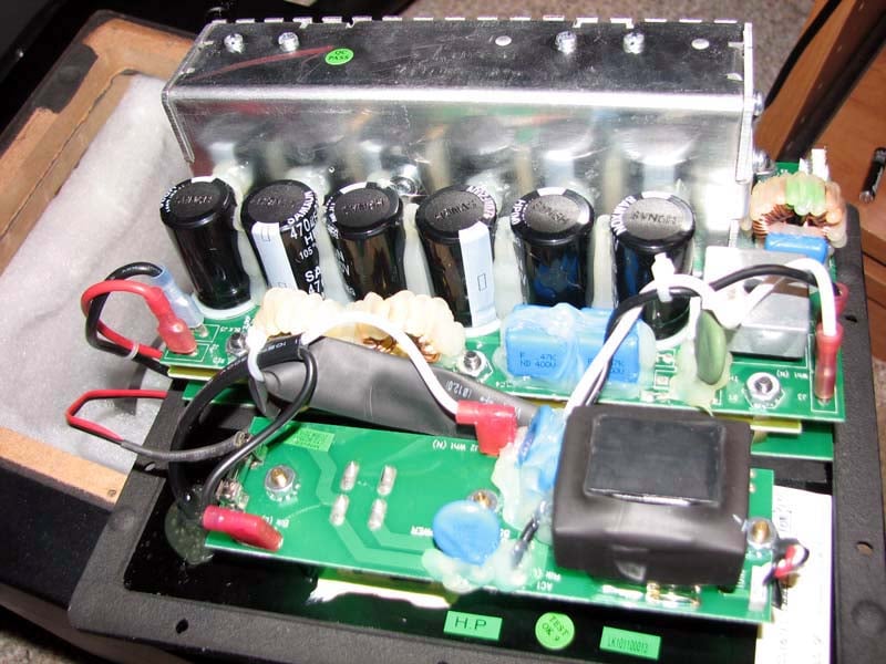

The Velodyne MiniVee also boasts a digitally controlled class D amplifier (up to 95% claimed efficiency at full load) section that is said to deliver 1000 watts rms power Velo 006001.jpgand 2000 watts dynamic power.  The amplifier, which is separated into two sections, occupies the entire back plate. One board dedicated to the power supply supporting the transformer and main fuses. The second tiered board supports the preamp functions and six 470 microFarad, 200 V power supply capacitors. There is a small heat sink to the side of the capacitors while the majority of the circuitry lives under a grilled metal housing to reduce radiated RFI noise inherent in high frequency switching amp designs. Based on the power consumption rating of 8 amperes listed on the back of the unit at the standard 120 volts we get a power rating of P = 0.95(8A * 120V) = 912 watts which is close enough to the 1000 watt rating that with a slo-blow fuse leaves little to suspect the rated power of the amplifier.
Both the amplifier and driver feature overload protection circuitry. The driver is digitally controlled with a current limiting driver servo to limit distortion by prevent clipping and over excursion. The amplifier section has thermal protection as well as protection against excessive voltage drops.  As you will see in our measurements section, this little sub is unbreakable.

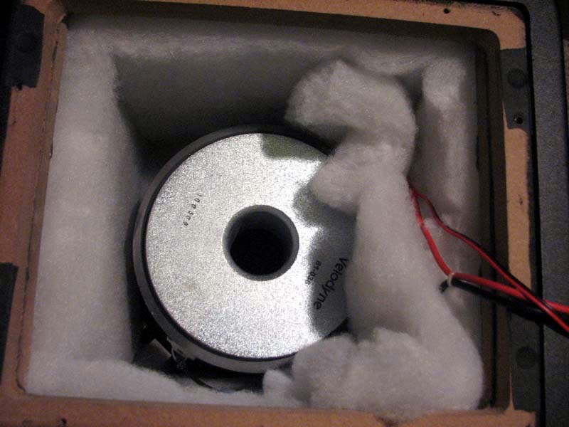

Disassembly of the MiniVee to reveal the internals can only (safely) occur through the rear amplifier plate, which is secured with 10 wood screws around the perimeter. Inside the cabinet, fiber batting is wrapped around the outside faces of the cube and a second piece separates the driver from the electronics mounted to the back. The cabinet itself is constructed of 1/2” MDF with glued joints and triangular wedges used to reinforce the outside corners.  The driver is secured down with metal clamps.  It's obvious Velodyne designed this sub to be rattle-free at even the highest power levels.

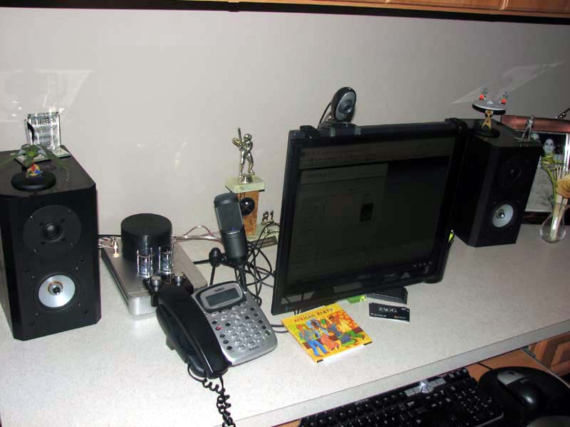

MiniVee SetupI tried the MiniVee in several locations in my office, but found it blended best with my speakers when placed on the floor below the left speaker and flush to my desk.  I tried placing it under my desktop by my feet but it produced such a large tactile response that it seemed artificial when listening to bass-intense music.  The MiniVee was connected to my EMP VT40.2 Hybrid Tube Amp Speaker System via speaker level paralleled to the 41-SE/B speakers.  I found the line level outputs of the VT-40.2 amp to be about 10dB too hot for this sub which caused it to reach excessively high output when the volume control on the sub was set any higher than a finger nail thickness from zero.  A more graduated level adjustment would have been appreciated.  I was unable to make coarse level adjustments using the volume control because the sub reached a high gain state with the volume barely turned a few clicks past minimum regardless of what source device I connected to it.  When using speaker level connections to my EMP VT40.2, I still only needed to set the master volume of the MiniVee just below 1/3 up from zero to reach the right output level for my listening setup.  The volume control was quite finicky and I wished Velodyne would have instead employed a stepped potentiometer so you could lock your setting in place without fear of being blown off your chair because the volume control got accidentally bumped higher when you were moving the sub to do some spring cleaning.
Because of the premature rolloff above 70Hz of the MiniVee, I found running it full-range with no bass management worked best in my situation.  The added output in the 70-100Hz region running the sub full-range really helped to provide the much needed bass fill for my desktop speakers.

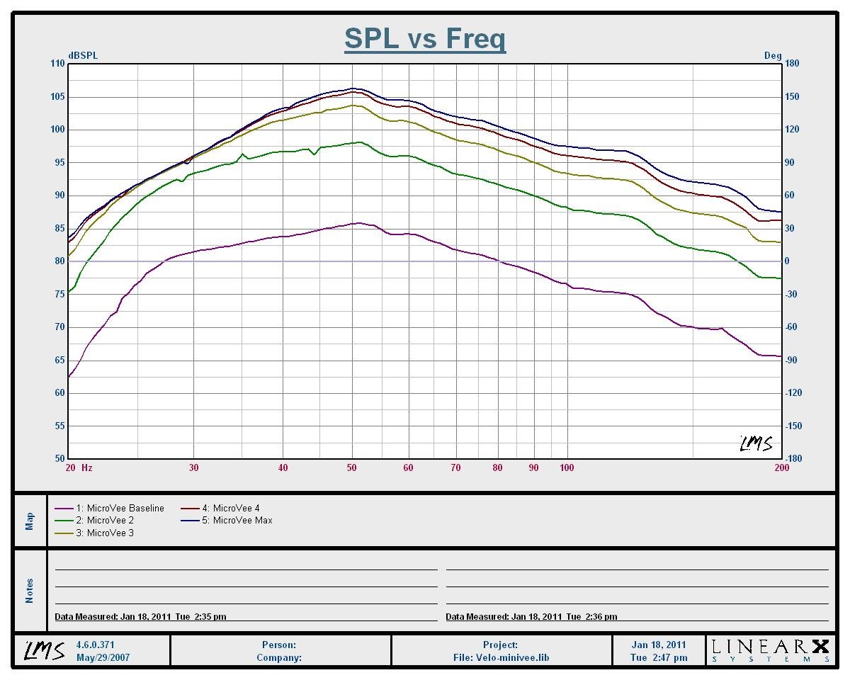

I measured the MiniVee at various output levels using the groundplane technique at 3 inches from the front driver.  The output was scaled -19dB down to give the actual SPL output I could hear at my listening position which was roughly 4 feet away.  The subs highest output is centered around 50Hz but rolls off significantly below 30Hz where there is a deliberate HPF employed to protect the drive unit and keep things from getting ugly.  I was a bit surprised to see about 5dB of rolloff at 80Hz even with the subs internal crossover bypassed.  I could only surmise that the inductance of the large voice coil and heavy cone of this smallish driver was contributing to this phenomenon.  It certainly explains why I opted to use no bass management at all on this sub when mating it with my EMP 41-SE/B desktop speakers.
Unlike the MicroVee that drops off like a rock below 50Hz, the MiniVee has about a 10Hz true usable extension advantage.  I was able to hit 106dB SPL at my listening seat with this potent little sub which was about 5dB more output than I measured on the MicroVee at 50Hz and whole lot more below 50Hz as you will see in my comparative measurements below.  Velodyne claims the -3dB point of the MiniVee is 28Hz.  Because of the bump at 50Hz, it’s a bit hard to give an exact figure here.  I would say its more like 30-32Hz.  At high SPL however where the sub compresses and the limiter kicks in, we see a 38Hz -3dB point with about an 18dB/Oct roll off.  This is very respectable performance for a product smaller than a shoebox.

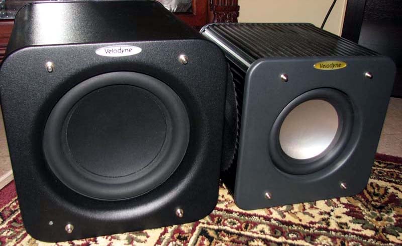

I found it to be revealing to compare the output of the Velodyne MiniVee to the smaller but more expensive MicroVee model.  I tested both subs identically using in-room nearfield groundplane scaled to the listening position 4ft away.
Velodyne MicroVee Velodyne MiniVee
Drivers 6.5" active, (2) 6.5" passive 8" driver
Dimensional  Box Vol .45 ft^3 .77 ft^3
MSRP $799 $749

As you can see the MiniVee pwnes the MicroVee below 60Hz with a whopping 24dB output advantage at 20Hz.  Only above 70Hz does the MicroVee exhibit appreciable (+3dB) more output than the MiniVee.  The MiniVee is just a whole lot more sub than the MicroVee but it's also almost twice the size.

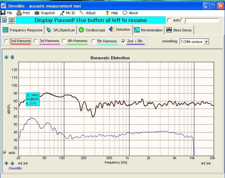

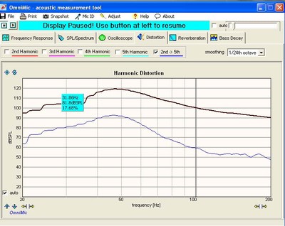

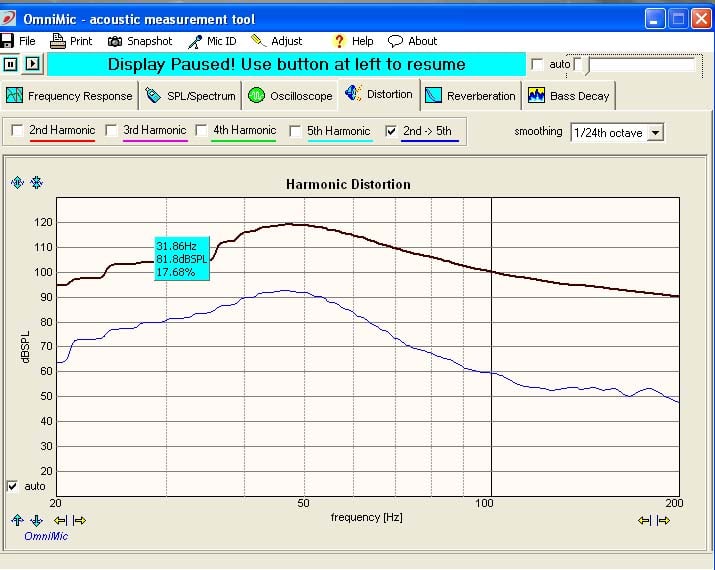

Velodyne MiniVee Distortion @ Max Output

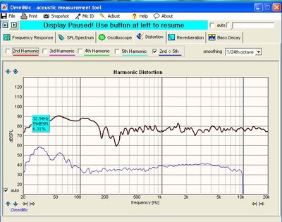

At moderate listening levels which would equate to about (81dB @ 40Hz) at my listening position, I measured under 1% distortion below 60Hz on the MiniVee.  It wasn't until I ran the sub to its max output that you could see distortion rise appreciably.  At 31Hz max usable output, I measured 17.68% which is actually quite excellent for a subwoofer driver.  Distortion below 30Hz dropped thanks to the HPF system limiter doing what its supposed to do to protect the driver and ensure you can't hear any audible distress.
I measured distortion of the Velodyne MiniVee sub used in conjunction with my EMP 41-SE/B bookshelf speakers as you can see below.
Velodyne MiniVee + Speakers System Distortion vs Frequency
If you subtract the frequency response curve (brown) from the distortion curve (blue), you can calculate THD +N. using the table below:
dB Below Test Tone % Distortion
-5 dB 56.2%
-10 dB 31.6%
-15 dB 17.8%
-20 dB 10.0%
-25 dB 5.62%
-30 dB 3.16%
-35 dB 1.78%
-40 dB 1.00%
-45 dB .562%
-50 dB .316%
-55 dB .178%
-60 dB .100%
So in our case, above 200Hz we see 80dB SPL level - 40dB distortion level yielding 1% THD + N.  The overall distortion profile of this system from 20Hz to 20kHz is quite excellent which explains why I enjoy listening to my desktop system often moreso than any other system in my home.  It plays plenty loud and clean with great bass extension thanks to the MiniVee.  What else could anyone want from a desktop system?

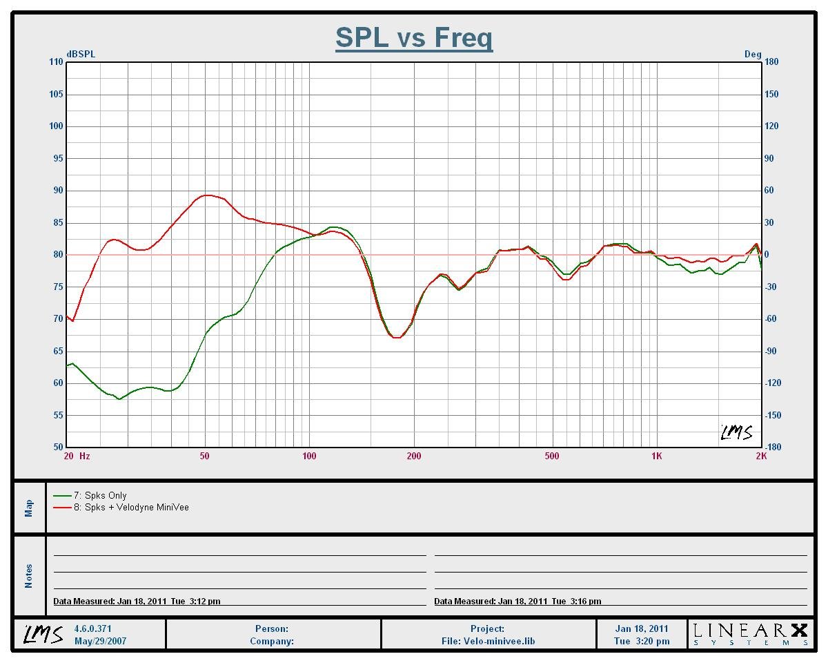

Velodyne MiniVee + EMP 41-SE/B In-Room System Frequency Response
Green Trace: 41-SE/B; Red Trace: MiniVee + 41-SE/B
As you can see in the measurement above, my little EMP 41-SE/B speakers don't have much usable bass below 80Hz.  Adding the Velodyne MiniVee into the picture was like giving that system a shot of Red Bull.  With the MiniVee playing in my little office, I had true mid 20Hz extension at my listening seat.
