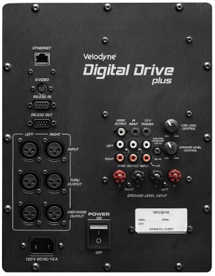

Velodyne DD-15+ Specifications
- Driver: 15” forward-firing
- Amplifier (ClassD): 3000 watts Dynamic, 1250 watts RMS Power
- Frequency Response: Overall 9.0 – 300 Hz (+/- 3 dB) 14.6 – 120 Hz
- THD: <0.5% (typical)
- High Pass Xover: 80 or 100 Hz at 6 dB/octave
- Low Pass Xover: 40 Hz to 199 Hz (variable in 1 Hz crossover increments) selectable slope Default: 80 Hz @ 24 dB/Octave
- Phase: 0 to 180 degrees (variable in 15 degree increments)
- Polarity Adjustable: (+/-)
- Magnet Structure: 39.7 lbs.
- Voice Coil: Six-layer, 75mm
- Cone: Fiberglass Rohacell Laminate
Inputs/Outputs
- LFE (Mono) Line level (RCA), Nominal Impedance 47K,
- Balanced (XLR), Nominal Impedance 10K
- Input (L&R) Line level (RCA & XLR)
- Microphone Balanced (Mini-XLR, cable included)
- Speaker Bare wire, banana plugs, or spade lugs Level (L&R)
- Thru (L&R) Line level (RCA & XLR) outputs
- Output (L&R), High-Pass Line level (RCA & XLR)
- Included Full feature remote control, DD+ accessory Accessories kit and video cable
- Finishes: Black gloss ebony, satin cherry or walnut
Physical
- Dimensions (H/W/D): 20” x 18.1” x 22.5” (includes feet (51 x 46 x 57 cm) and connectors)
- Shipping Weight: 120 lbs.(approx)
- Warranty: Three years (electronics) / (parts/labor) Five years (drivers)
- Superb performance in a moderate box size
- Excellent aesthetics
- Tons of configurability options to ease installation
- Pricey

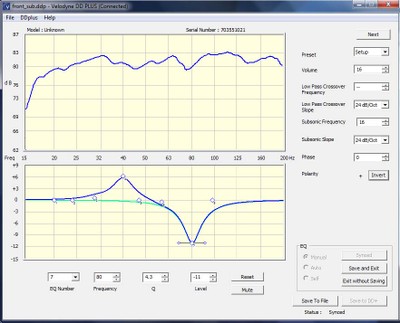

- Coarse resolution of included setup software limits its usefulness
